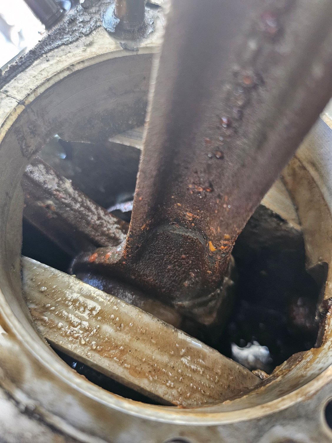

I'm soaking the pistons in PB Blaster overnight before I attempt removal. If they don't come off fairly easily, which I expect they won't, I will have to resort to stronger potions. I seem to recall a mixture of ATF and something else works well. Anyone know the other ingredient?
ATF & Acetone. I believe the ratio is 1 to 1.

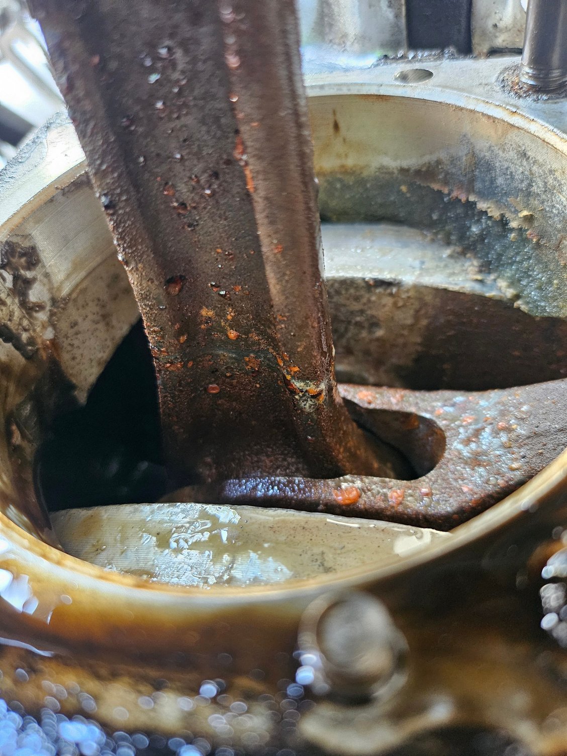

PB Blaster wasn't enough. I pounded the edges of the pistons and they didn't move, except to dislodge the jugs from the case. I wish I had my oxy/acetylene setup here, I would put a ton of heat to the pistons to break them free.
I don't think this crankset is worth saving, the bearings are probably rusty. But 80" EVO stuff is pretty cheap, I think.

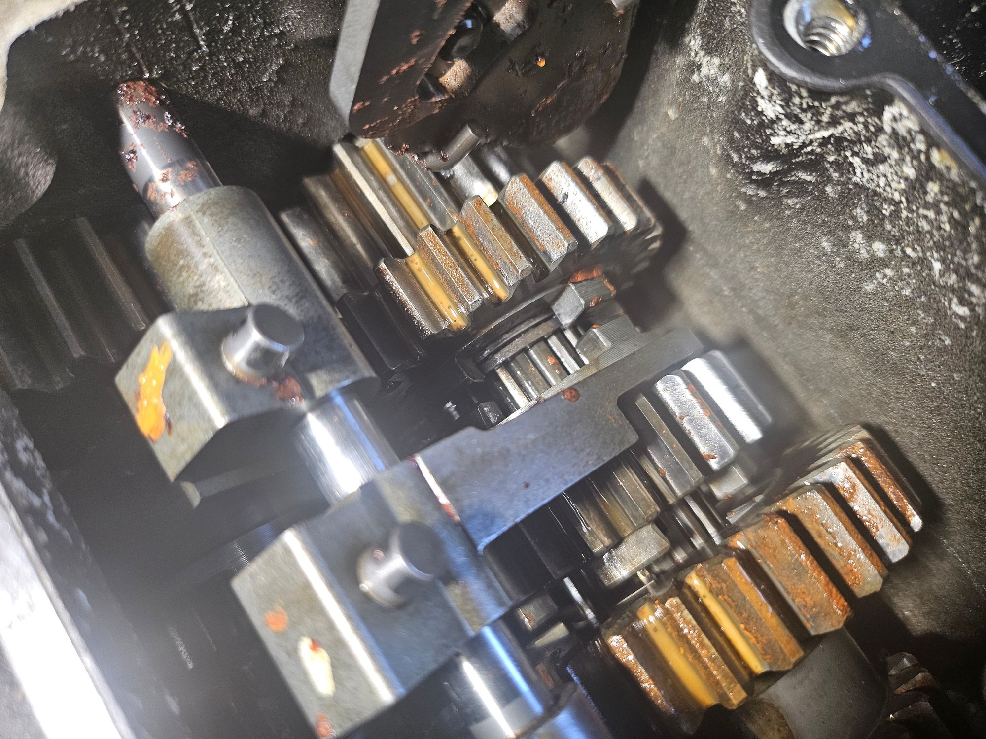

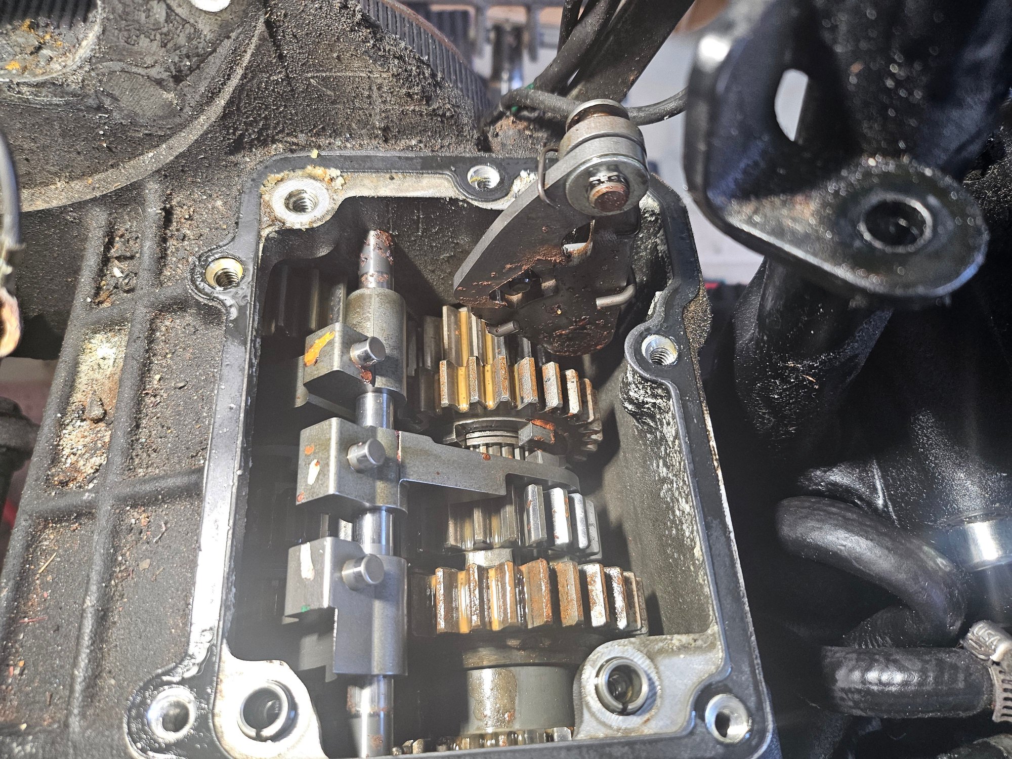

On a positive note, the transmission doesn't look all that bad above the waterline. I'll flush it out with ATF and take it apart when I can get my hands on a pulley socket next week.
