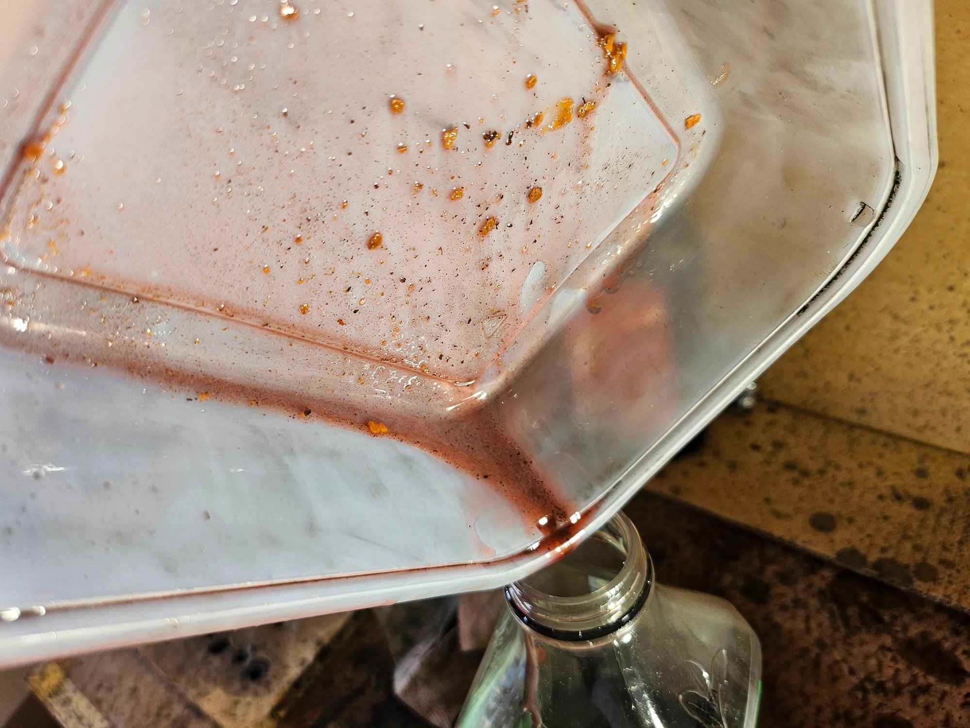

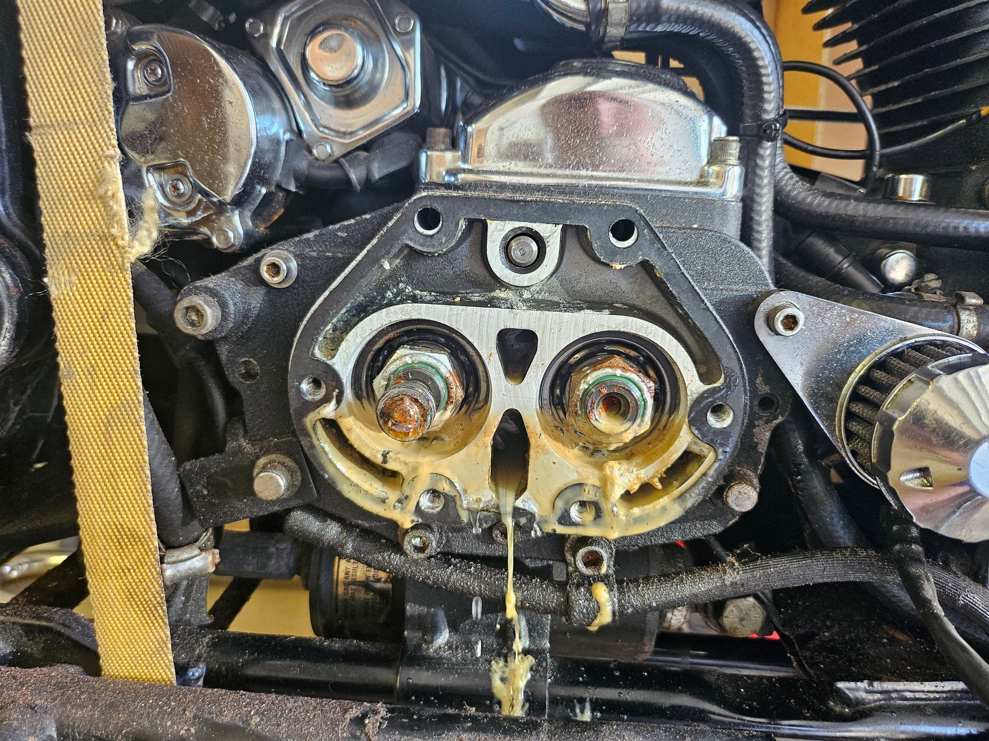

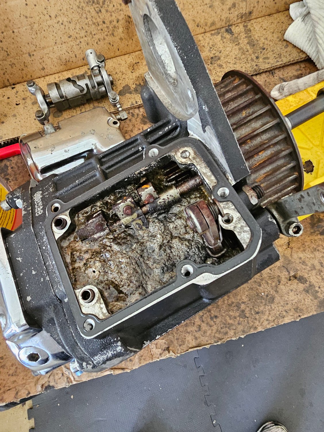

I finally finished one step in this project, the transmission is all cleaned out and soaking in ATF until next year:
When I took the top off it didn't look too bad, but remember how the side cover told another story.
This didn't look to bad
I filled and drained it with ATF/acetone three times, and got to this.
I brought it to the shop and he spun the gears and declared it good, but I needed to get ride of the rust on the gears, etc. He recommended soaking in apple cider vinegar overnight. This is after a few hours:
Today I say anything that was there is gone:
I flushed it all out with water, then removed the shift forks and side cover and gave it a good going-over with a nylon brush and more ATF/acetone. Another couple of flushes and it came out clean. So I filled it with two quarts of ATF and it will sit until I'm ready to clean and paint it next year.

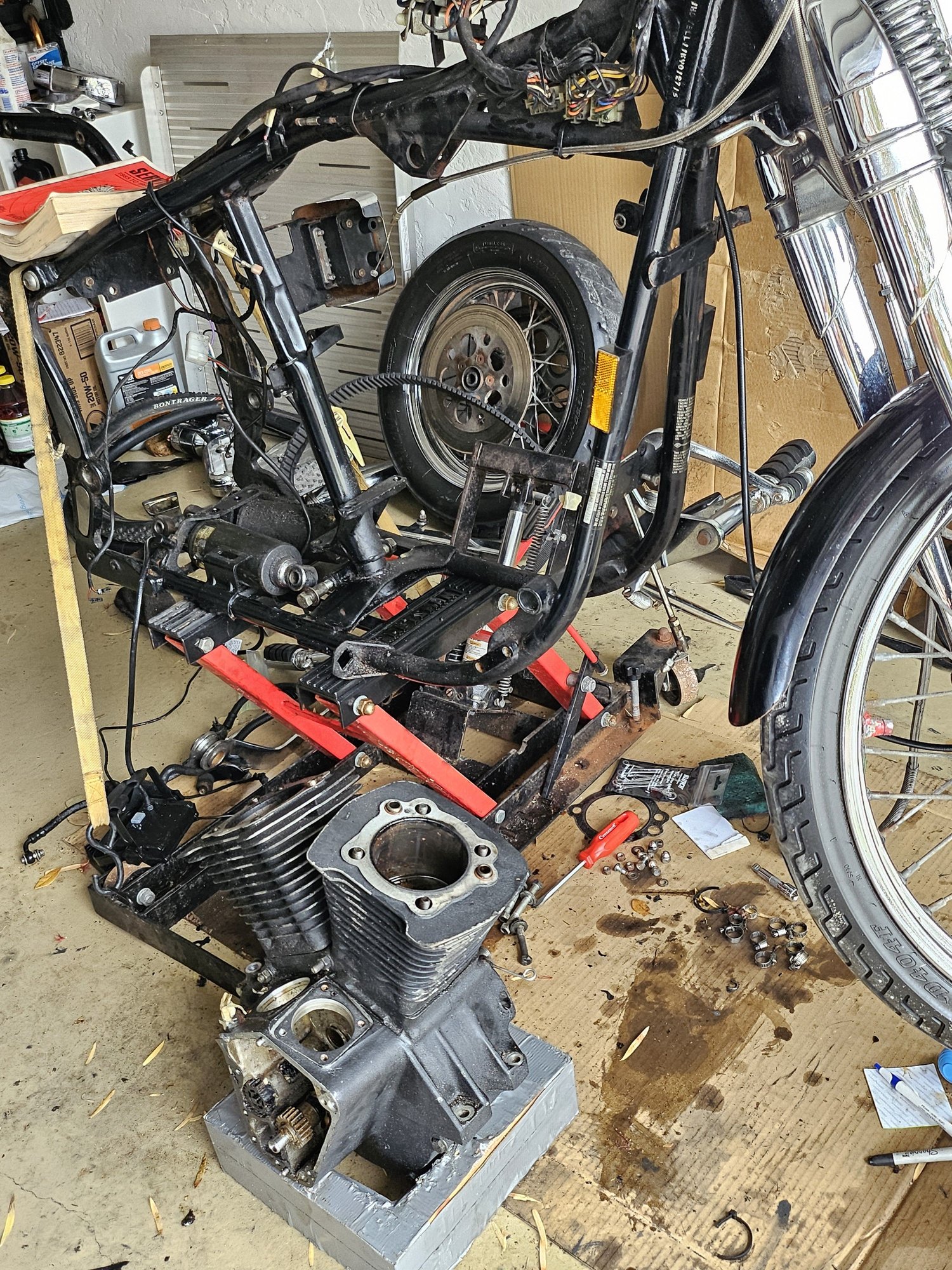

Motor's out, cleaned up, and I will bring it to the shop tomorrow. I'll know my options after I talk to him. Rebuild or replace? Any bets? LOL

The hard part about your tare down (can’t be avoided) is it will take time to sort through, recondition everything. Enough time will go by that it’s harder to remember each part, where it goes, the order it goes back together.. When I get into projects like that, I wind up putting together and taking back apart to get the right order for everything to be put back. Even with manuals and pictures it adds a little frustration.

@Rains2much you sound like my brother LOL! The most important tool I have for long projects like this is the factory parts manual. Between that and as many photos as I can remember to take, I hope I'll be OK. If not, there is this forum. It took me 2 years to restore my 82 FXR and it scored 99+ points under AMCA judging.
[edit] I dropped the motor off, he'll rebuild the crankshaft, bore the cylinders, fit stock-type pistons (9.5:1), rebuild the heads, and assemble the lower end. I'll also get an EV27 cam and new lifters from him. He says it'll be done in a few weeks, too!
