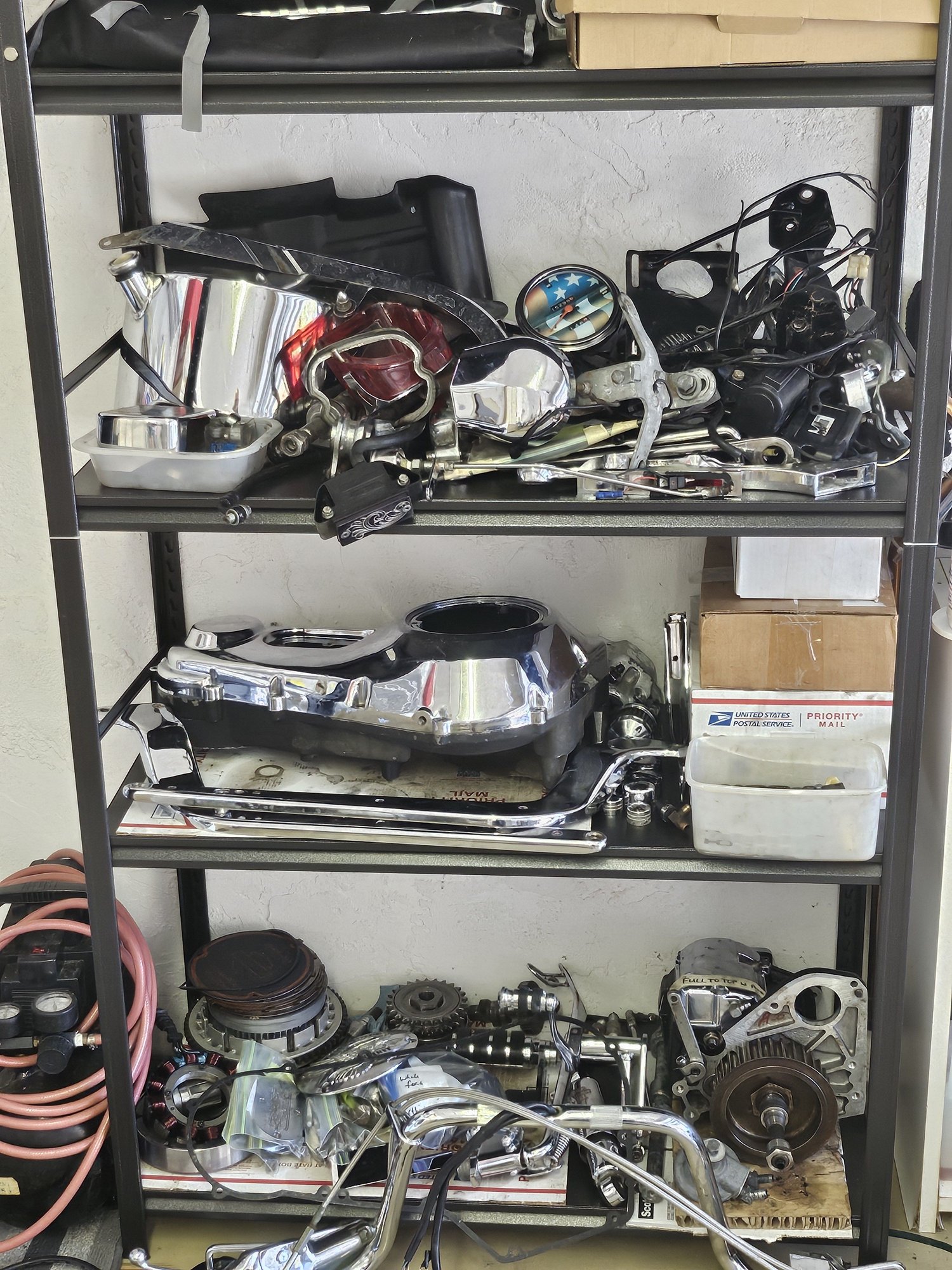

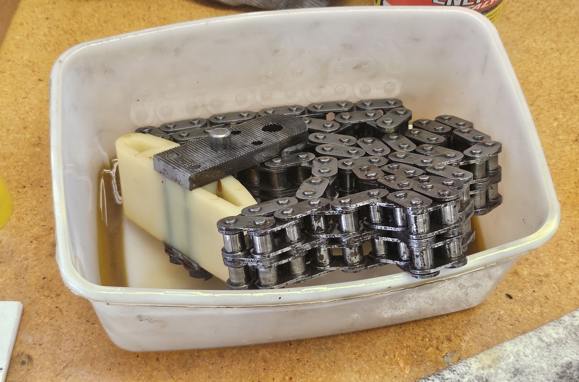

Thanks for the advise, guys. I have already told the shop to rebuild my motor, stock, but with an EV27 cam and good valve job. I know this is a weak year, but having the original motor means a lot to me. I don't ride like an animal any more, and because this will be bike number 2 that I keep in Florida, I don't expect it will get a lot of miles. So I'm confident it will last until I can't ride it any more. .
Except for the frame and forks, I am done for now. Oil pump cleaned out and I rubbed the check ball seat with a pushrod end to get a shiny ring. I may bring valve lapping compound with me next year and do it right with a spare pushrod. I cleaned up the primary chain with mineral spirits and then PB Blaster. I think it will be OK, even with some rust on the plates and rollers. I checked all the rollers, they turn freely, and there are no frozen links.
Here's a motorcycle on three shelves, LOL:
Excellent choice. I’m sure it’s gonna be plenty of fun. Nice to have the original motor!
