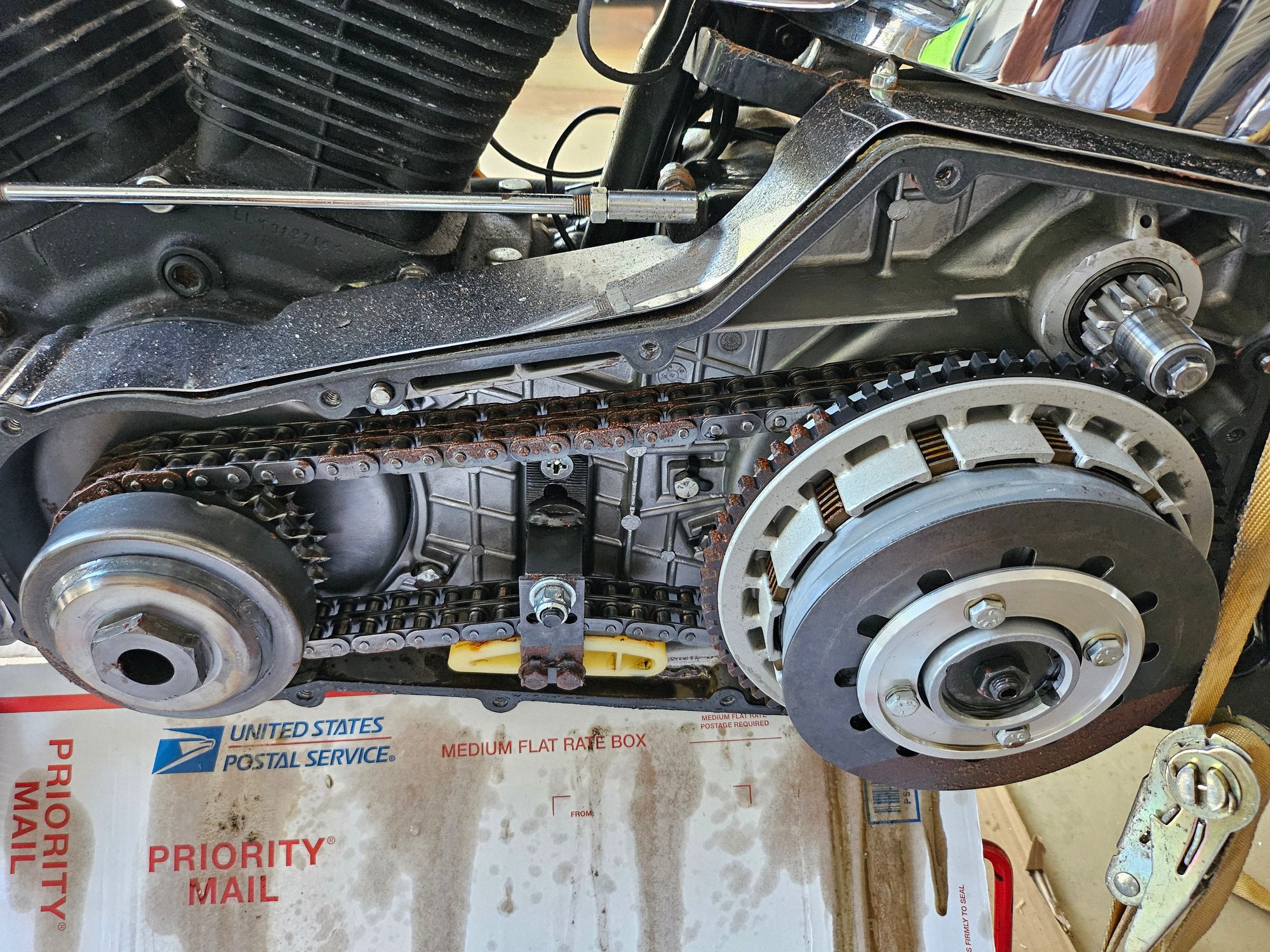

I made a lot of progress towards removing the motor and transmission. I'm letting the exposed head bolts soak in PB Blaster before attempting removal.
The inner primary doesn't look bad at all. Apparently someone was able to turn the motor over enough to get the rusty part of the chain to the top.

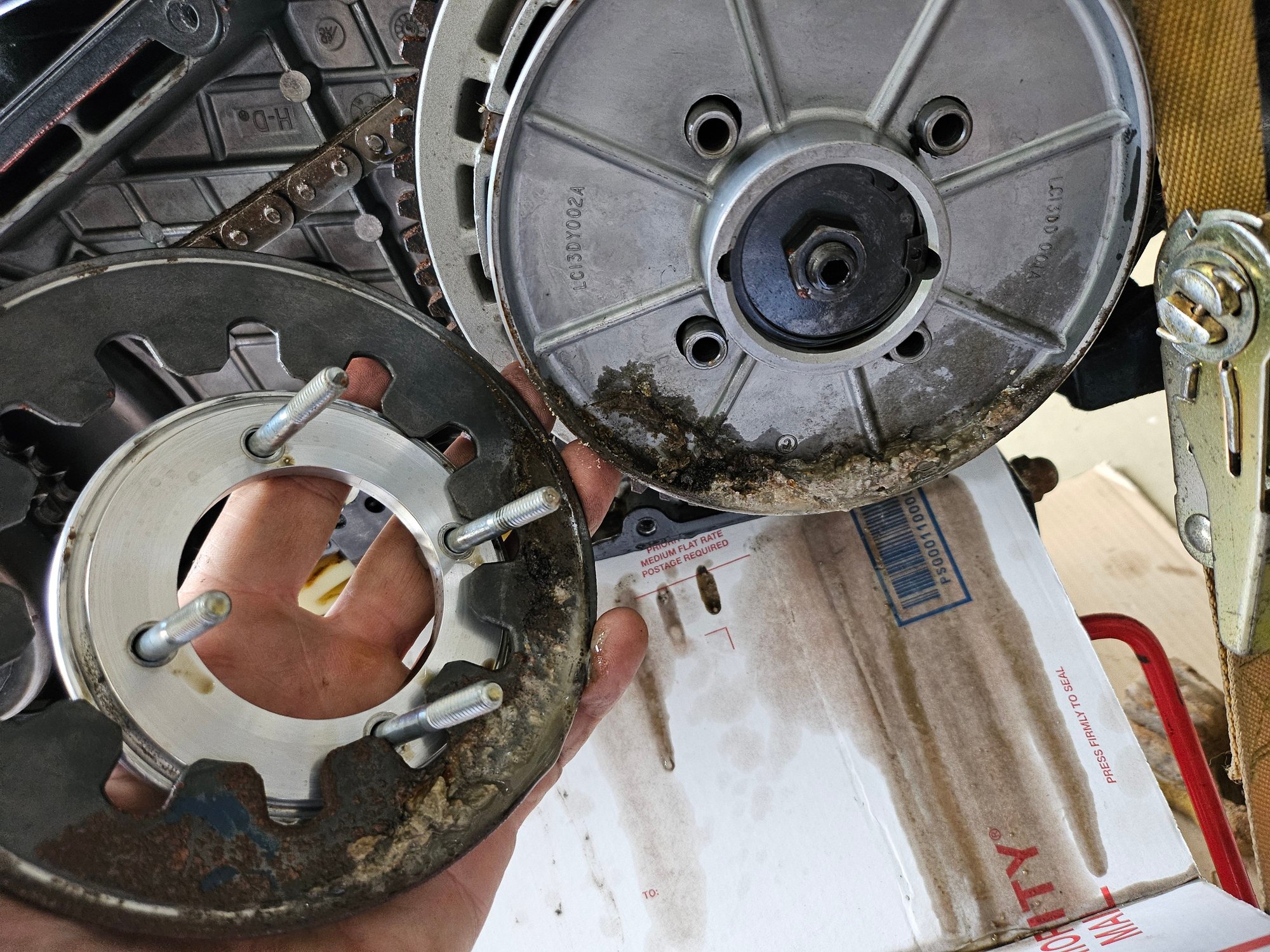

The clutch diaphragm was hiding this crud, but it washed off easily with soap and water.

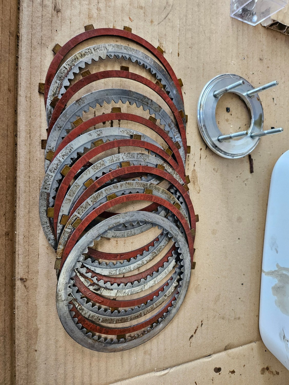

I didn't measure them, but the clutch plates look reusable after some cleanup. I don't think that's a stock aluminum plate holding it, so maybe the clutch was recently replaced?

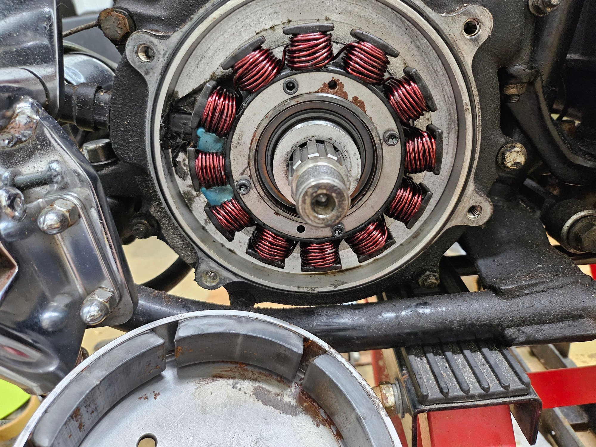

The stator looks pretty good too. The rotor wasn't rusted to it, even though a little water made its way in.

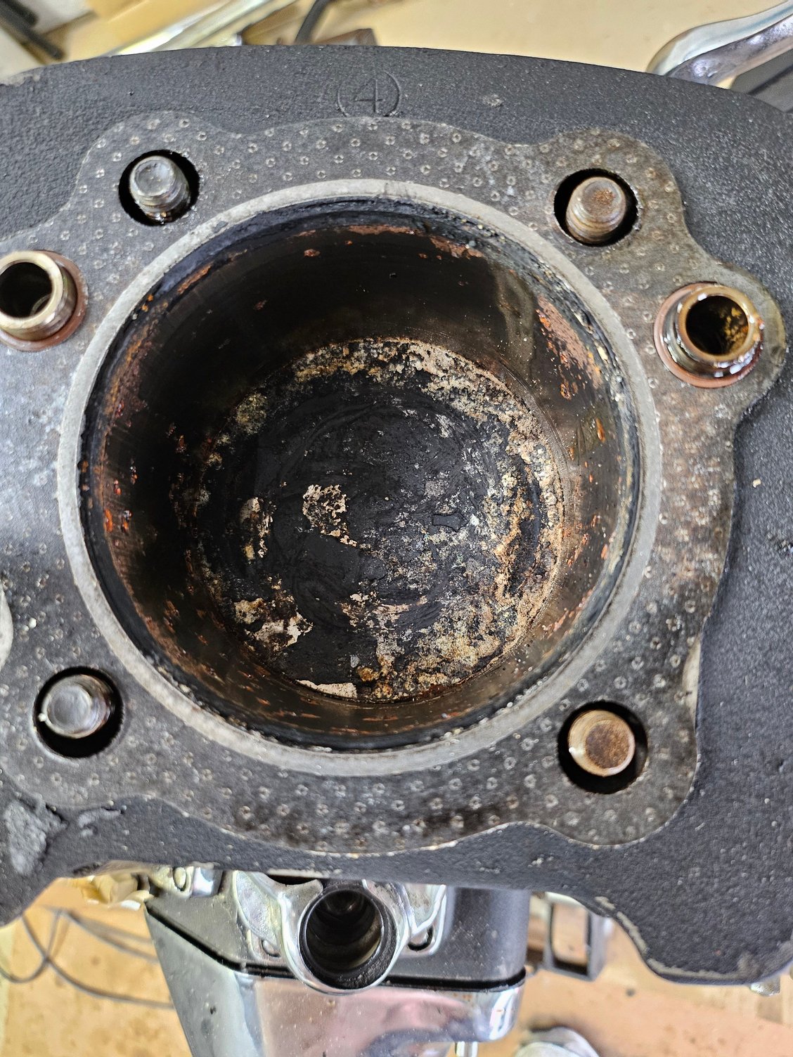

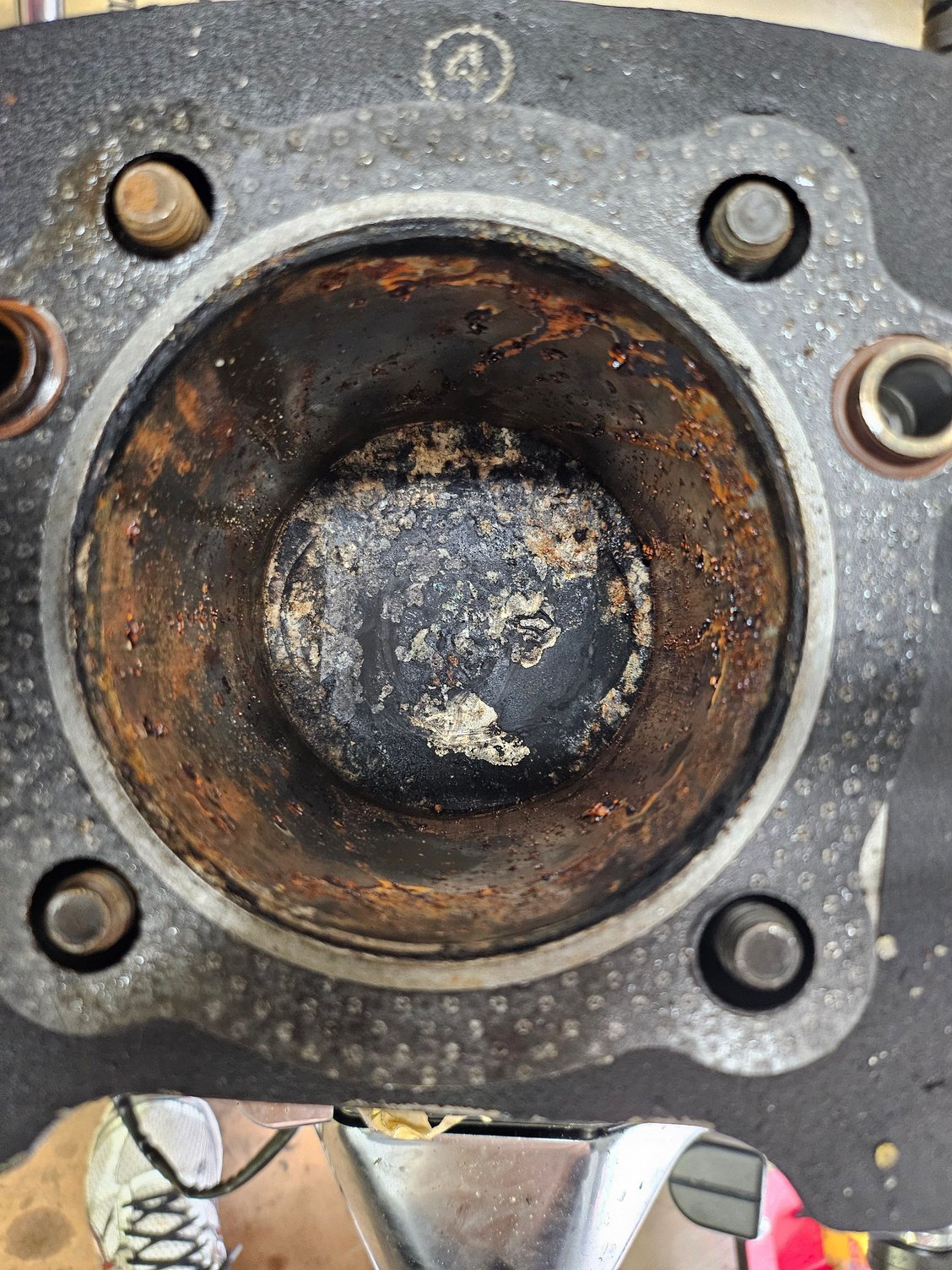

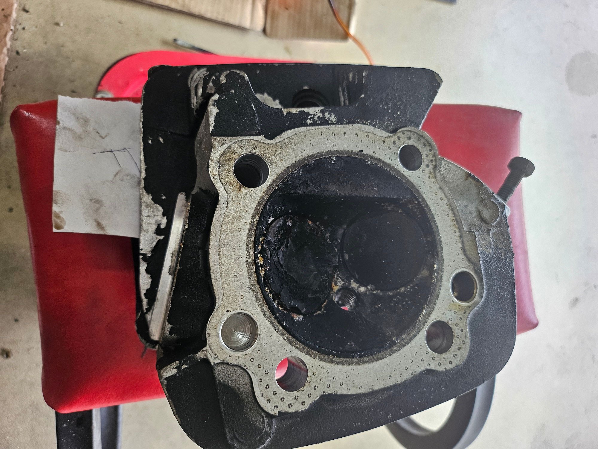

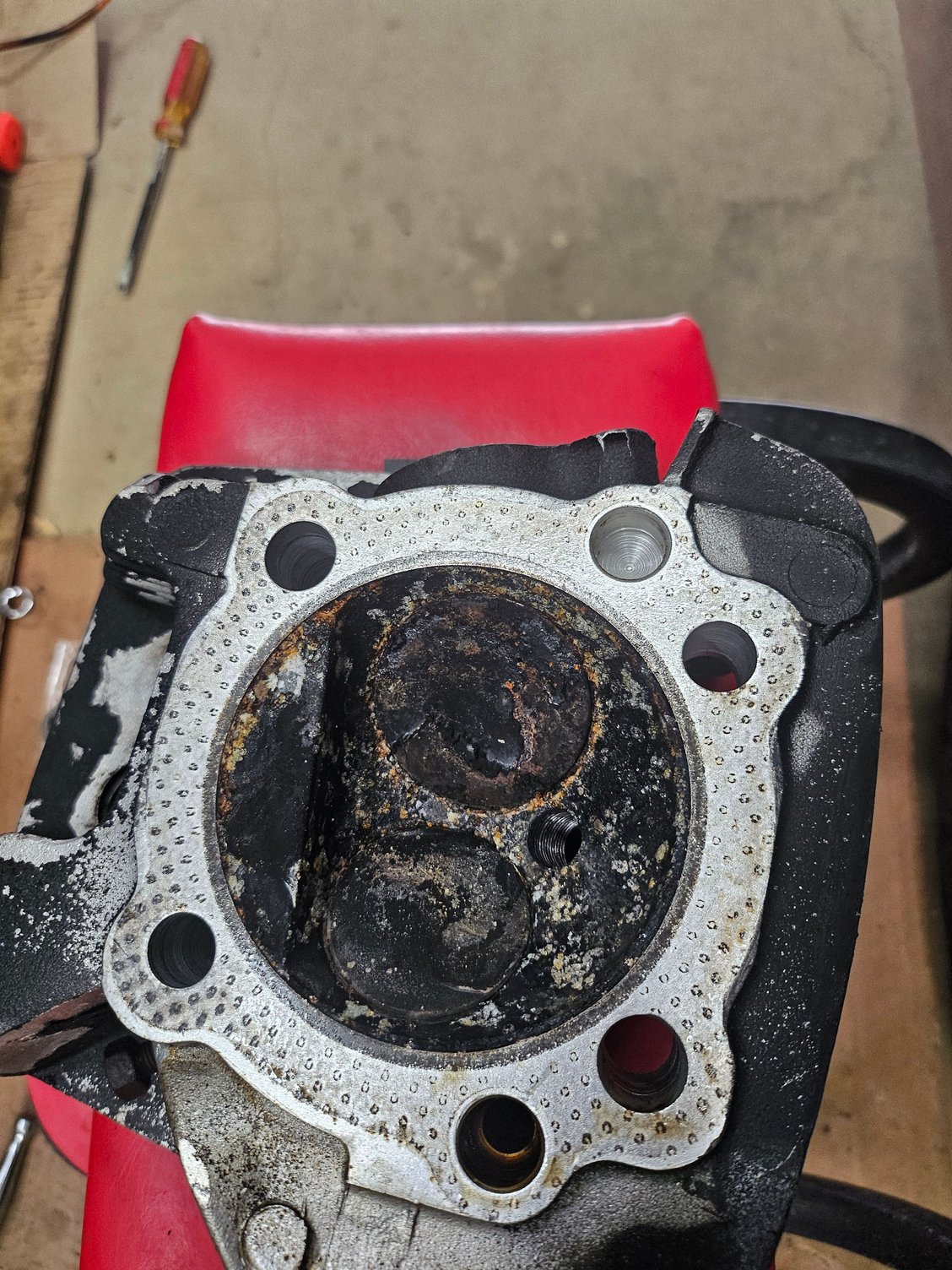

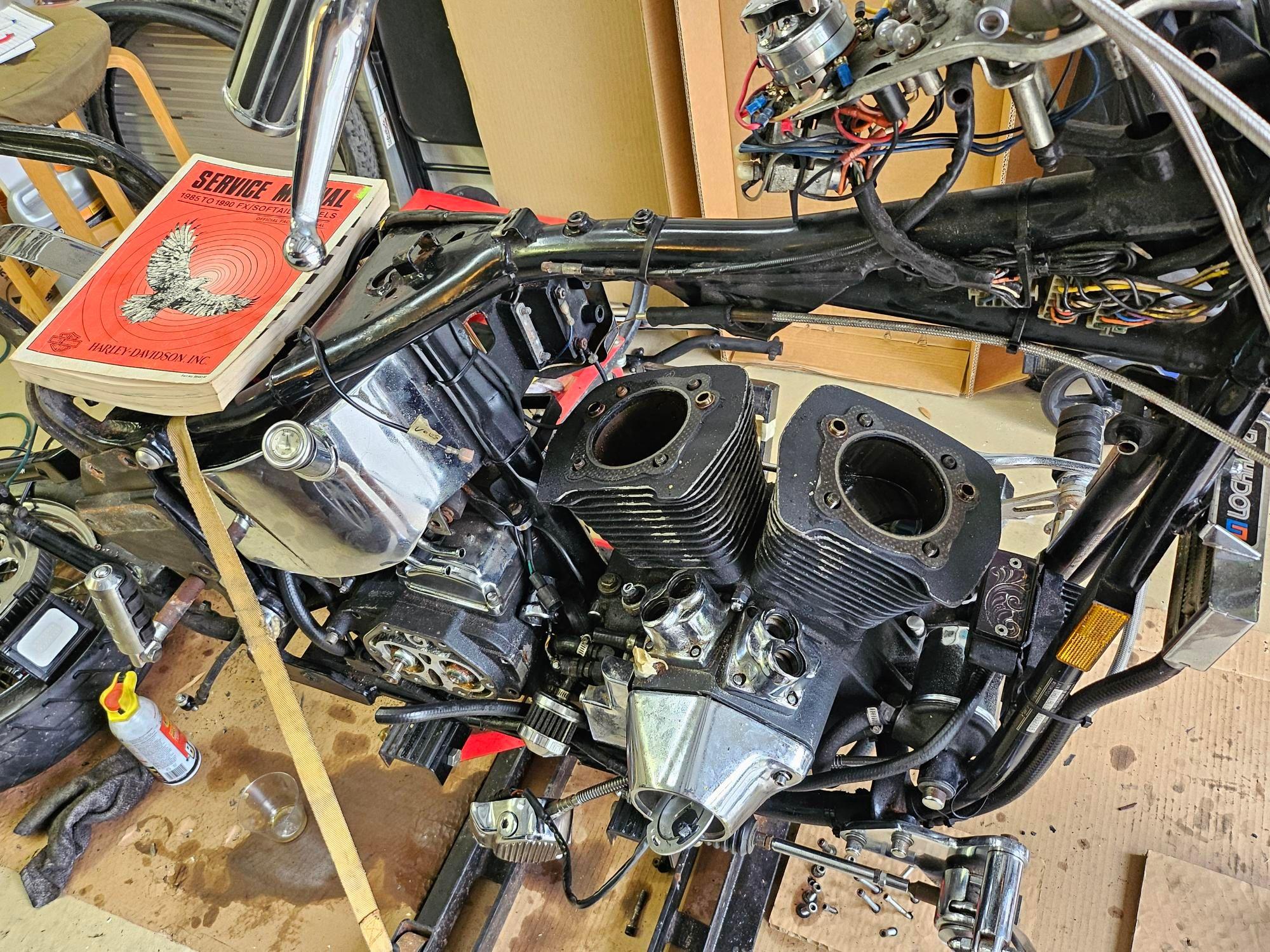

Big day today, I took the heads off. The cylinders and pistons don't look as bad as the boroscope showed. A lot in those pictures was loose salt residue. Here is what I found after I vacuumed out the crud.
[edit to add] the nuts under the rocker covers were easier to break free than the ones out in the open. IDK if that means those studs need attention, or just the nature of the location?
Rear head and cylinder. This is the one that had an open intake valve.
Front head and cylinder.

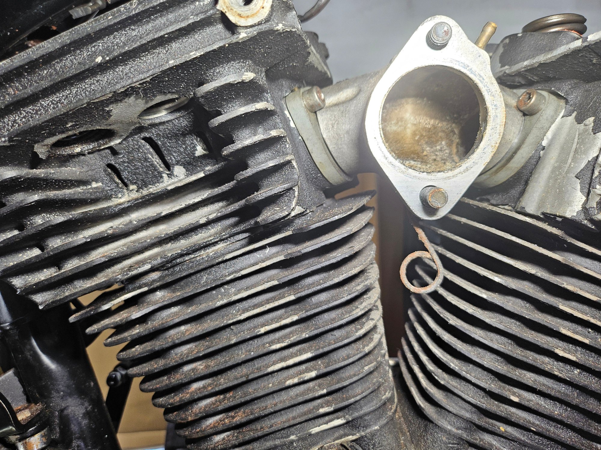

I did find evidence of the water level on the intake manifold, so I know it was mostly submerged. Fortunately not as high as the wiring harness and dash.
I'm soaking the pistons in PB Blaster overnight before I attempt removal. If they don't come off fairly easily, which I expect they won't, I will have to resort to stronger potions. I seem to recall a mixture of ATF and something else works well. Anyone know the other ingredient?
If I can get the cylinders off without too much damage, I'm encouraged that they can be saved. No telling what the lower end looks like, but my friend the shop owner says it should be OK after filling and flushing with ATF for a while.

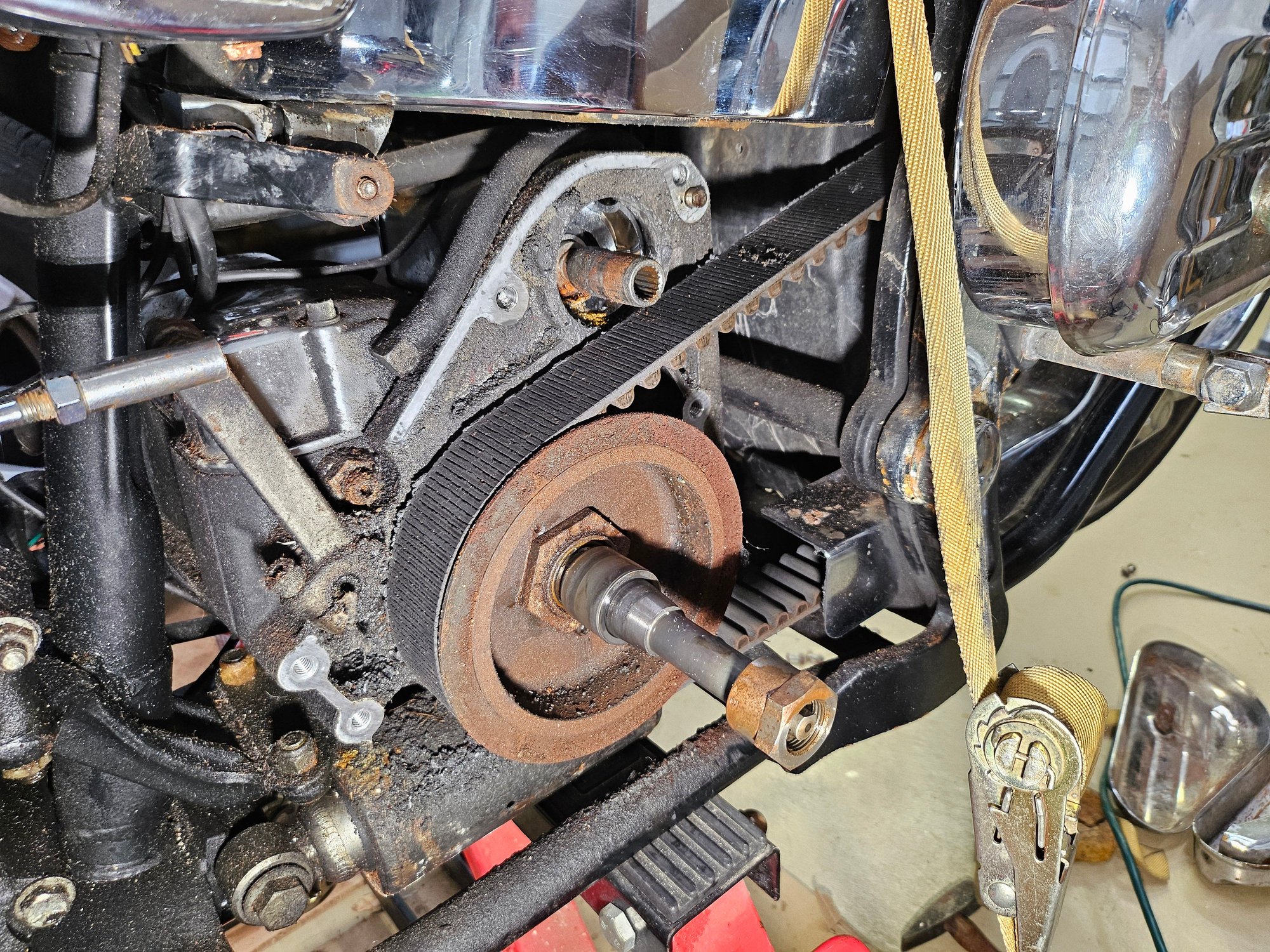

I took the rear wheel and fender off too. That'll make the bike better balanced when I take out the lower end. There's a jack under the front wheel.

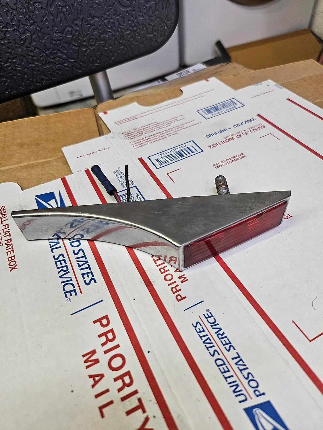

Anyone have one or two of these turn signals they want to part with?
They come up on ebay and marketplace regularly, you’ll find what you need w/ a little patience.
I was going to start a search, but don't know what to call them. Any ideas? Thanks
https://www.ebay.com/itm/28617527618...mis&media=COPY

Thanks, I saved a search for fender strut turn signals. The red ones may work, but I can't see any wires. I sent a message to the seller asking for more pictures.
