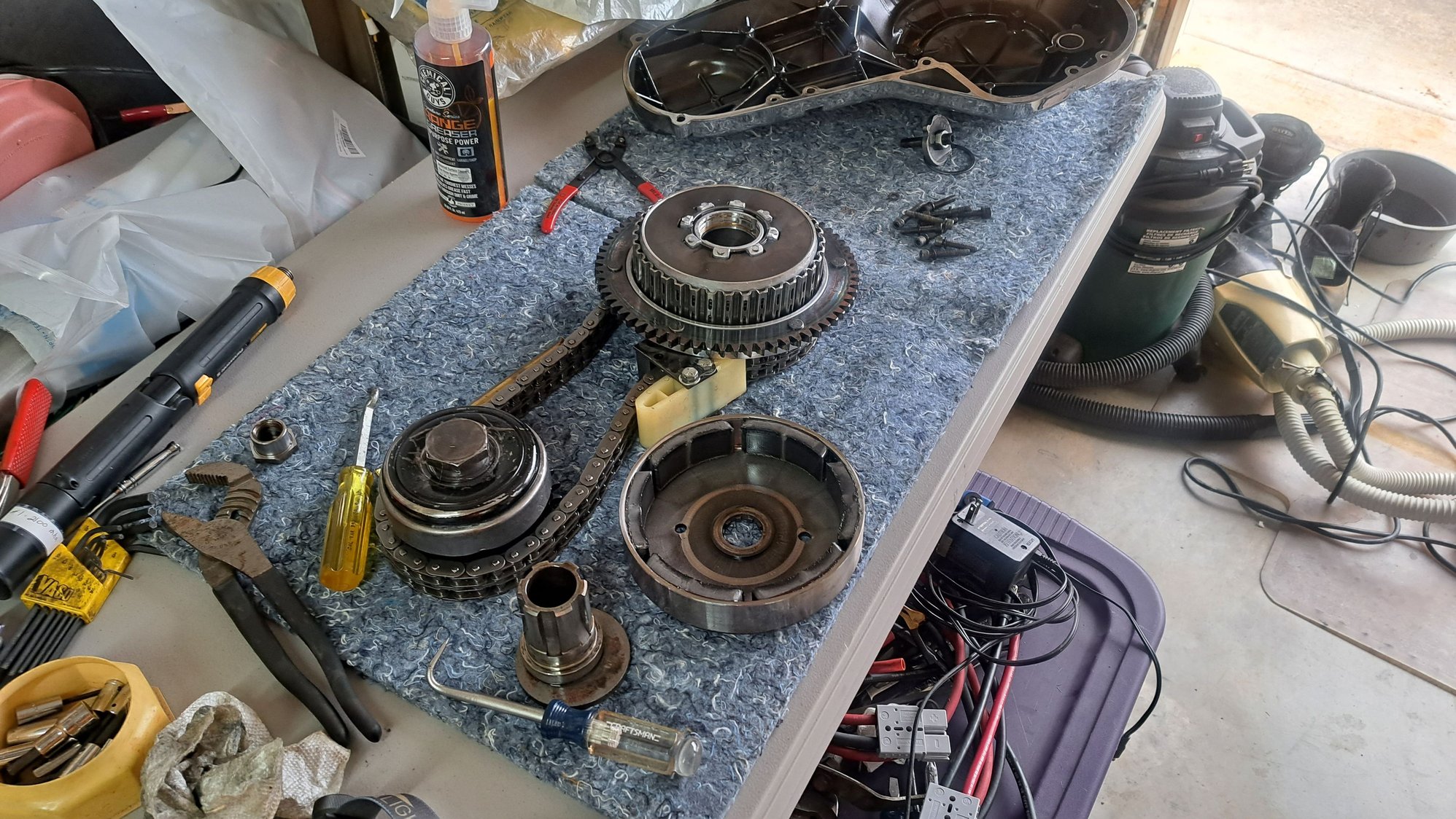

This is a stock HD clutch I think I put it in my 89 flhtc sometime in the mid to late 90's. I know there a few different clutches ofer the years.

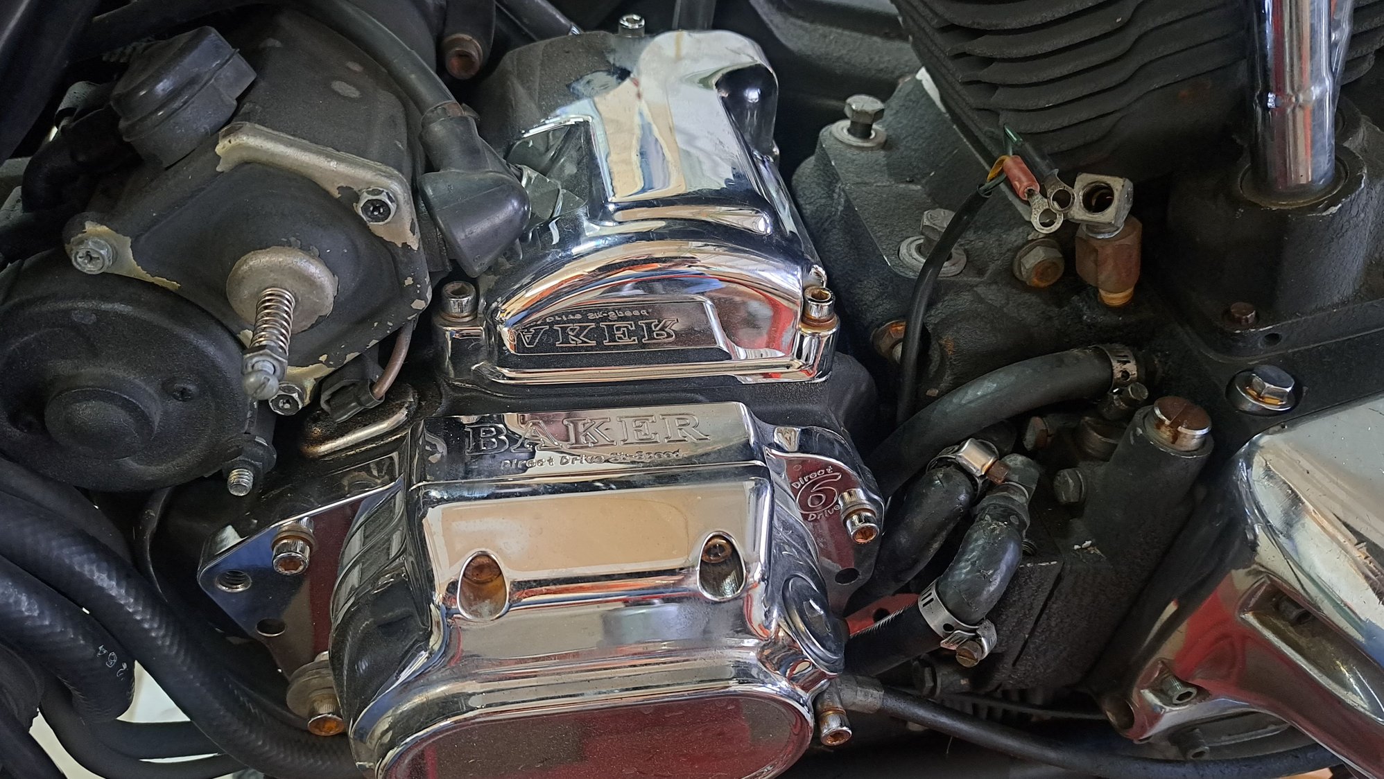

I had broken the original tapered shaft and rebuilt the stock tranny with a splined shaft, then a few years later I swapped in a Baker direct drive 6 speed.
Pictures for reference
TIA
C

That is a 90-97 clutch assembly, I'd be surprised if it still has the stock clutch plates holding up behind a 111" due to the intermediate plate is held together with brass rivets comes apart. If it does have stock clutch plates check into Energy One or Barnett extra clutch plate kits because the riveted plate will come apart in the future keeping the clutch from disengaging.

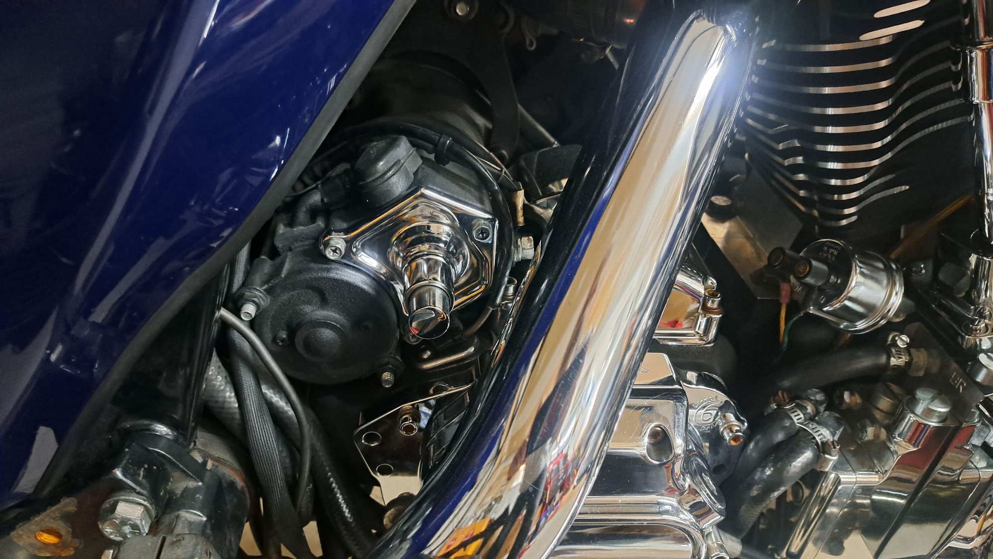

Originally Posted by chrisflhtc
The Hillbilly pushbutton on the starter is sweet..
Griz

Need to use clutch spring plate tool to pull the spring Clip, to remove the spring plate, the clutch packs,and then photo of the bottom of outer basket.
But innerhub and other basket look stock 97 older with spring plate, and need to make sure no clutch spring plate since motor is going to rip it part in no time, or its looking anything like this is still in play instead.
Or like this clown that has no clue that spring plate rivets are breaking apart, spring plate about to come apart to take out both the inner hub and outer basket, and just putting the broken rivets piece back in at 3;00 instead,
Griz
I finally found a real push button the 89 starter is a bastard. I believe it was only used then.
