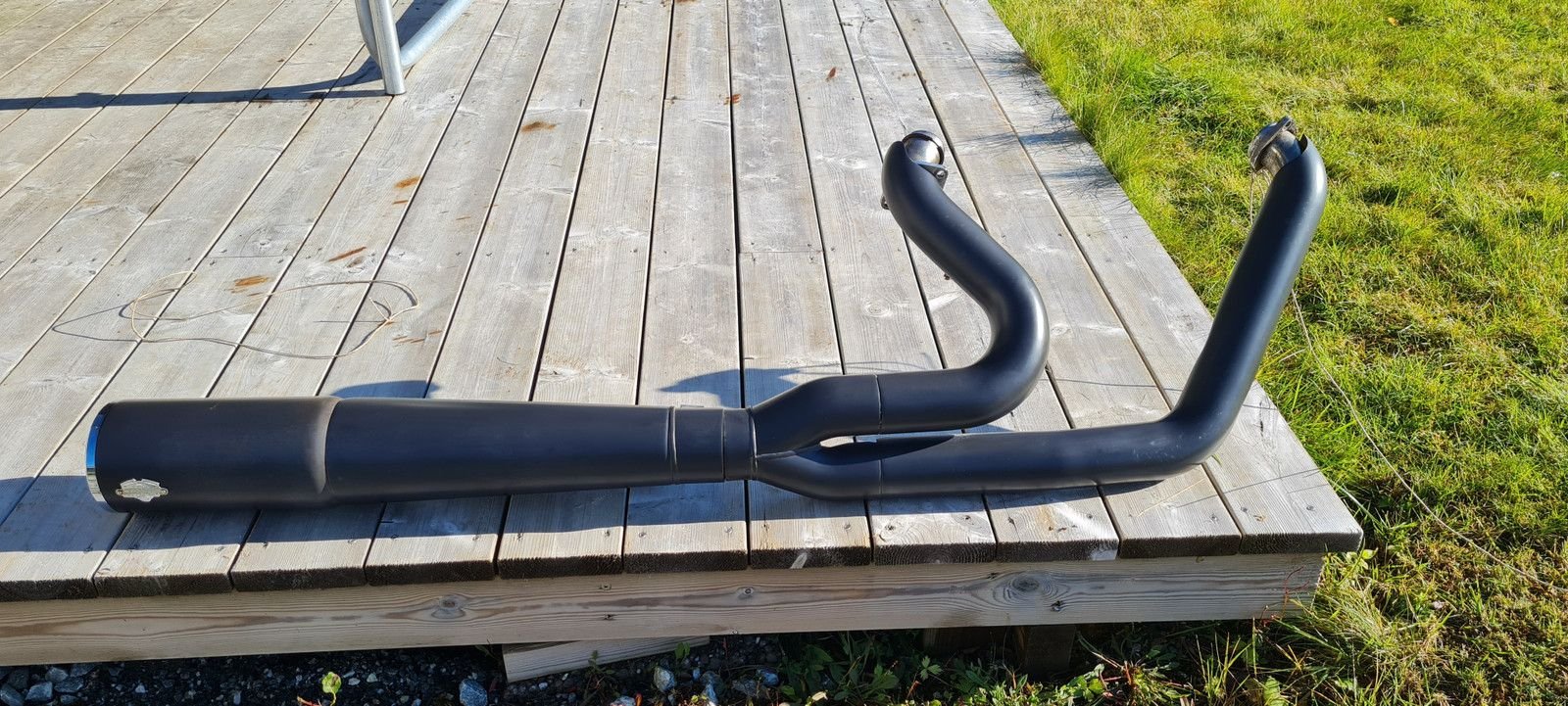

I am new to these, so I am asking the expertise here: Will a '00 1450 exhaust system fit my '99 1340 motor?
I have a 1999 Fat Boy FLSTF and I am looking for a good 2-1 exhaust system for it.
I'm in Norway, and the market isn't great for evos here, but now there's an affordable Vance & Hines Pro Pipes full system for sale that I would like to buy.
Seller says it's taken off a 2000 Softail with a 1450 motor.
It's too far to go there to test, and I don't want to create any hassle for the seller by returning it if it doesn't fit.
I ask because I see conflicting info in retailer's listed specs. Some say it will fit 86-11 softails, but I want to make sure.
Brackets I can modify within reason if needed, but I need to know if the headers and flanges will fit on my motor.
Any input appreciated.

The exhaust ports are in the same location on both engines
No worries on that.

I dont know about Softails but Dyna Twin Cam & Evo exhausts will bolt right up. It may eed some modification to the mounting brackets, but the pipes will fit.
I would assume the Softail models are the same too.

Thanks, @Bubba Zanetti. That's what I seem to find everywhere on retailer's sites for the Evo Fat Boy too. -Brackets and floorboards might have issues with some systems, but flanges and headers will fit.
from `84 to `16
