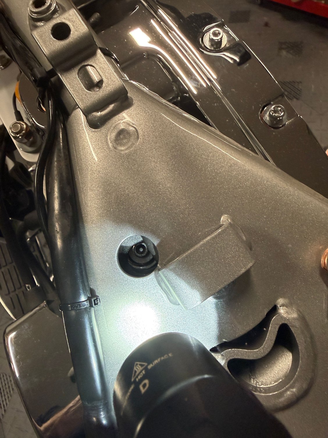

I never owned a Softail. Man, I bet getting that rear rocker cover off is a bitch.
No way to get the rocker cover off of the rear with the engine in the bike. Crazy!
EDIT: Maybe cut the head off of that one bolt and replace the rocket cover with a new one LOL
EDIT2; I went out to the garage and looked at it. The MoCo put a hole in the frame to get to that allen bolt.
I'm surprised. The three piece rocker covers let you take it apart and remove. At least that's how it worked with my 89 springer. I took the heads off too.
I got to looking at it and there is a hole in the frame to get to that bolt that is so close. Whew!

For starters, some one has installed double nutted studs to secure the top engine mount.. A grade 8 bolt and hardened 1/8" washer is all that is needed.. Also a cut down allen wrench is all that is needed to secure or remove the left rear top cover bolt.. Although on my Softail, I Did drill a hole in the frame to ease the access..
I wonder how far the bike made it through the R&D before someone figured that out.
I need to correct myself.. My memory is getting bad.. The Fatboy does have the hole in the frame..
It was my Dyna that I drilled to ease the operation of removing same said bolts..
