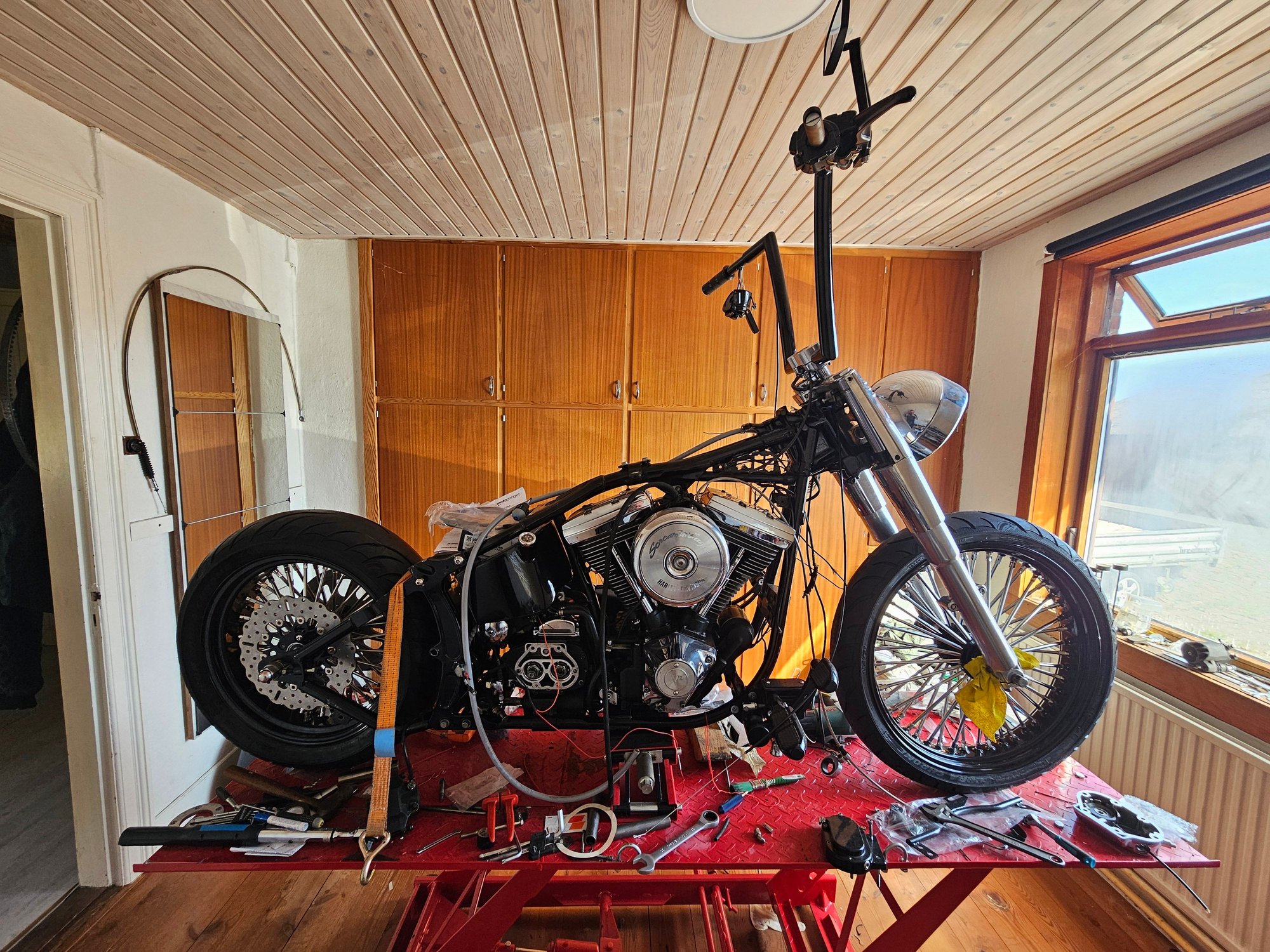

Old Jun 21, 2025 | 02:58 PM
Evotjolle's Avatar
Evotjolle
6th Gear
Joined: Jun 2025
Posts: 10
From: Denmark
This is what i have at the moment :-)
And this is how the wheel align in the swing arm, offset too the left compared too the frame

Looks perfect! No issues with the belt?
Old Jun 22, 2025 | 09:23 AM
Evotjolle's Avatar
Evotjolle
6th Gear
Joined: Jun 2025
Posts: 10
From: Denmark
No issue at all, i don't have the stock swing arm, it's made for a 250 tire :-)
Oh...I do Not see a straight string...But.. I am not at the camera.. Offset rear wheel won't hurt Nuthin..long as the wheels are Parallel.. Belt runs Straight and True.. Long as it is Not an FXR or Touring Model..frame Is Married to swingarm!!
