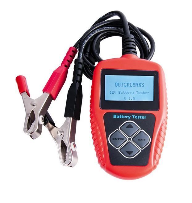

Originally Posted by Muskrat21
G'day Fellas.
Everyone needs one of these
I use mine all the time. Shows you voltage, ohms resistance (the lower the better), battery health, charge %, cold crank amps and whether to replace or charge. I recently had a 5 month old battery fail. It would charge up to 13.5v but still wouldn't turn the motor over! The tester said 13v but the ohms read 20 something, 20 cca, replace. It's always the first check I make on any bike or car.
Cheers
This thread has certainly been educational for me. I thought that if it would take a charge to 13+ volts, it was good regardless.
Lesson learned.

G'day Windseeker.
A mate that has been riding for 50 years thought the same. He couldn't start his modern Trihard. Said the battery was showing 13.5v on his multi meter. I put my tester on and it said 13v, 25 ohm, cca 20, health ZERO.
Never stop learning.
Cheers
