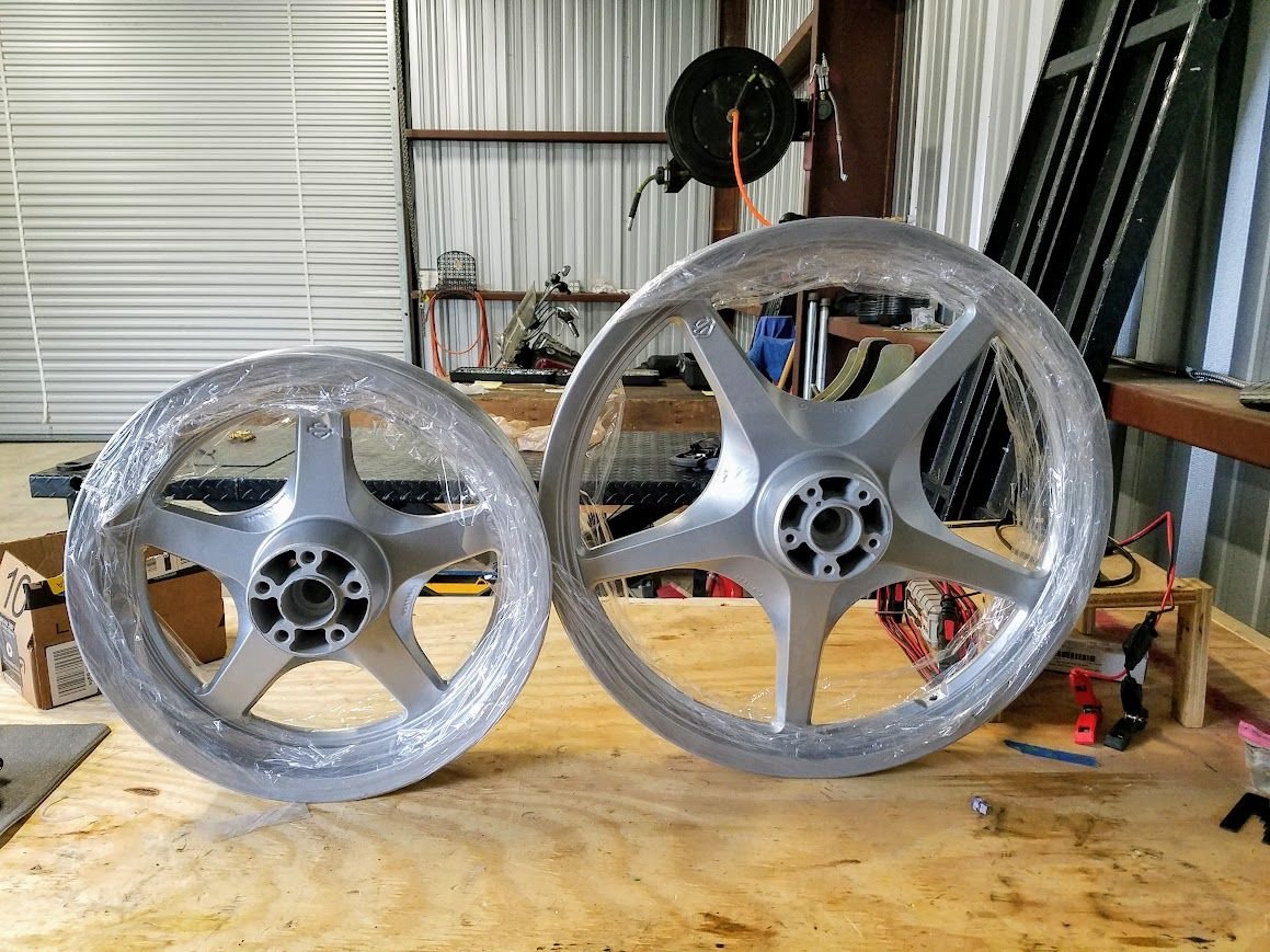

I tried to reply to your IM but I'm not sure if it worked or not.
Here are the wheels I'm talking about.
