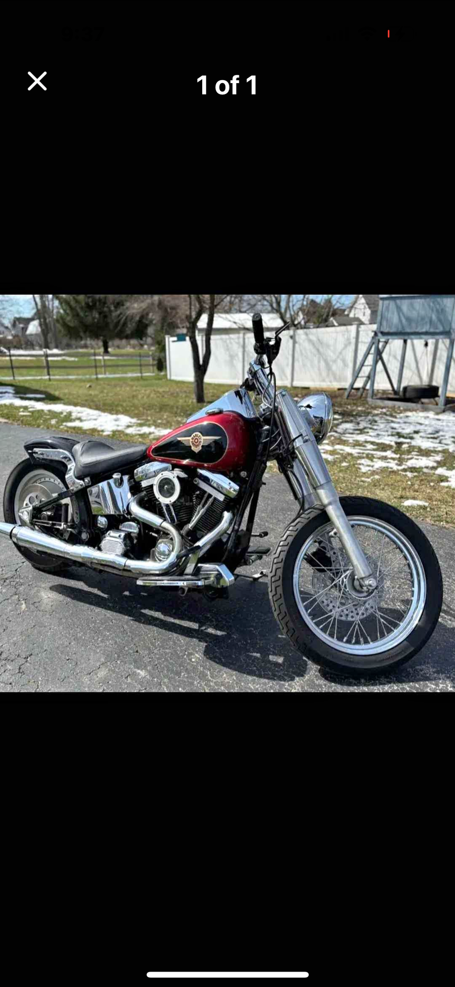

Well my shovelhead project is about done and time to move onto the next while waiting on a dyna title. I found a ‘97 fatboy 18,000 miles for $3500. I want to put a 19” tire on the front similar to the attached photo. Will a dyna spoked or mag wheel work? I do want a chopped rear fender as well. Are any parts becoming obsolete for these
evos?

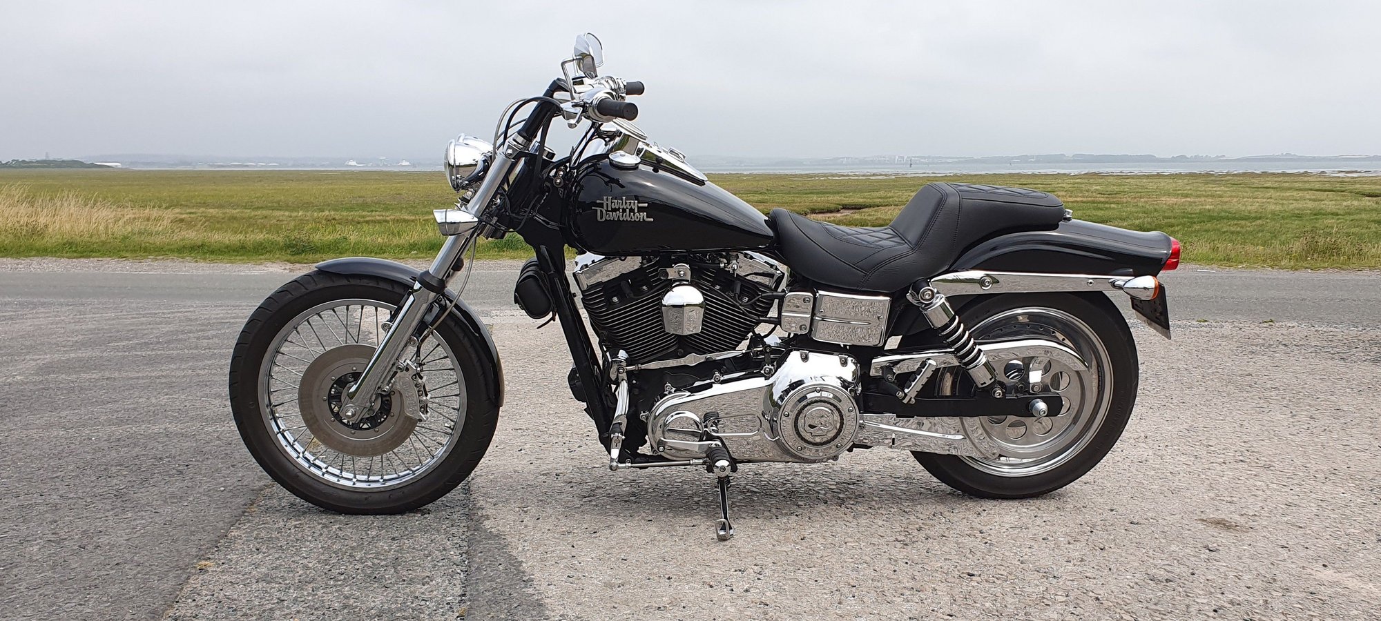

anything is possible, I have a 2006 dyna with a 17" front wheel, but I also have a 19" wheel that I sometimes use, the thing is the 19" wheel is off a 1978 Z1000. at the end of the day you can get anything to fit.
my dyna with the Kawasaki wheel fitted.

I have a 19" on my 98 Fatboy but it was made for the FatBoy front end. I don't believe the hub width is the same on a dyna. The triple trees center to center is different from Wide glide @10" to Fatboy @9.5" and Super Glide @8" which would require shimming of either the caliper or rotor to properly center the rim and new spacers.. A 120/70-19 tire will still fit under the fender.

Just FYI the FXSTC comes with a 19" front wheel so what you want to do should be fairly easy.
Not sure if you're committed to spokes but I have a set of rims (16 rear & 19 front) that I had powder coated a few years ago but decided not to use them.
Both use the tapered bearing of the EVO's.

A 1997 will be easier than an older one because it doesn't use a speedo drive. The narrowglide wheel wont be a problem to put on the Fatboy.
Put your wheel on the front end. Center it with a plumb Bob in the headlight hole. Then use pvc to make your wheel spacers. Once you have your wheel spacing set you will need to space the rotor outboard to center it in the caliper. Then you are done.
