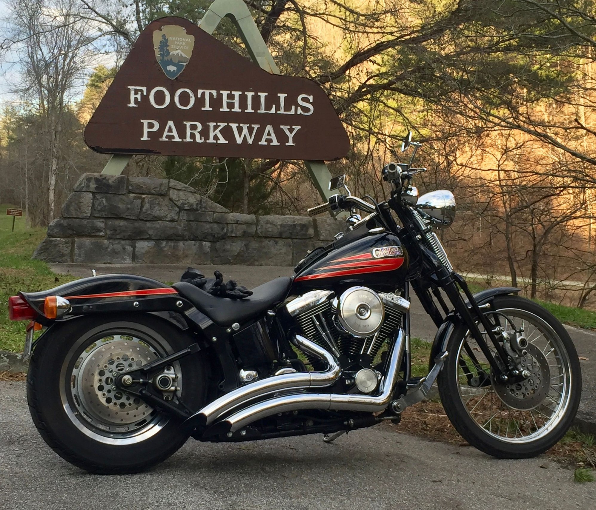

Default I have an EV27 in my Bad Boy and it’s fine. Running OEM lifters.
No issues here. Been running the EV27 and OEM lifters for a few years. I have a Buttcrack Solo saddle and the power nearly pushes me off the back. I think its enough.

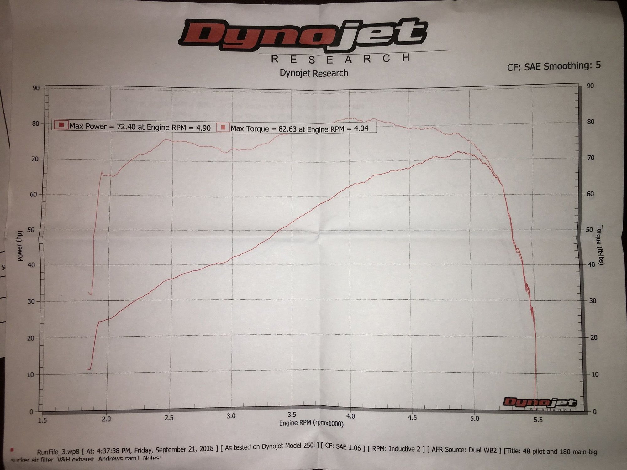

NO Issues???
Look at that dip.. Those pipes are the second worst pipes you can put on an Evo...
I know because I had a set.. Nothing but noise..
NIce bike though..

NO Issues???
NIce bike though..
For kicks n giggles pull the baffles out of those and install the large TTI’s per instruction and retune the carb. I bet that dip will be better, not fixed, but better.
