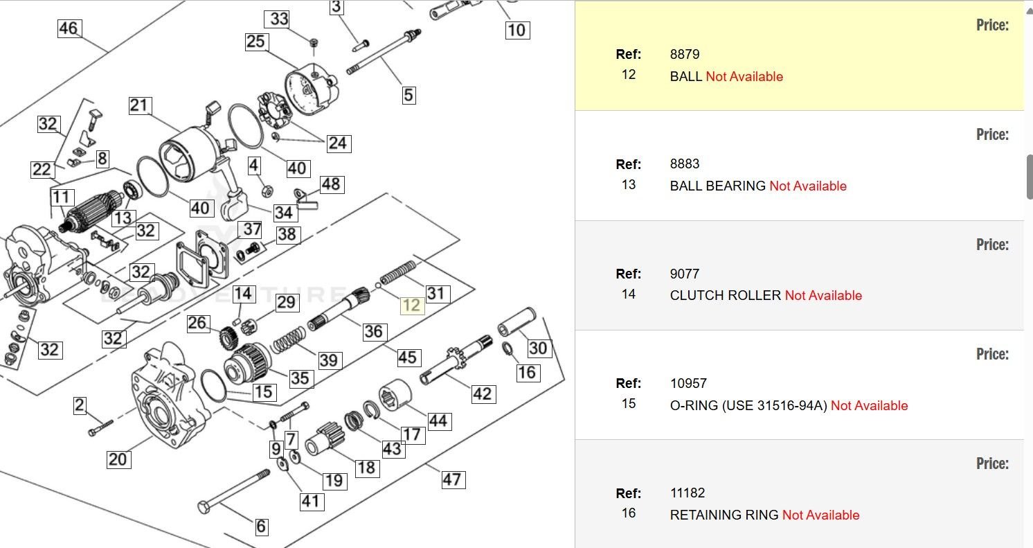

When you get the starter to the bench, get one of those plastic dish washing tubs.
Disassemble the starter while it is in the tub, that way if (when) a small part falls off you can find it, I do the same with carburetors.
Here is a link to a video showing how to replace the starter clutch, but be careful, there is a small ball bearing in there that may fall out and it is not mentioned in the video.
You can see the ball bearing in the parts illustration (item 12).
