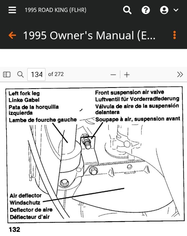

I picked up a 95 Road King yesterday and it has air suspension front forks but I can't for the life of me figure out where the Schrader valve is.
If any of y'all know and would share that info with me, I sure would appreciate it.

remove the right side bag. On the fender side strut there is a bracket, there will be two inlets. The front inlet is the front shocks.

That early model has the air assisted anti dive feature
Look for the valve in the L.H h-bar end or at the crash bar, both were used at some point way back

I’ll do that. When I looked on the fender support all I saw were two empty holes.

From the Owner's Manual:

My 1992 FLHTCU had the front air valve in the left side handlebar end
