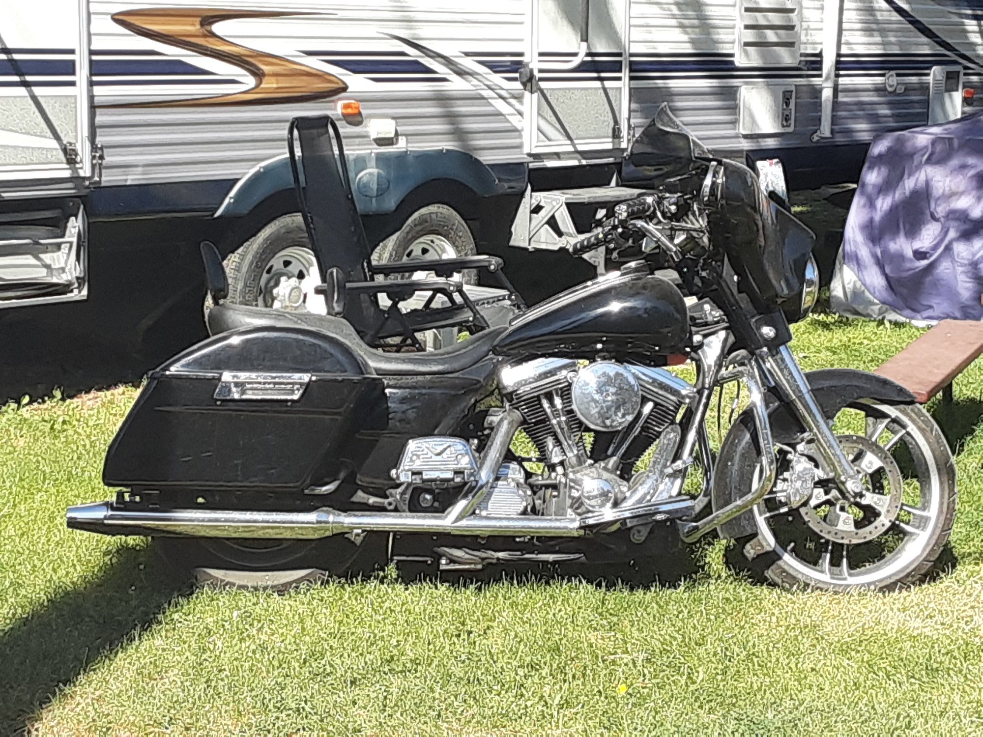

I have some on my '94 - they've been on it for 20+ years. If I remember correctly we had to get the rear fender hanger bracket for a street glide to attach them in the rear.
Some of the RK's have the double wrap around horizontal bar and a somewhat vertical bar- IA, you want to completely eliminate those - correct ? Mine is just a horizontal rail that the bag sits in with no vertical bar. This kind of bag look ?
We used to have some of them in the shop, I'll have to look around, I haven't seen them for a while but they could be buried somewhere.
