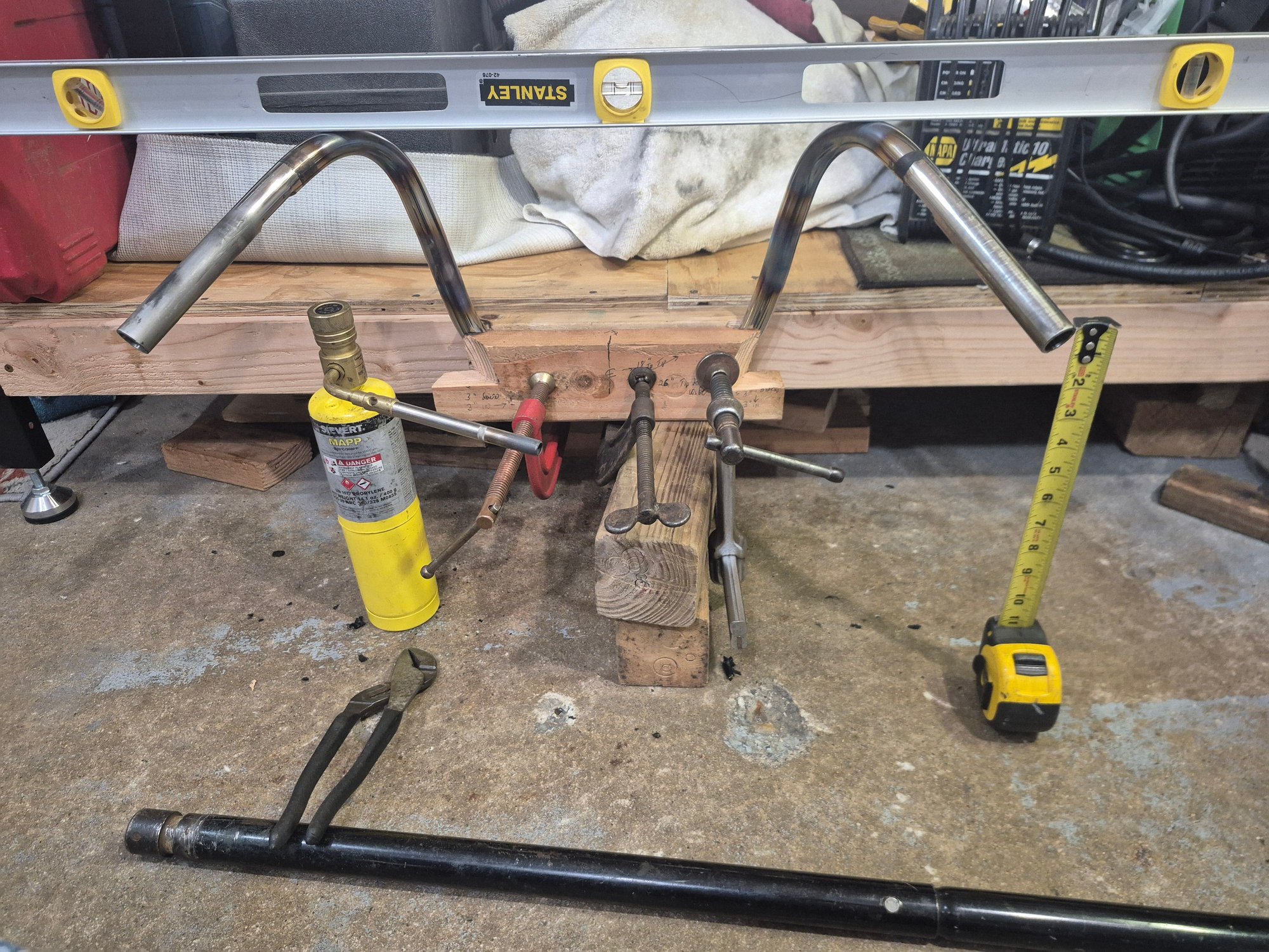

First Step complete.. rigged up my own Vice with support and with some map gas I was able to heat the risers to pull in the ends of the Bars 3" on each side which give me a total of 26" on center.. OEM was 32".. Then again I heated them up at the Benz and I got 3" drop over to stock setup. The stock setup was at 90° to risers so this should work well and I'll get them cleaned up and powder coated.. Then I can throw them on.. It's getting there. By the way these are a 1/2" less drop than the ones I bent on my Dyna..
Remember "Necessity breeds Engineering, Not Ruubing" You know Rube Goldberg.. lol. Walla,10" Buckhorns..

The wrist angle of the bars is based on your front end line.. The risers on the bar should run parallel with the front fork tubes (in line with).. This sets the proper angle for the wrists..
