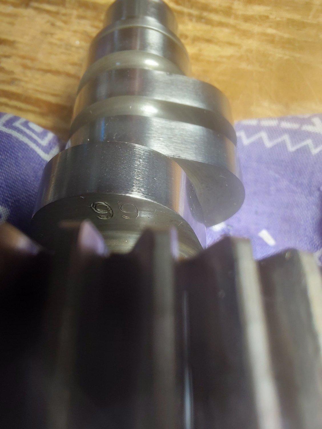

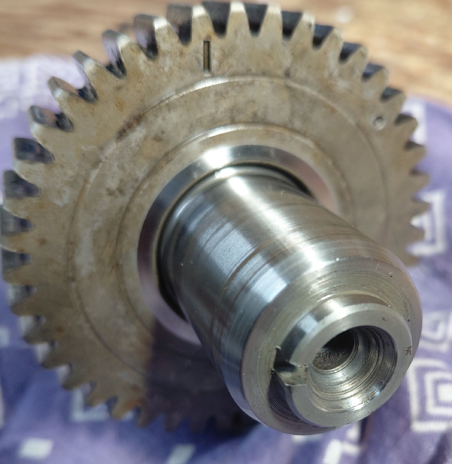

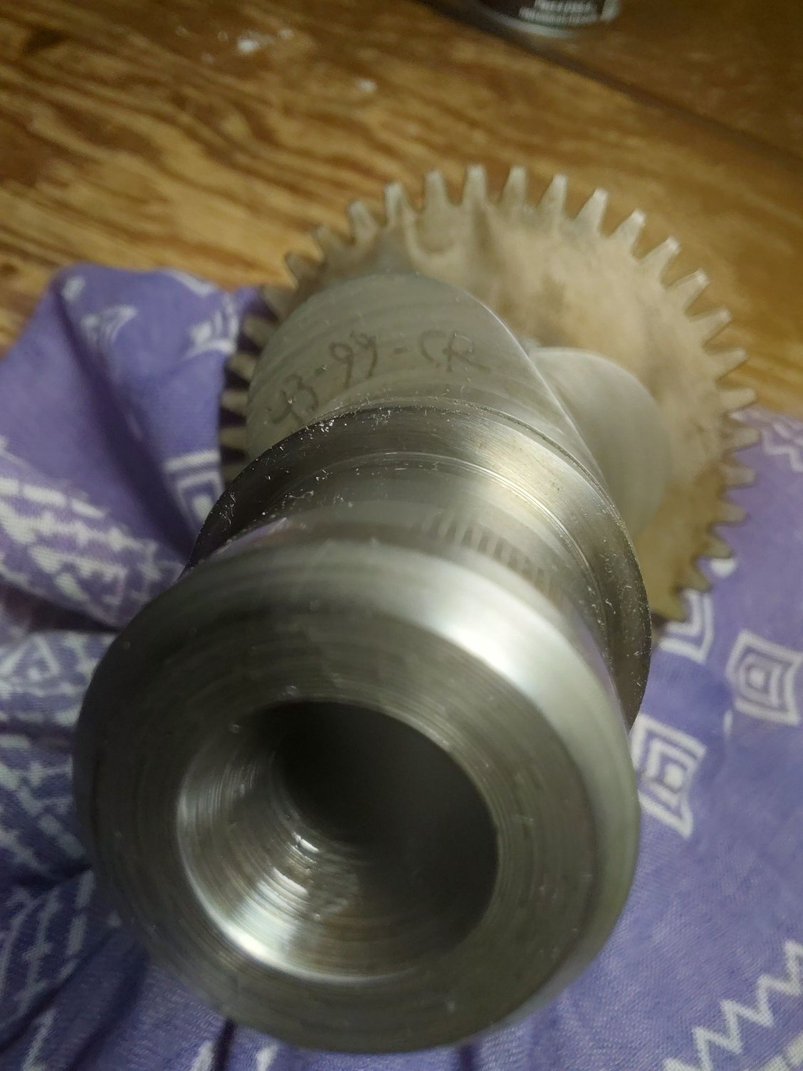

I was told this was an Andrews cam when I bought the bike. I need to know what it is so I can move forward with some performance work. I always thought Andrews cams were plainly stamped on the inside of the shaft, but this one is not. It was in a 96 FXD along with Crane ignition module, screaming eagle exhaust, re-jetted CV carb, and some type of aftermarket intake set up (don't really know what).
It has a number 7 stamped on a raised part of the shaft next to the gear, a Stamped 66 or maybe 99 on the inside of the lobe closest to the gear, and hand etched "43-99-CR" and "FP3102" or "FB3102" on two of the outer lobes facing out.
What do I have?

Never heard of it. In my database of cams, the number 3102 is for a Twin Cam motor made by Competition Cams.
A photo of all marks might help.

It's a Crane Fireball 310-2 cam, sometimes referred to as a 310 2

Thank YOU chopper man! Makes sense because it also has a Crane Fireball ignition. I think the adjustable push rods are Crane as well.
Anyone know anything about this cam compared to a EV27 or a Feuling Reaper 543?
