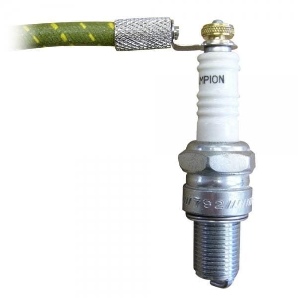

I customise my '87 EVO, to an old school style, and want the spark plug terminals as in the picture.
After doing some research, the situation is as below:
Champion RN12YC ............ non removable top nut
Autolite 4265 ....................... non removable top nut
NGK BPR5ES ..................... removable top nut
Autolite 64 ........................... removable top nut
I have just bought the NGK BPR5ES ones.
Marcel

That terminal looks like vibration from the engine will cause it to fail and break off at the 90 degree bend. You had better carry a couple of extras.

Looks like something that belongs with a Delorto or Velocity stack for a weekend bike show only kinda chopper. Not recommended for performance or trips over 25 miles in my opinion….

Not being critical, just realistic. Those spark plug terminals will not last very long.
