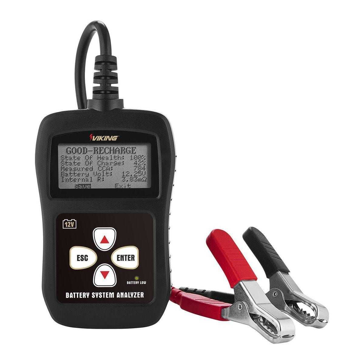

You can buy a modern battery tester for $40, they will tell you far more than a traditional resistive load tester...well worth it if you have a few vehicles.
This one is from Harbor Freight, mine works well and is also handy to see if the repair/desulphate mode on my Noco charger did any good on an older battery (sometimes it does)

I'm certainly no expert on this, but my feeling is that the old style (huge) carbon pile resistor battery testers gave more reliable battery tests than the new (and much cheaper) testers. This is not to say that the new testers aren't worthwhile. Even Interstate Batteries (at least our local one) are using the new small testers, though I expect not the $40 ones.
