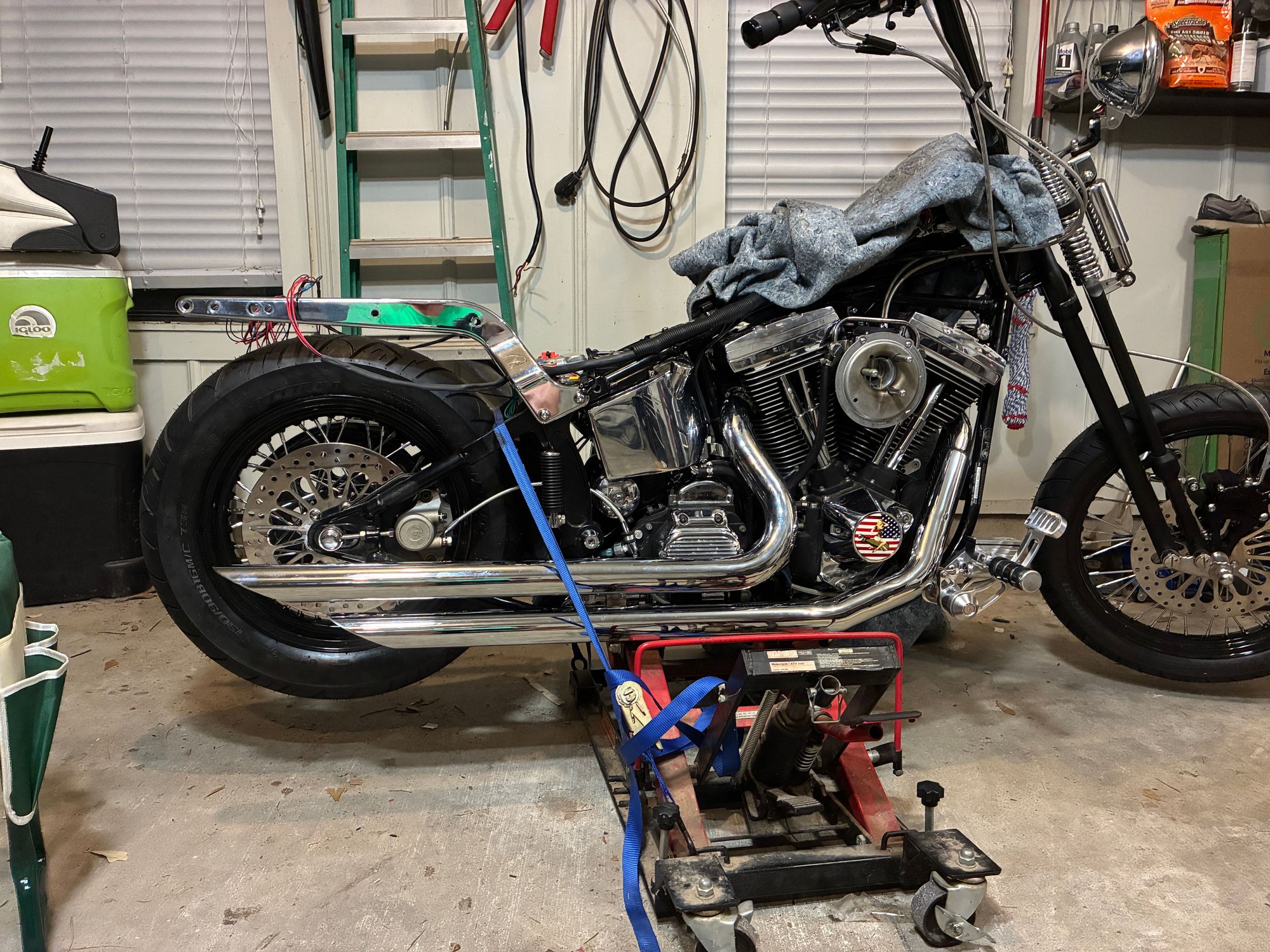

Milestone tonight! Got the pipes on. Still need to install the heat shields and baffles. But, after fighting that rear nut on the rear pipe, I was done for the evening.

Major milestone today. I made a makeshift gas bottle and fired her up! After correcting a wiring issue, she ran great. I still need to probably raise the idle slightly. It might be too low. You can hear it in the second video. I still need to install the baffles and heat shields. Also waiting on the tank and fenders from the painter. But dammit she is alive!
