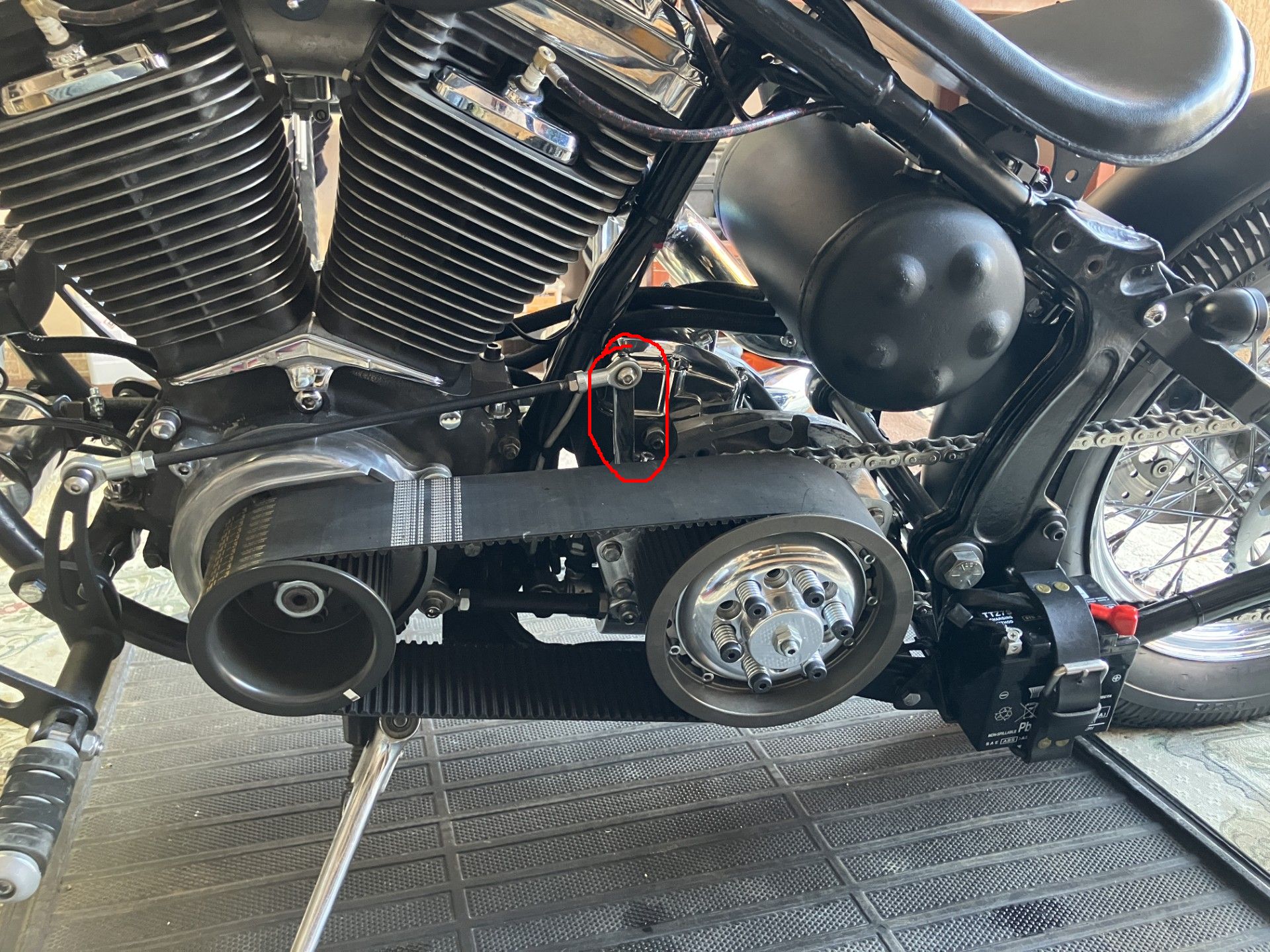

I have just installed BDL open belt and dry clutch. Before, I had the stock system, for an '87 softail. With the stock system, I could find neutral only from 1st gear -> neutral, with engine on, but it was ok.
With the BDL kit, I ride only 5 km, but not possible to find neutral with engine on, whether I'm in 1st or 2nd gear. With engine off, there is no problem
The adjusting screw, on the left side of the tranny, is half turn back, after bottoming out.
The free play at clutch lever is around 2 - 3 mm.
When I pull the clutch, the bike completely stops. But, maybe there is some clutch dragging that will not make the bike to move foreward, but will make hard to find the neutral...
As I saw into other posts, I'm thinking of lengthening the gear shift lever on the gearbox with about 1 inch. In this way, the search for neutral will be smoother, more precise.

Pull the clutch and check the steels. Make sure they are flat. Make sure you have the thick plate at the furthest inside. I've seen BDL steel plates that have a dish shape to them. It occurs when they they die stamp the plates. Also on that clutch, it's not a good idea to stop in gear. The dry clutch heats up quickly and drags..
Also make sure that the springs slip nicely into their holes. They can be tight which makes the pressure plate move unevenly.
