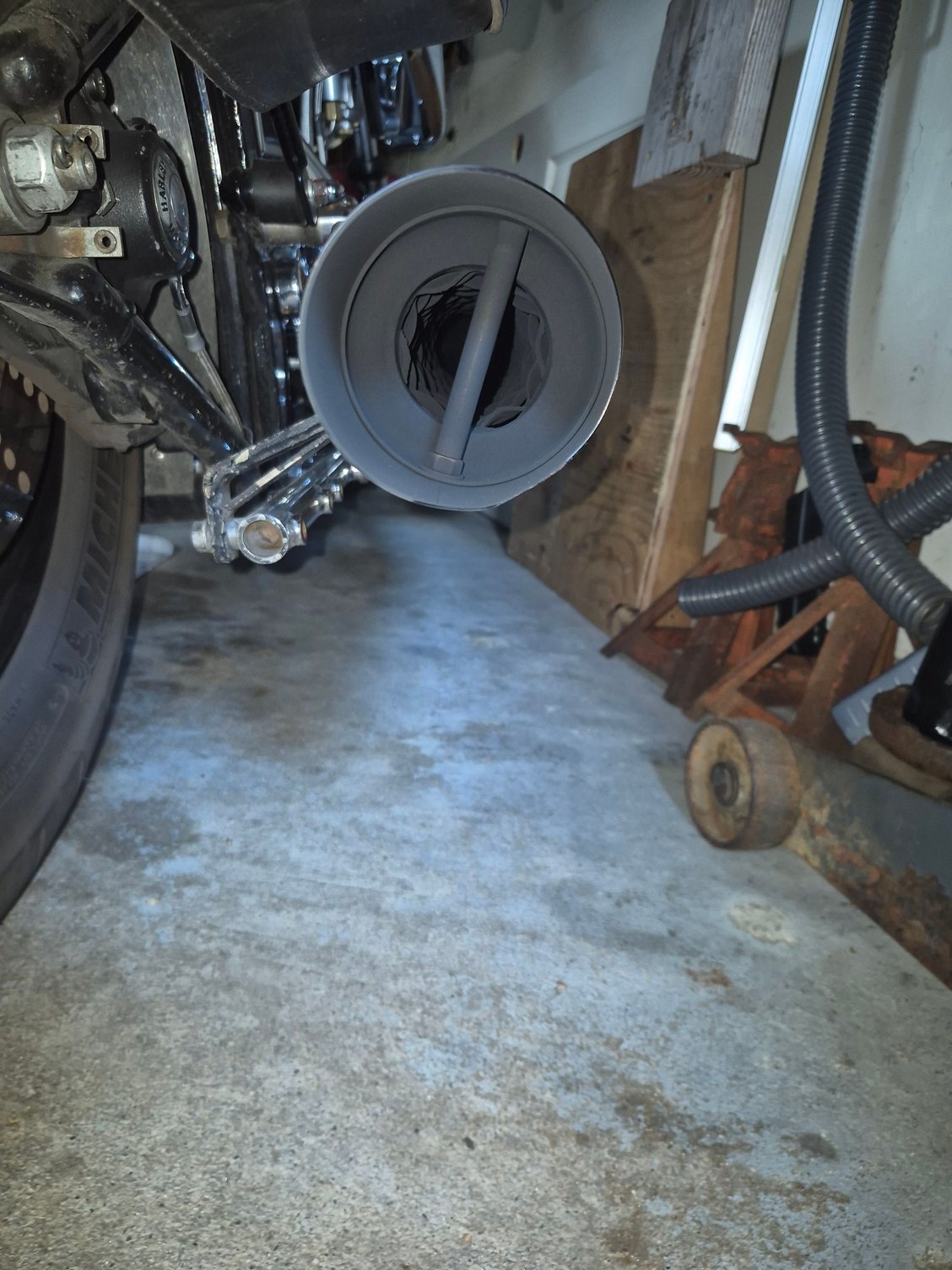

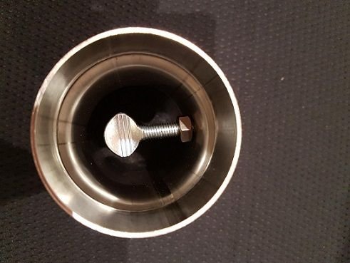

A fiberglass wrapped louvered baffle will give really good all around performance with a nice tone but not ear cracking and if it's too quiet you can always remove the fiberglass.. As for pre drilling the pipe, I wouldn't do it till you have the baffles in.. To help with Reversion you can always install a bolt that goes the full width of the opening on the pipe where the screw would go to secure the baffle.. They are known to interfere with the atmospheric pressure wave coming back up the pipe when the exhaust valve closes991.. Not a 100% fix but does make a difference..
EDITED: If possible I would try to install the baffles 2-2.5" from the end of the pipes..

/\ This all the way. Torque cones don’t work at all for shovels… like at all, but oddly enough they do make a small difference or help with reversion with an EVO… All that said, do as Hotrod98 says above. This is your best balance. Personally I’d buy two sets of baffles. Wrap it tight for a deeper sound, wrap it lose for a less deep sound… but take the first set and start cutting them shorter. Experiment an inch at a time all the way down to 3” long.. then whatever sounded and worked the best, cut the second pair to that and re-wrap.
In the above scenario, Bob chose the best baffle with that dividing bolt at the end. That bolt is what you want. If you buy baffles without, you can add a 3/16 bolt across but that bolt is the real key for reversion, over baffle design. With baffles “just holes” are better for midrange. Flared sticking into the exhaust pressure path with help bottom end while sacrificing top end. Pick your compromise, you don’t get both. It’s very Subtle so not a big deal though.
One last thing… with pipes that big on a motor that small, hopefully they are at minimum 36” long? If you’re willing, tape one end shut with duct tape on each pipe and poor water into one pipe right to the tip. Then very carefully without spilling any poor the full pipe into the empty one and see if they are identical length (volume). You can cut the longer to match the shorter and gently smooth with a fine file.
