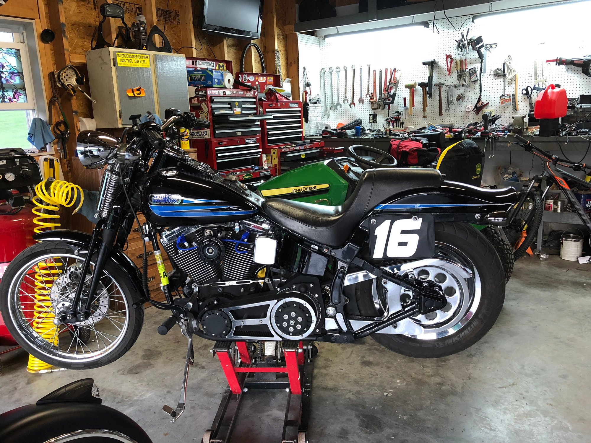

pic just cause I can.
Class winner in Evo
Class winner in Evo
