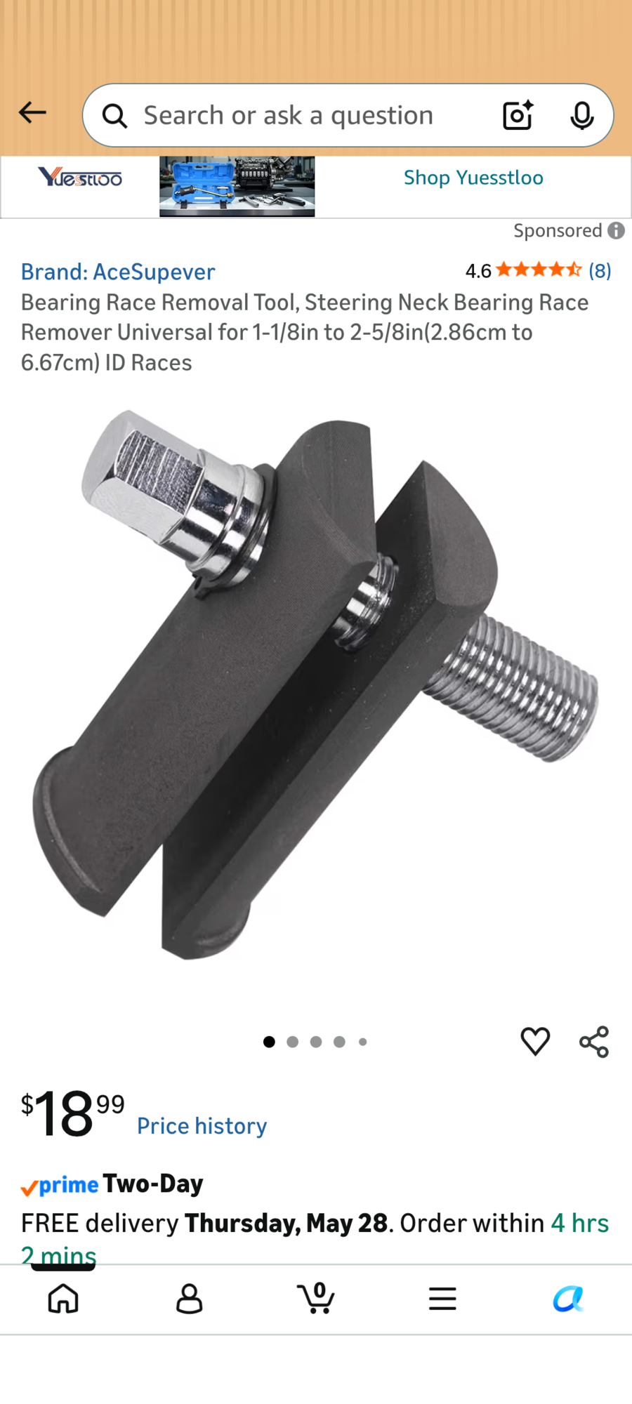

This steering neck race remover also works great on wheel outer races.
