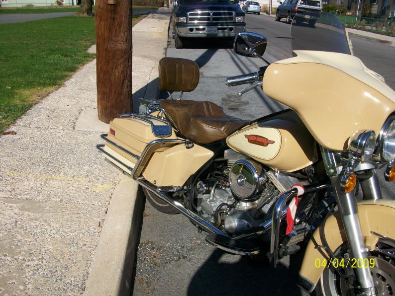

i have a 1984 FLHTC that was ordered without the radio new
i'm wondering if a fairing from a newer bike would work on mine
what i'ed have to change to get a 94 fairing i'm looking at on ebay
to fit looks like it has the same style speedo as mine

Is that 11k miles accurate ? How about a picture of the whole bike ? Nice color

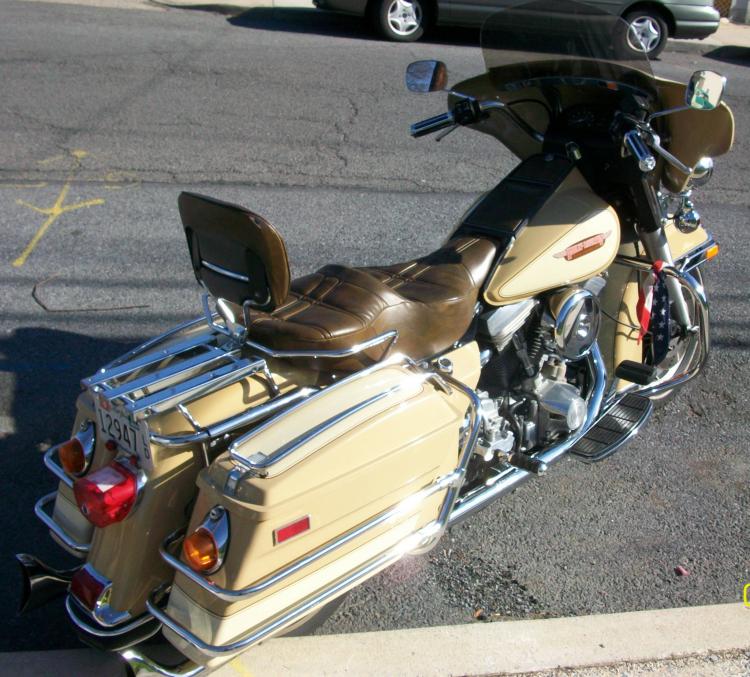

yep right miles, i have the right air box (canned ham) and all the right pipes. have the tour pac ,pass floor boards. and some other stuff for her in my house

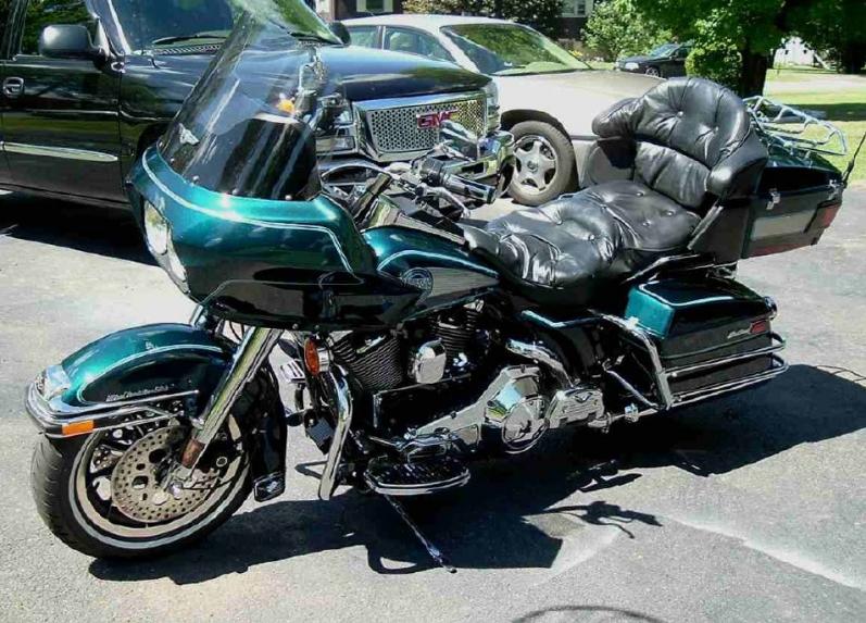

What would be much easier for you would be to add a tour glide fairing from the 80's or 90's, if you dont mind the dual headlight look. I converted my Electra glide to a Tour Glide fairing, and there was alot of wiring changes involved. Can be done, but alot of rewiring.

I dont think that there was an inner fairing until 86. There was no 'radio option back in 84.That was the first year Harley offered a stereo. The inner fairings for '88 to '96 like in your pic are hard to come by. I sold mine of ebay for a good price. Your gauges will fit that fairing, like I said I went the other way with the swap. There are some little parts that are different, like the odometer reset **** and such. There was a different fairing for '86 and '87, which is even harder to find.
