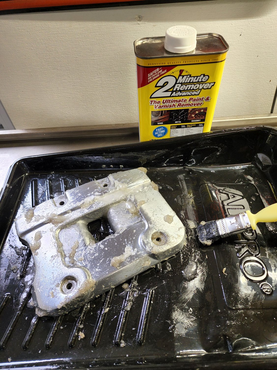

Trumpet's Avatar
Trumpet
Joined: Oct 2019
Posts: 932
Likes: 592
From: Connecticut
Our government nannies have banned MEK from consumer purchase. Having to strip some clear off stock parts I'm happy to report the pictured stripper did a good job.
