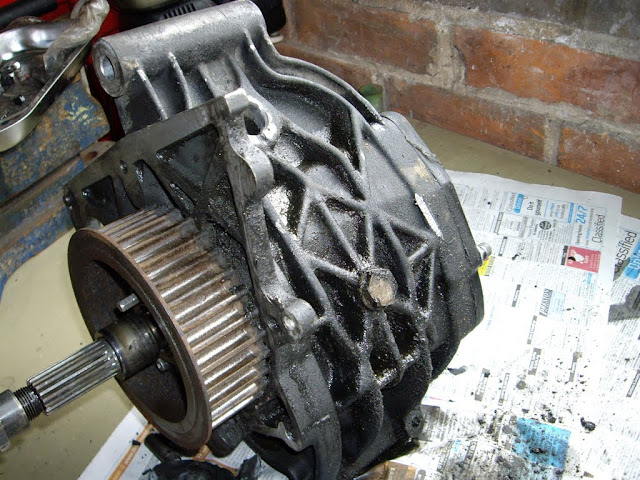

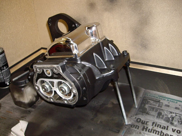

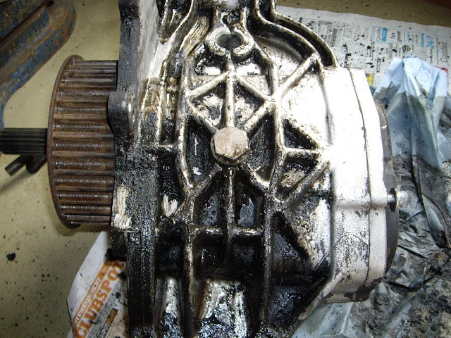

I stripped the transmission and engine casing with diy store paint stripper (wear gloves), wire wool, and an old tooth brush, then used brake cleaner to degrease.
The cylinder barrels and heads, I got glass bead blasted,just got one painted so far.
I used VHT engine enamel, gotta be better than the brush paint the PO used.
