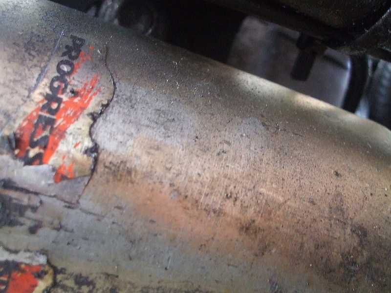

I had these Progressive shocks installed around 1995. I don't remember if they are adjustable and don't have any docs/adjustment instructions for them.
From the looks of the pic, are these adjustable? Do I just looses the bolt and rotate the shock? I thought I read in another post somewhere that is how some of the shocks are adjusted. If I adjust them, am I just adjusting the lowering/raising of the bike, the stiffness/softness of the ride, or both?
I remember when they were installed it lowered the bike by about an inch or so.

ok, I found my old receipt so I have my own question answered. I got these on 1/28/1993 with 22k on the bike. They were listed as WB4034G which is the 413 series of progressive shocks. For some reason 4034G means that they are non-adjustable, lower by 1", and gold colored. I paid $395 + an hour labor.
It looks like an eye-kit was available, not sure what that would do for me, part number 30-5047c/g.
I don't think Progressives are rebuildable and they don't make shocks for softails from 84-88 anymore so I am considering Works shocks. anybody have any opinions on Works or any other softail 84-88 shocks?
