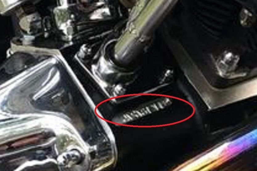

I agree they could be aftermarket cases. Maybe Delkron? Is the engine number a mirror image? And is it in a recess? Here’s an example.
Also check the left case for markings.
Eric
