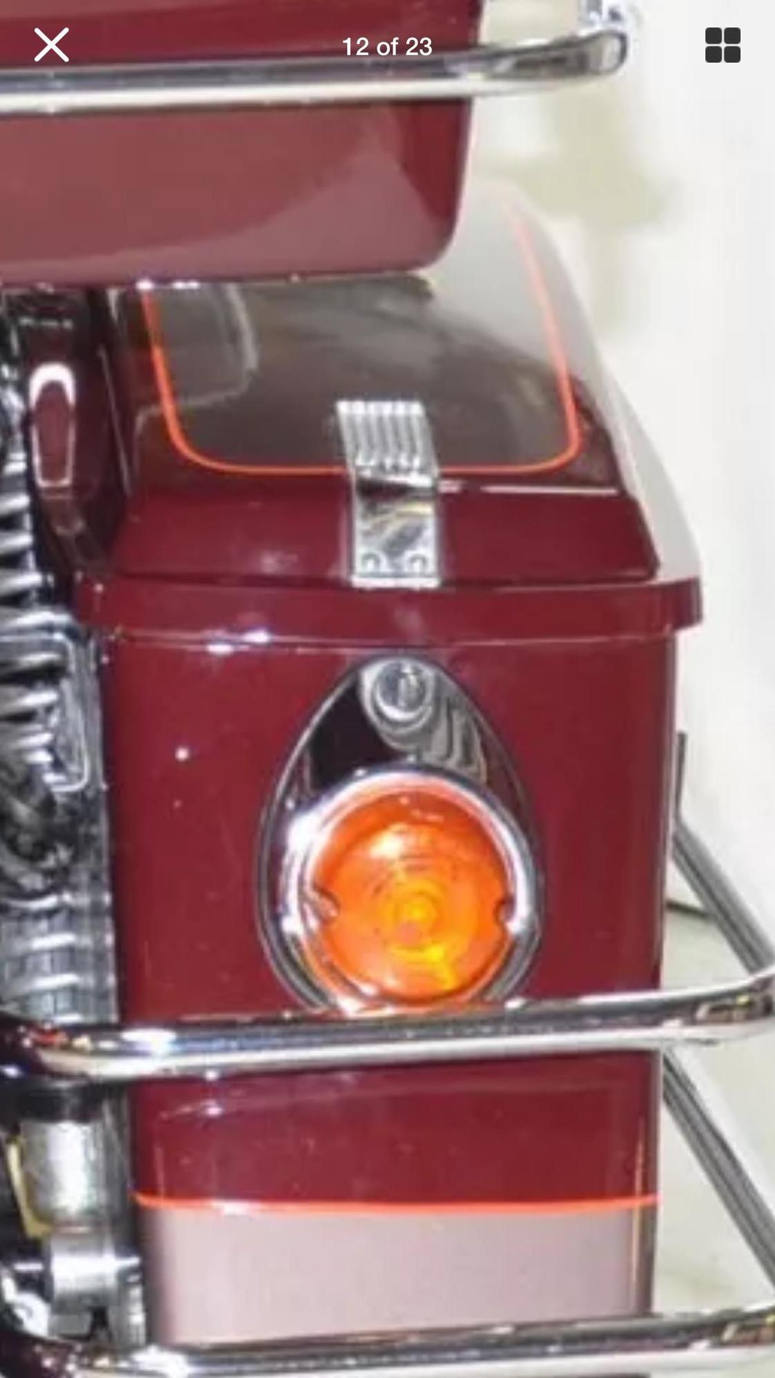

My 84 don't have those on the bags just a push button in the turn light that's a pita

Like these? Hours on google and I have never even seen a photo of this style. I would love to find NOS replacements.

You can find part numbers for your bike here, which may help a little. I do wonder if those lights are genuine Harley, a factory accessory, or aftermarket, I certainly have never noticed them before. I suspect they are long discontinued.
