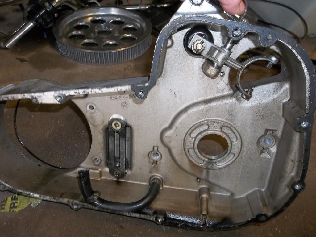

Holy Crap... been chasing this issue now for 11 or 12 years.
Over that time I have replaced all kinds of things from the starter with an All ***** unit, new solenoids, new wires, new relays, new battery and ground cables, you name it. I thought maybe I was not getting enough cranking amps, so I replaced battery with a few high CCA varieties over the years and landed on this Anti Gravity unit I have now. Issue still was persisting, but I was living with it. Intermittent RunOns and weak cranking just kept plaguing me. Over this time, I turned 500K+ on the original power plant and she was so tired, that I swapped out for an S&S V80. I also wired in a Ford Starter Relay in to the circuit to prevent RunOns when the bendix is stuck on the ring gear (can happen with low battery or other causes).
I have tried so many things and maybe just maybe I have finally found the culprit. I was back in there over the weekend and found that the Starter Clutch (aka bendix or starter gear) was cracked. I checked my service log and I can't find the last time I replaced it. I know it has been replaced a few times since 1987, and I was pretty sure I tried replacing it to resolve this issue before... but maybe I missed it? I can't remember.
I rode all weekend, and she fired up like a new bike every single time. Maybe... just maybe... I have it licked. Or maybe not... only time will tell.
