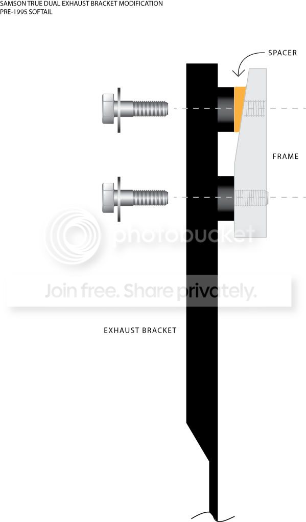

Any of the duals will fit, but you'll have to drill and tap your frame on the left side for the mount. I went with the Kerker 2 into 1 fishtail for my 92.

@Hoghead5150 just as Tailbreaker said any duals will fit if you tap the left side of the frame.
Here is a technical drawing done to show how easy it is for our duals. Not sure about other systems muffler brackets but most are similar.
Hope this helps.
