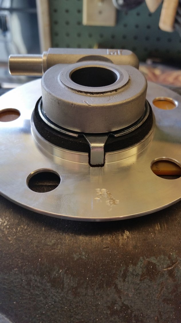

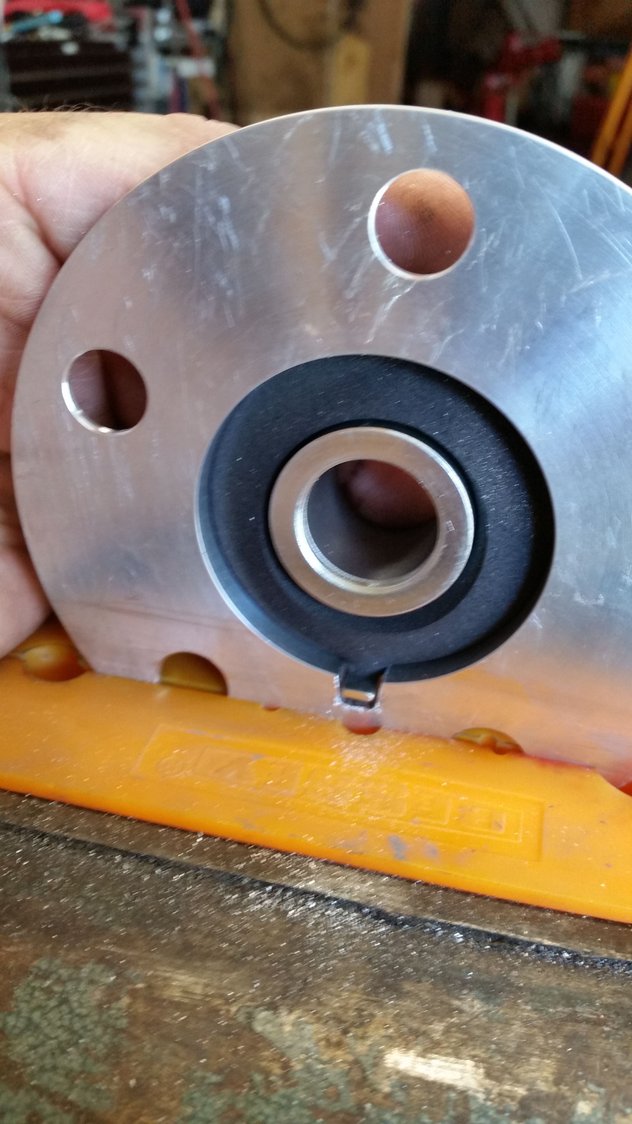

Default Update on speedo
Well, after about 25k, I've gonever through 3 drives.. the "tang" keeps breaking off.. I've done 2 things to remedy this.. 1st was to add a rotor spacer to add support and get the "wheel" surface closer to the drive for more support. Think of it as driving the tip vs the entire length.. well, that didn't quite work by itself.... It broke in Delaware, on the way to grab a Philly in March....... Luckily the Walmart next to the hotel had beer and JB Weld! So, I added a couple dabs of epoxy to secure the drive on two sides, at the tab and 180deg from it.. worked perfectly and even came off when I took the wheel for a new tire.. so, it's almost a "hack" but I'm fine with it, aint dicking with it anymore, heading to Maine Friday... hope the info helps!
Had to create the groove with a dremmel

Yea, it's really just the side loading.. It's really a bad design, the way I'm using it.. by driving one point, it tends to **** the rotating plate, combining the leverage and movement, it just doesn't hold up.. each time it's broken, I've been on a trip, using cruise control.. so, I've had to improvise.. I honestly believe this is the most realistic fix and that there's nothing else wrong. It and the cable are lubed and turn freely.

So, here's a pic of my "spacer" with some JB Weld hastily applied last night.. I'm not happy with how messy it turned out, but leaving tomorrow, it is what it is..

You may be able to tell from the pic what I was trying to say about the wobble effects of the sensor. In fact, with this spacer and the "right" foam shim to take up the slop and support the ring, it may not need the epoxy at all.. I just haven't found the right piece yet..
