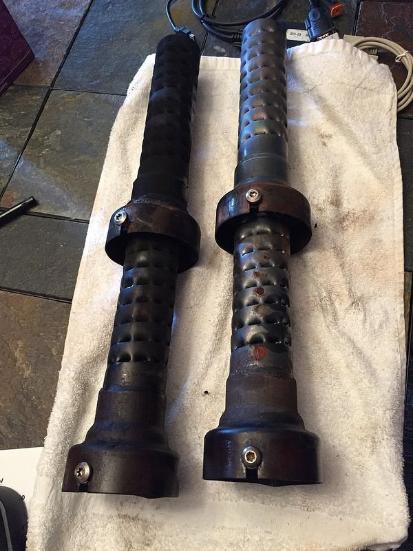

Well, I wanted to lower the sound a bit, so I bought 2-1/4" baffles. I *thought* I had 2" baffles in there. So I took the baffles out and found this. See anything missing?
No big deal, as I was planning on putting in new baffles and repacking these anyway. Now my job is that much easier! There's NOTHING in the pipes or on the baffles. No packing material at all. Guess the previous owner pulled it all out.
But darn it, wouldn't you know that while I *thought* I had 2" in there (so I ordered 2-1/4") what I had was 2-1/4" all along! So now I have two sets of 2-1/4" baffles. I'm returning the new ones. And fortunately, I already ordered repacking material. So just for amusement, I fired it up, baffle-less. Here's a vid:

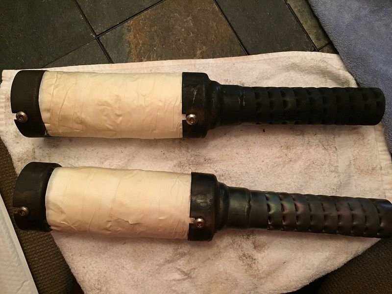

So here are the baffles, all nicely repacked. I used the repacking material from Drag Specialties and repacked them per Rush's instructions. No chicken wire (ha ha). The baffles are in there snug, so I think the packing material will stick around a while...
Rush Big Louie 2-1/4" baffles, repacked with Drag Specialties' repacking material.
Installation went fine (one I remembered to use a little WD40 on the sides of the baffles) and here's the finished sound. Not a lot different from the original sound w/ baffles but no packing. But perhaps a little less metallic sounding. Smoother. I wouldn't say deeper, but fuller. And they do bark a little more on hard acceleration. And they *might* be a little less on decel popping. But I still need to retune to work on that.
https://www.youtube.com/watch?v=TizuY9UNshk
It sounds so much better, you really notice it when you listen to your prior sound clips. Without the baffles it just sounded like you took some down spouts off your house and bolted them on, they were so hollow sounding. With the baffles and no packing it was a little better but still a little tinny. With the repack, it's a lot nicer tone.

For a somewhat stock motor the wrap on the baffles will definitely make a difference in low end. Also they do sound a little deeper as they should... Sounds good. Ride on Man....
