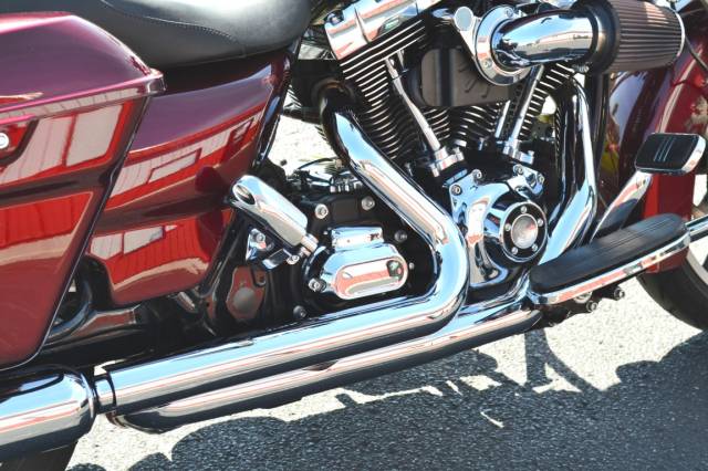

If you are concerned that the PowerDuals may scrape at extreme lean angles I would take a look at the Jackpot 2/1/2 head pipe or the Jackpot SuperDuals. Both of these systems would work very well with Rinehart mufflers and would offer excellent performance and sound, with no issues with ground clearance. This combo would be right there performance wise with a 2/1 systems, we also carry each of the three 2/1 systems you listed and you can find dyno charts for them on our website on our Dyno Charts page http://www.fuelmotousa.com/p-33193-dyno-charts.html
Here is an image of the Super Duals
