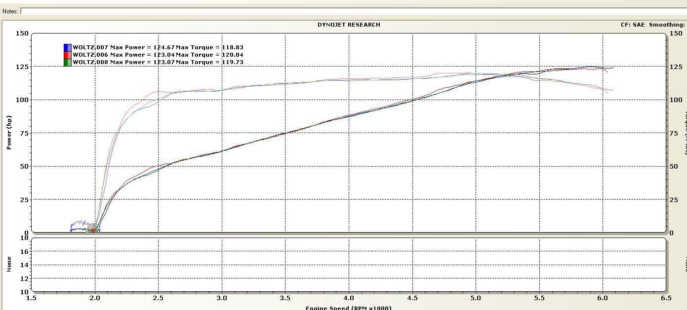

Staggered duals 640 cam.
Crossover can help but proper design of a 2-2 can be give the desired results.

Very nice. And this is compared to ???
But, yes it is a nice curve.

What do you need to compare it to? You simply stated that that TDs won't have any low end torque.

Yeah you're right.. That one I don't have a direct comparison. This one is close. Lower power was a thunderheader compared to staggered duals. The staggered duals did have a small 1 inch cross over at the muffler. You got any runs to show otherwise?
