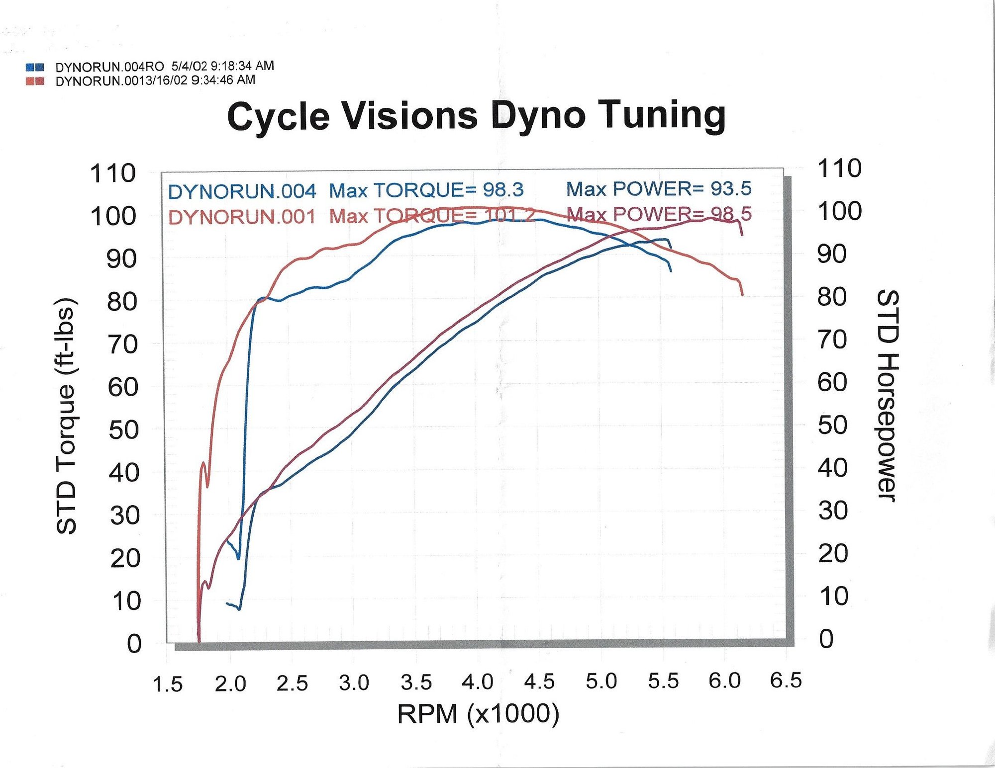

The problem is that many compare bagger TDs to a 2 into 1 and find that the 2 into 1 wins. As usual they are not looking at the whole picture..
Example.
Which one sucked here? A thunderheader over a stock head pipe and Cycleshacks on a 2000 fxdx. Later I traded the TH for Krome works arIII 2 into 2 and made even more HP.
