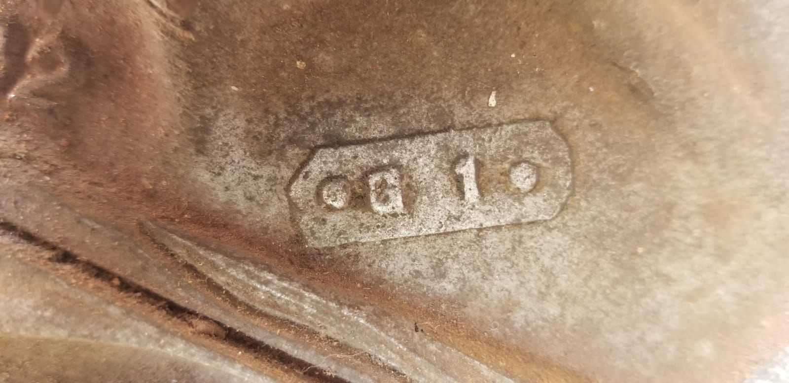

] Hi Eric!!!
I have that case that is marked as G 1, what month would it be? year 41?

G'day Luis and welcome to the forum. Date code G 1 indicates the case was cast in July 1941. Here’s an example for comparison.

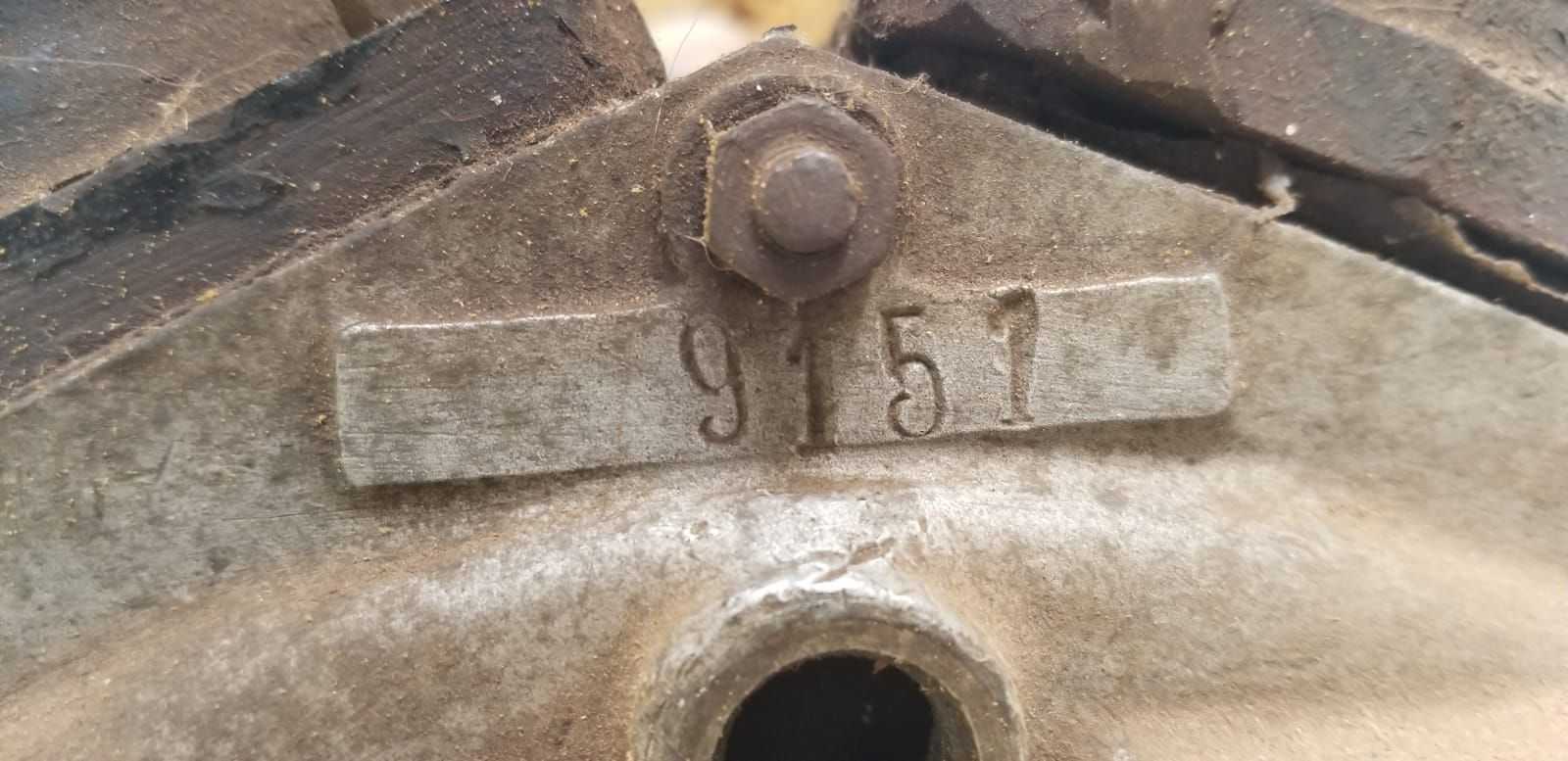

Hi Eric.
I understand everything you explain to me, except for one detail.
If I am correct, the belly numbers reflect the year in which the engine was assembled and my crankcase has a number 42-4059, which would mean that it was assembled in 1942 and in that year only WLA and WLC were assembled, how could they be assigned to WL, WLD, WR and G?.
Attached photo of the engine number.
The bike in particular is a project, I bought it incomplete and given the parts that I have to buy, I would like to define how I am going to restore it and the idea was to WLA type 1 because it has the belly number 42-, with the intention of recovering it, which don't get lost along the way
being aware that it will not be a 100 points, nor a matching numbers, just that Eric.
I appreciate your answer, I'm learning a lot and I appreciate it.
cheers
Old Mar 7, 2022 | 02:52 AM
Speeding Big Twin's Avatar
Speeding Big Twin
Joined: Feb 2009
Posts: 695
Likes: 394
From: Western Australia
Sometimes the BN reflects the year an engine was assembled but sometimes it doesn’t. Your BN looks consistent with stamping for 1942 models but it may have been stamped in 1941. (Remember your case appears to have been cast in July 1941.) Production of 1942 models began around Aug-Sept 1941 and some were military machines while others were not because production of most non-military model Harleys didn’t stop until shortly after the US entered the war.
For example here are partial photos of a 42WL and a 42G.
And even after production of most non-military H-Ds was halted, some were still available depending on approval by the authorities.
I think your SN boss has been altered. Compare its edges with my examples above. And there appear to be a lot of marks across the boss. Below is a virgin boss for better comparison. Notice its rounded edges and the overall appearance is rough-cast as opposed to the ‘flat’ appearance your boss has.
Because your SN is not authentic and your boss appears altered, I don’t think there’s any point trying to build the bike as a WLA. The original SN could have been WL, WLA, WLC, WLD, WR or G and even if we knew which one it was there still wouldn't be any point trying to build the bike as it was originally.
The SN you have now (9151) may have been state-assigned as a way to identify the engine. Or maybe somebody made up that SN and stamped it themselves. Did you receive any paperwork with the engine?

Eric, your explanation is clear to me.
Buy the project with a bill of sale, knowing that the SN is not correct.
They are surplus (both motorcycles and parts) of what were once motorcycles of the Paraguayan police. I have more in sight for purchase and these other options if they have their correct SN in WL form, years 45, 46, 47 and a lot of spare.
Now with the expanded information on your part with this last message I don't know which way to go and I don't want to leave the project in the dry dock. He was unaware of the production of civilian models in 1942.
What date code do those two examples have that you quote from 42WL and 42G?
Luis
