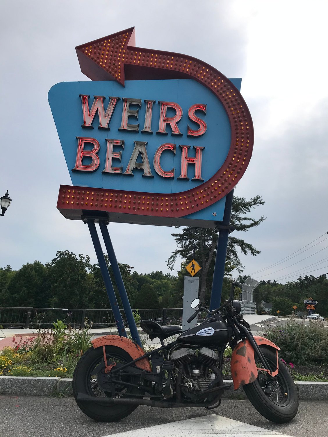

I had my 45 up in Laconia all week, took her for a ride every morning while my crew was doing the shower/coffee thing. Amazing how well she acted after 3 days in a row of doing 10-20 miles every morning. By the end of the week she was just happy. They want to be ridden, that is the answer to most issues with old stuff.
