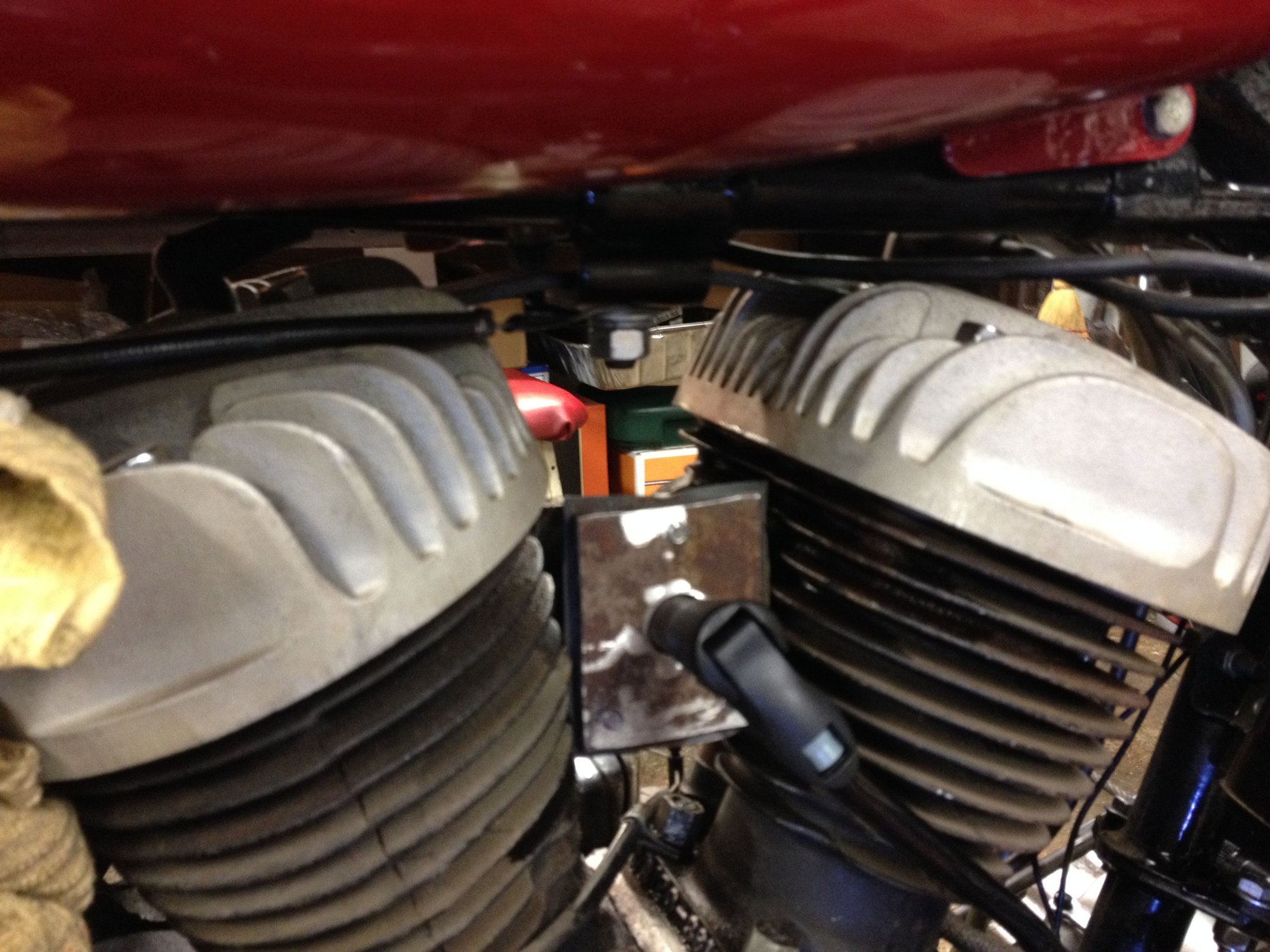

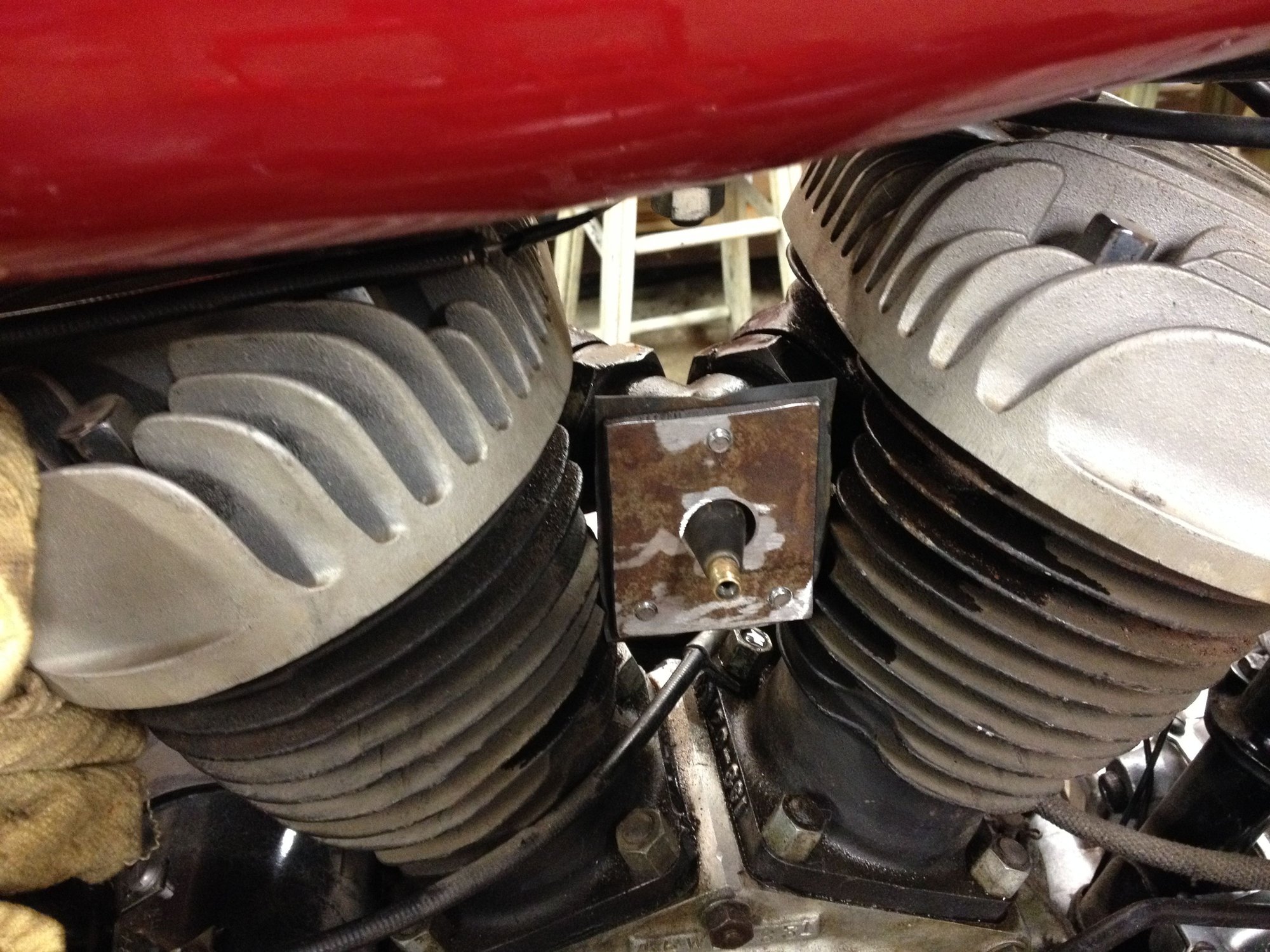

Agree with John, take carb off and perform a bubble test on manifold. If that is leaking, you will be chasing your tail forever. Solve that, then go back to the carb. If you did not do it, PEEK seals are the way to go, old brass seals do not work with 75 year old parts.
Simple setup I made. Cut up an old tube, made a steel plate from scrap that mounts to manifold. Get a good regulator that you can attach to an air source, 14.5 PSI is the magic number. Hold that for about 3 minutes while spraying everything with soapy water. ANY bubbles are bad, needs to be tight. No reason to add more air pressure than as noted, but it needs to sit for the 3 minutes. There is a guy in the AMCA Mag advertising that he sells them, but it really only took me an hour to make from **** laying around the basement.

I already have Peek seals in the intake.
I don't remember which way the taper is facing.
I get very good suction if I cover the carb opening while kicking and that seems to be the best way to start it right now.
I'll craft a test rig like Architect suggested and see what I see.
