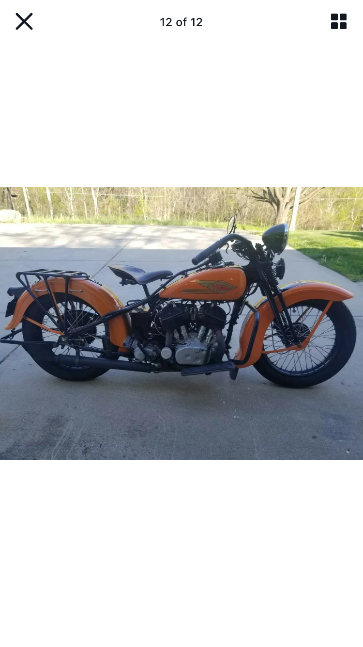

Default Pic of my VLD

CONDENSER, looks like your front springs are wrong or shot also…
