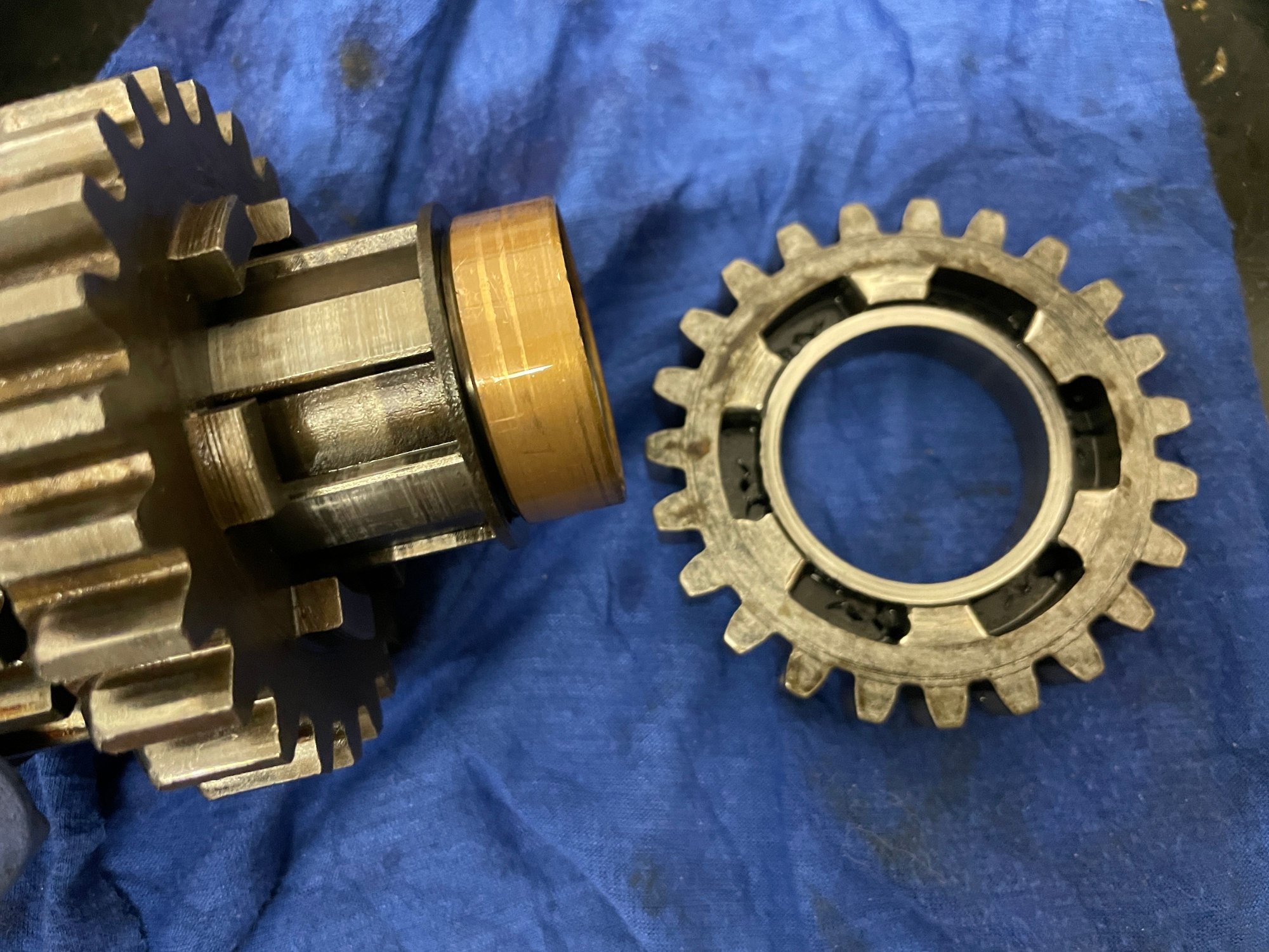

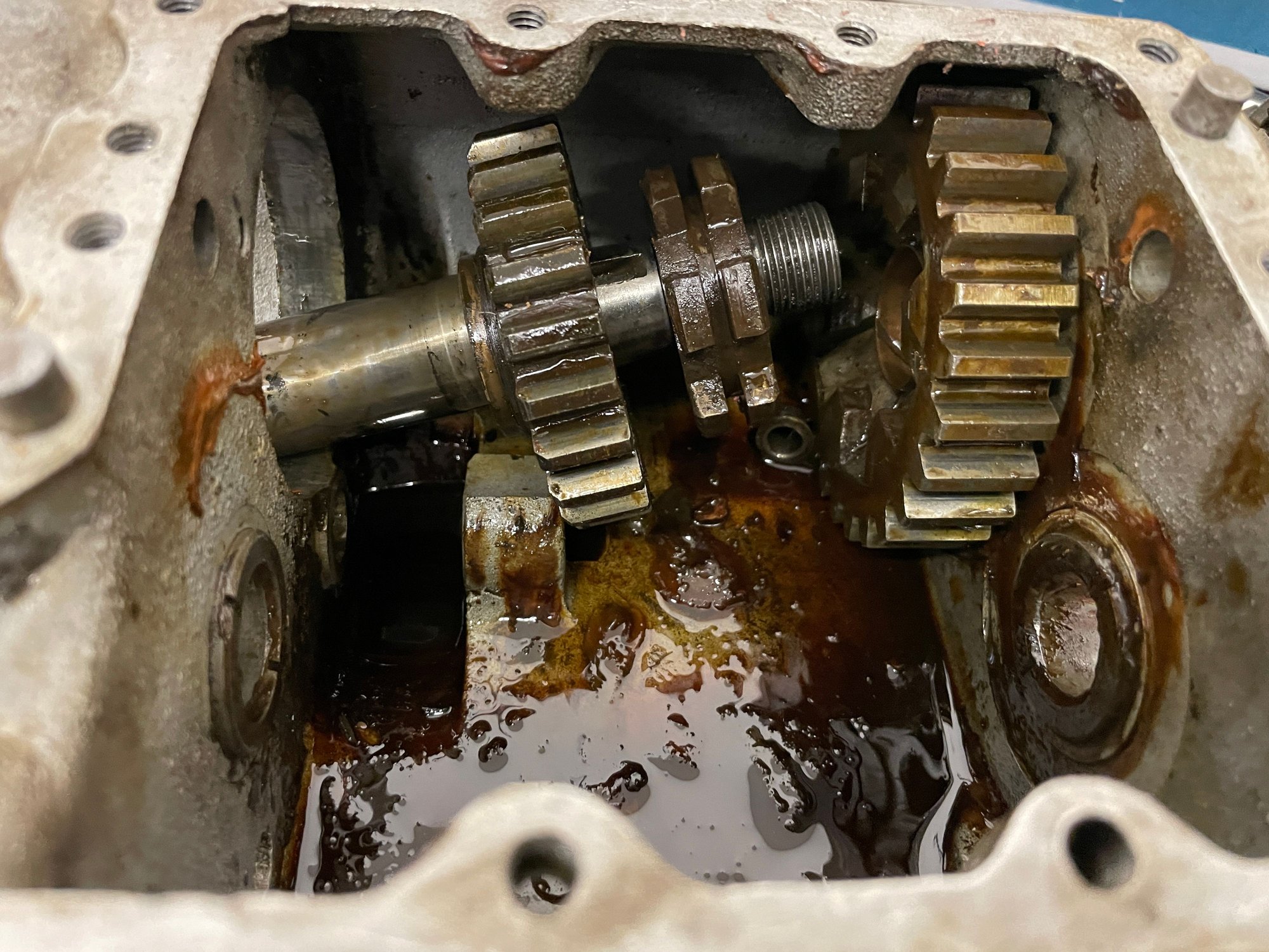

Please ask the seller why a trans allegedly bought new in 46 has a lid that wasn’t made until a few years later. Ask him why the lid has casting number 33-49 and not casting number 33-35. Lids with casting number 33-35 were cast as late as Jan, Feb and March 1949.
Also notice for the mounting bolt on the R-H side the insert looks bronze as opposed to steel? The change from bronze to steel occurred around late-43–early-44.
And ask the seller why the case doesn't have a boss for the vent nipple. A boss for the vent nipple was in the casting as early as May 39 as per the example below.
Eric

The seller wont have these answers, they went with the owner to his grave. I suspected the box was early but he has no idea about those details, he just knew it was a 3 speed and I needed it. The little bit of info he got came from a brother-in-law that inherited the empty house and all of his tools. The bikes that filled the house were bought by the seller (my friend) and the proceeds went to the sister of the owner. The sister had no contact with the owner for decades and he was an introvert after his wife died. I'll surmise that the top cover is from his 46 because every casting on that bike was polished, the cases included and what wasn't polished was chromed. I would say he just transferred it to the over-the-counter gearbox. The kicker cover could also have come from the 46.
The insert in the bolt hole isn' steel, it does look bronze.

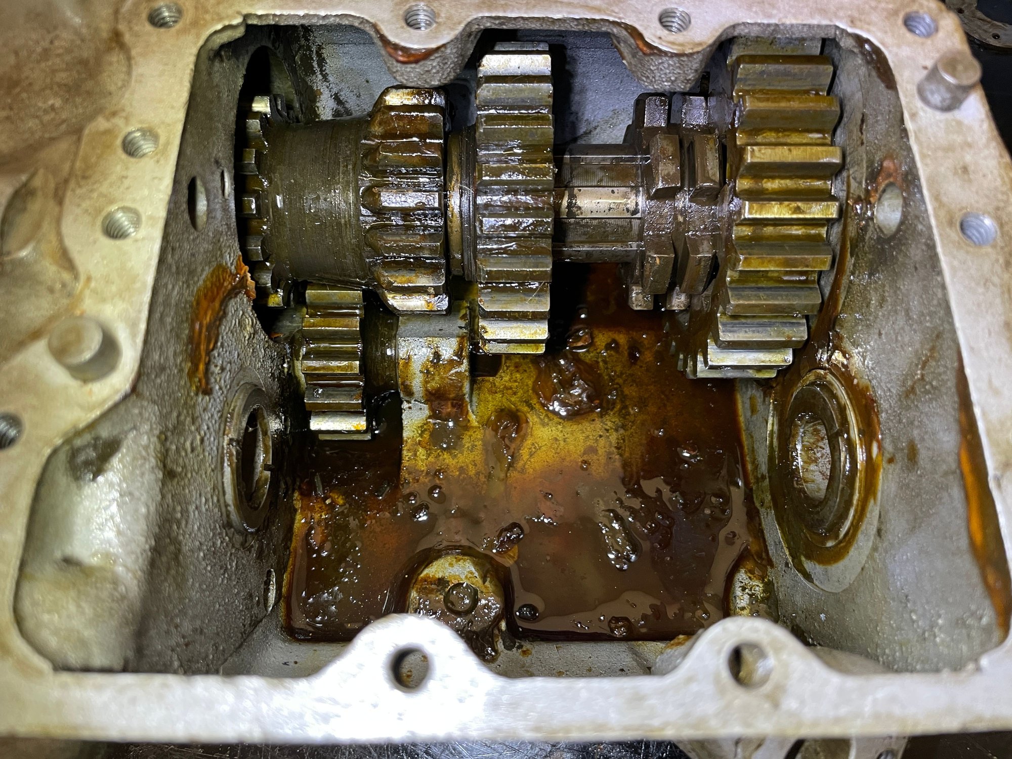

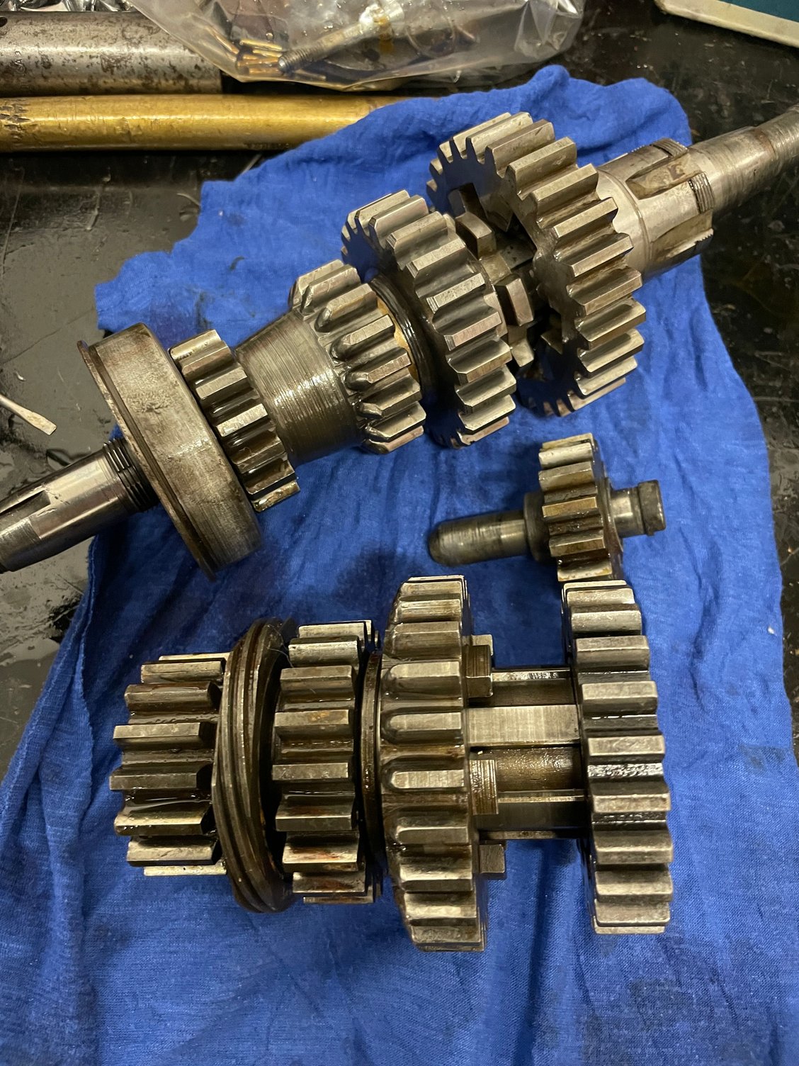

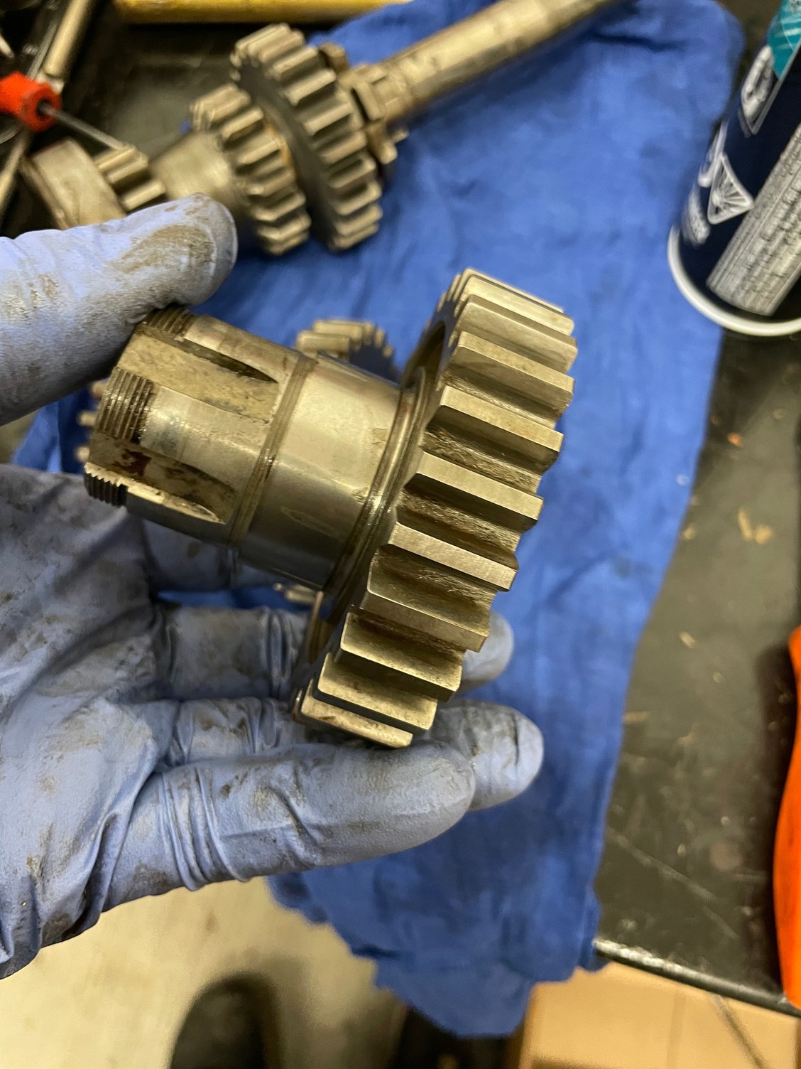

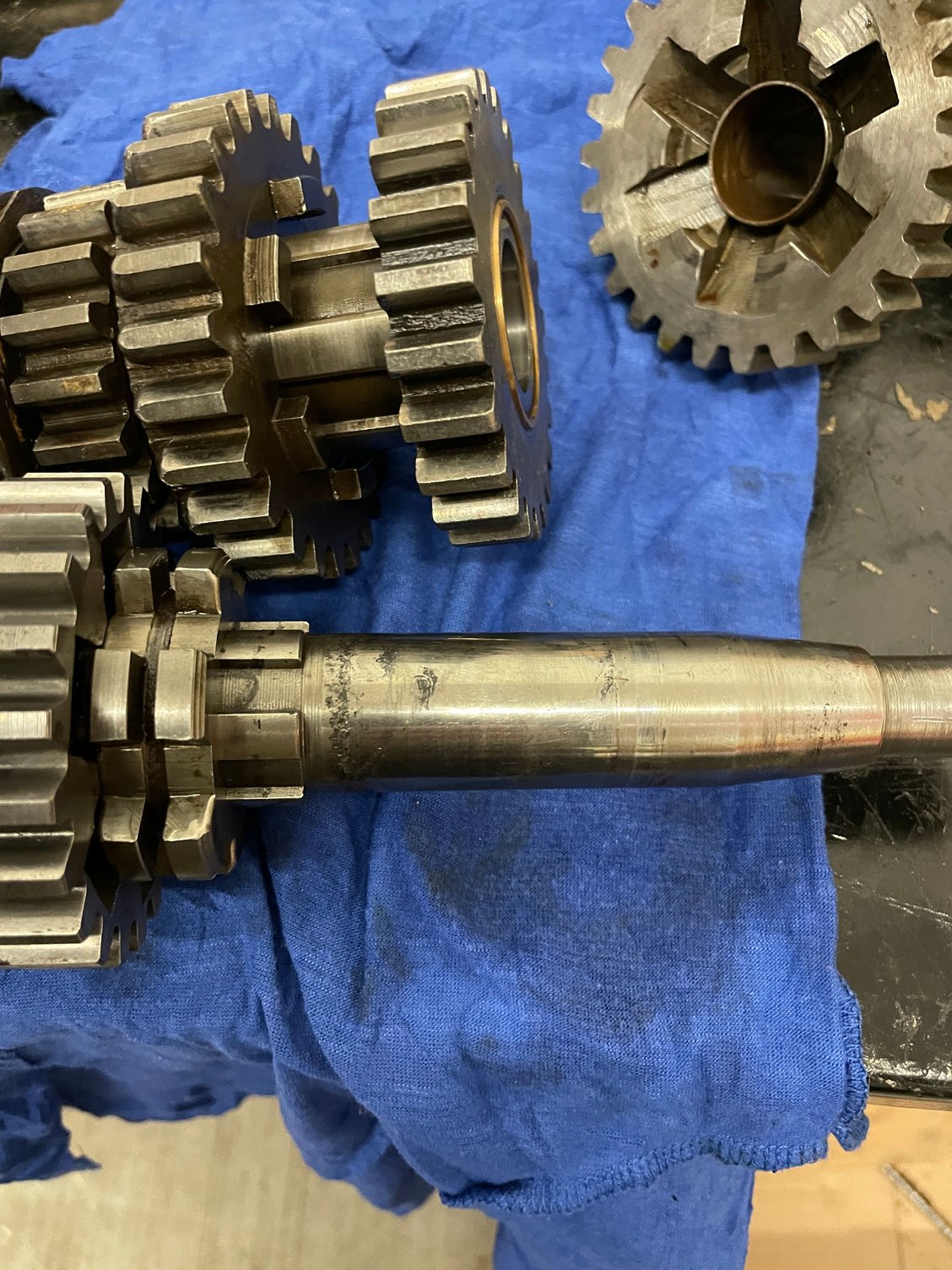

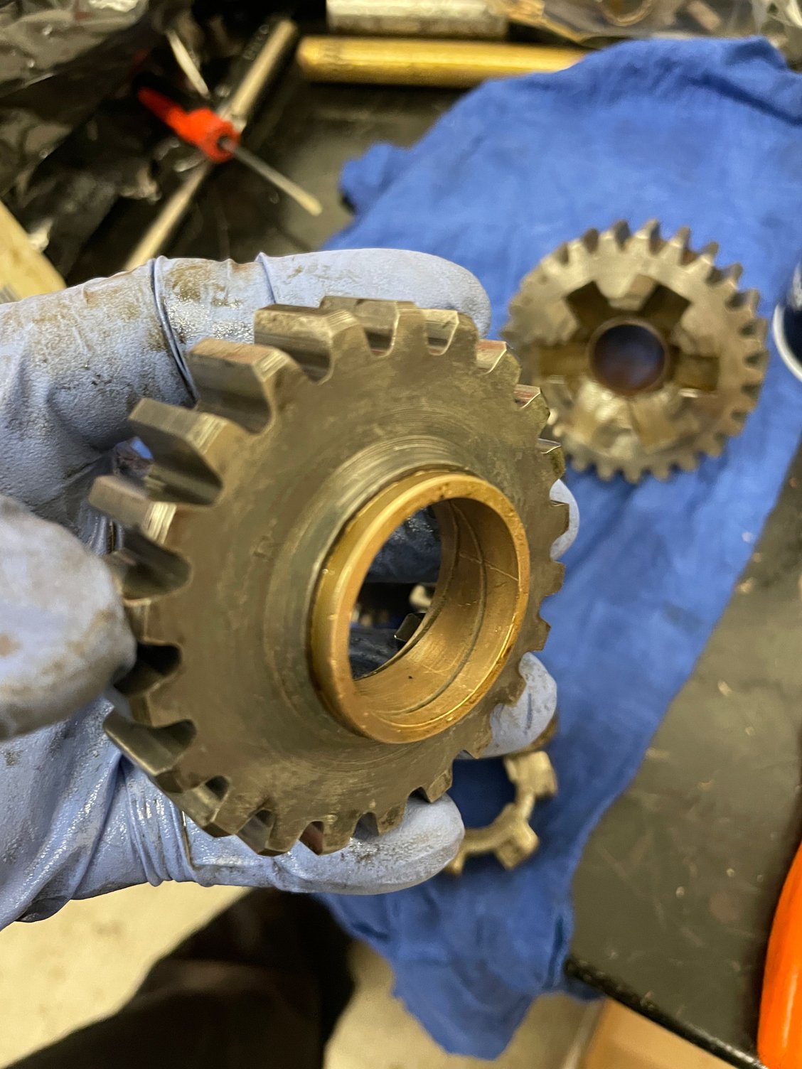

The seller said "just add oil and go". Seriously. After we popped the lid and could see old dried up grease and goo I had my answer but the gears looked okay which was my only concern.
After a quick cleanup in the parts washer everything looks good. Hardly any wear on bushings and the teeth look good, no pitting other than the dark staining you see on the main shaft which means nothing.
I wonder if 3rd is the same as 4th in the 4 speed boxes (haven't looked in the parts book yet). If it is I would like to get the one with the small lip seal.

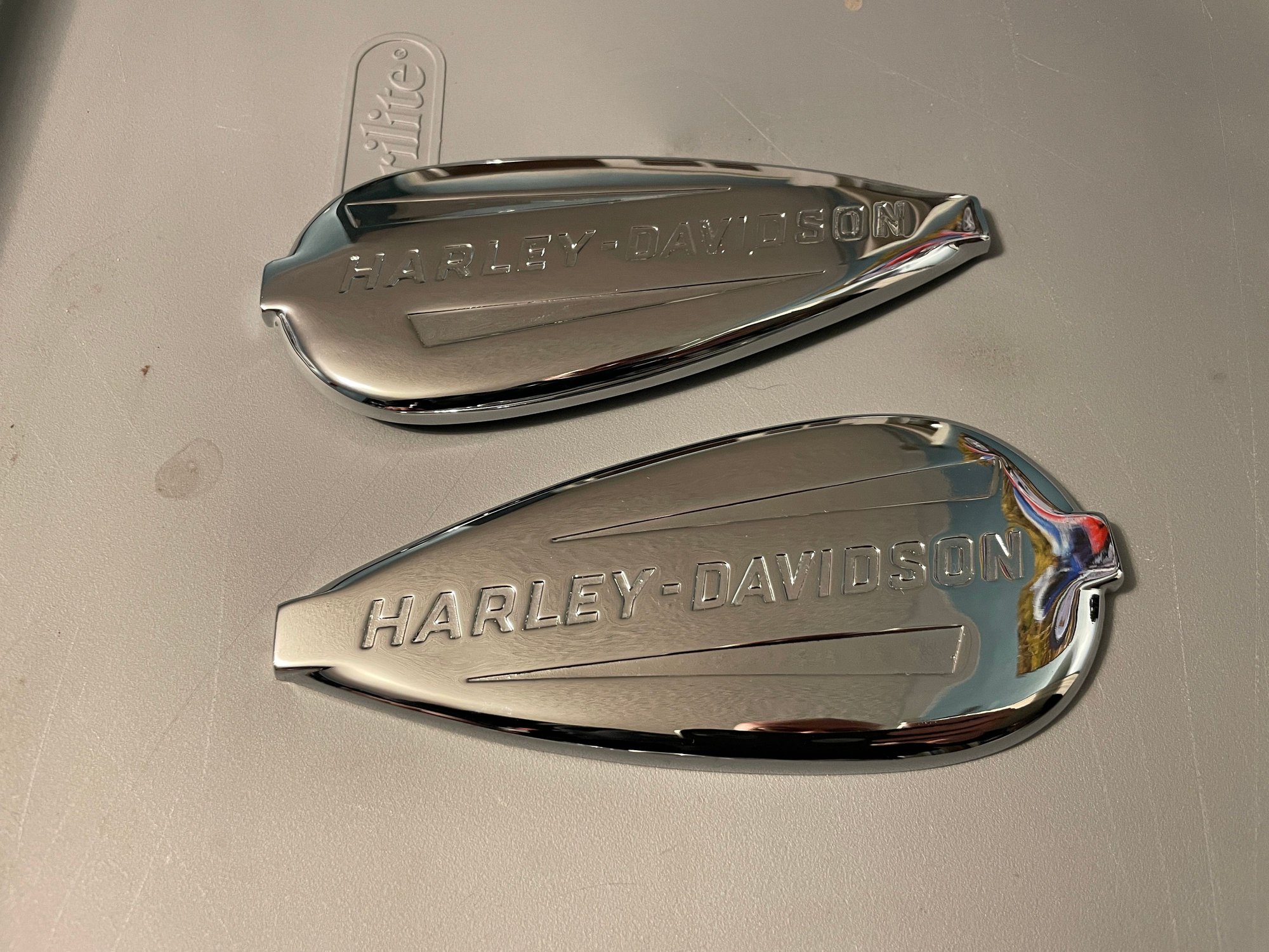

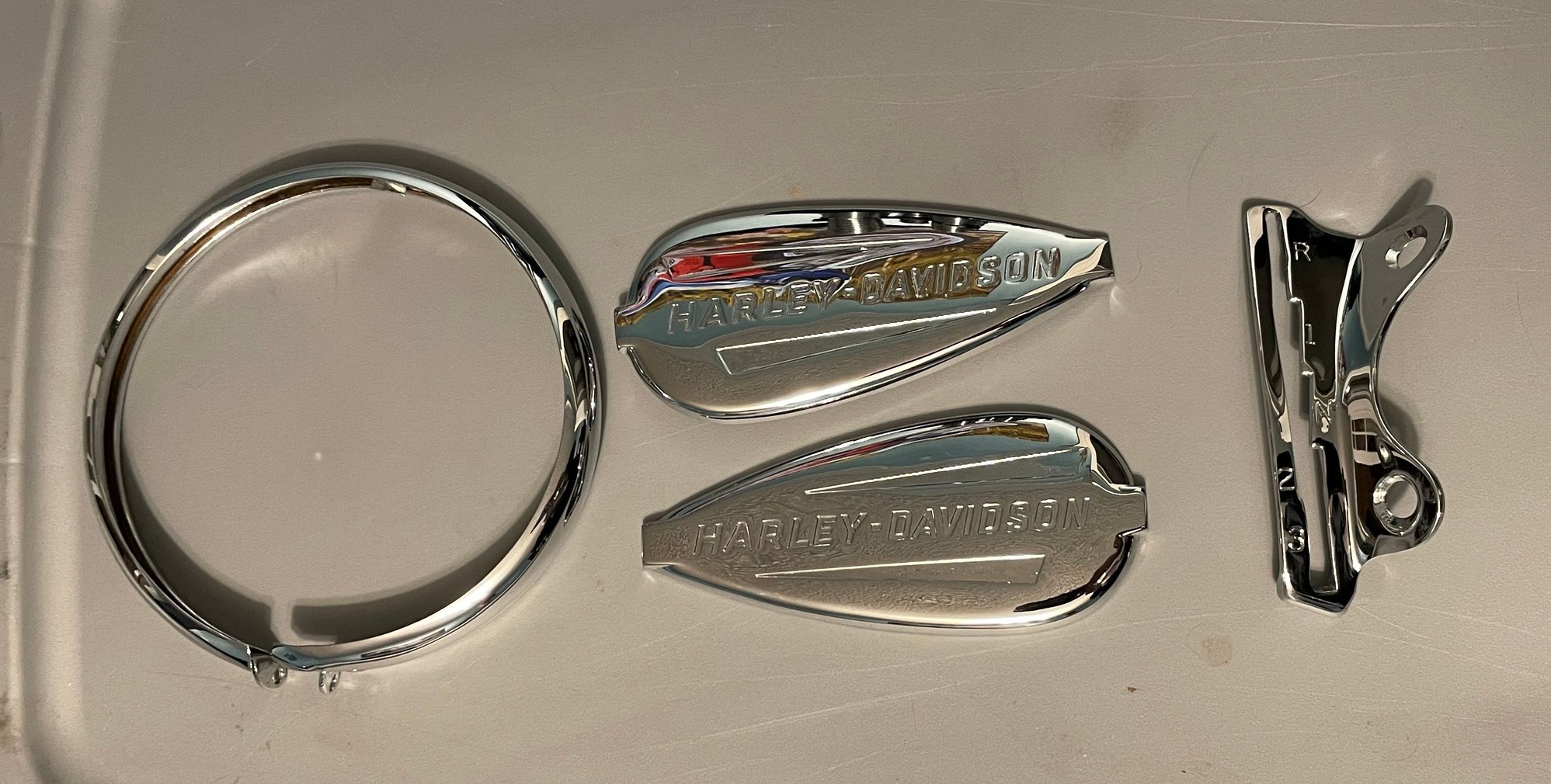

Got some chrome back today. The chrome guy I use is great, lucky to have one somewhat local.

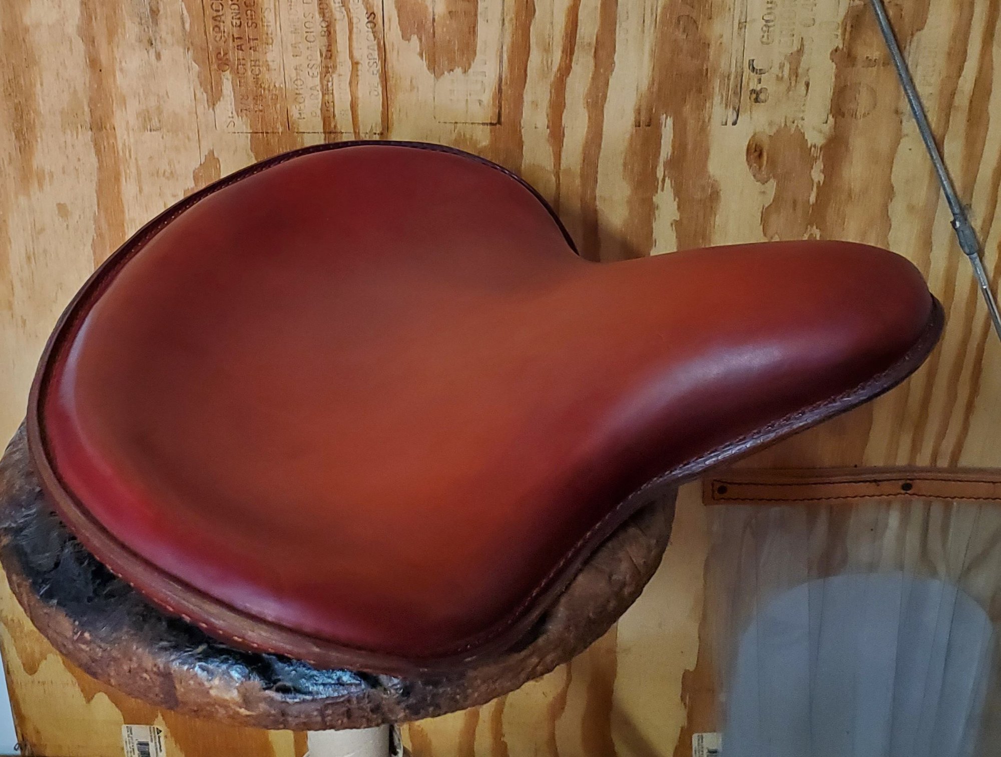

I had two options for the seat color from Heathers Leathers and I went with the darker one, just looks richer / better to me. Right or wrong compared to original I dont know.
