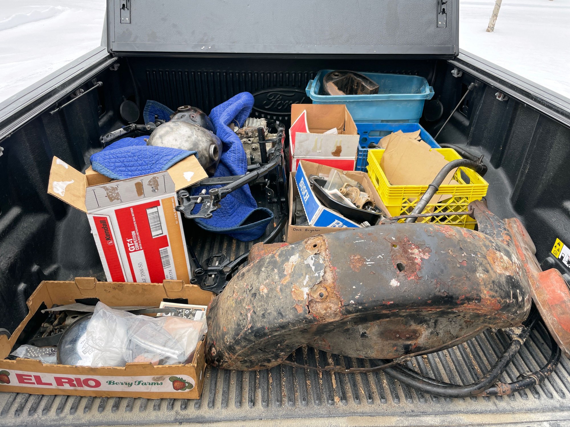

This bike was bought by the long term owner in 1961 and parked it in 1967 and now its in my garage. He still rides in his late 70's, bought it when he was 17 in Northern Ontario and rode it down to southern Ontario where he continues to live and ride.

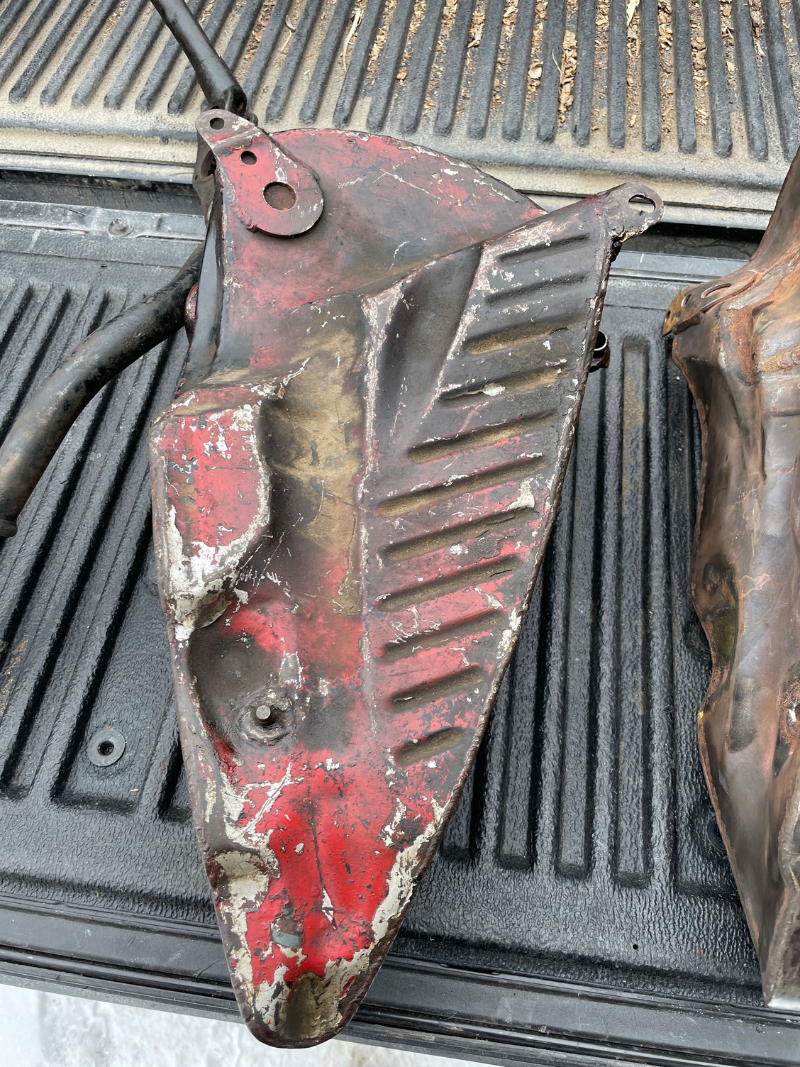

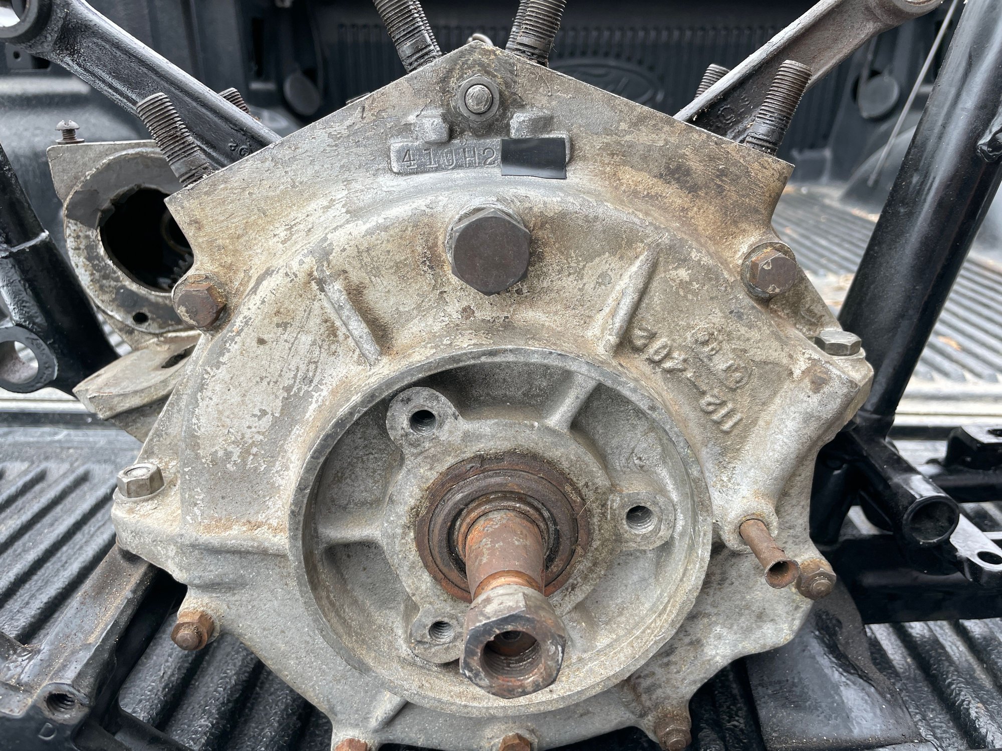

It was mocked up to give me something that looked like a motorcycle because he had taken it apart and painted the frame over 20 years ago, powder coated the springer front end including the springs. The original gearbox came with the bike but disassembled, belly numbers match, die numbers say late 41, gearbox date is for a 41 as well. correct foot boards, seat post, oil tank, dash, headlight etc. Proper hubs with the well around the grease nipple, rocker clutch is the right one. Barrels are 40 over, aluminum heads, the engine spins freely with no crack repairs.
Frame missed the chopper era and nothing has been cut off, has the right die numbers but cant find one on the steering neck yet. Based on close inspection I just cant see this neck not being original to the frame, I'll be blasting it next week with any luck and have a closer look. The front end is a 41 as well (in my opinion). The die number in Palmers book says 42, the bike is a late 41 so whats the cut off date for the die numbers from one year to the next? My 48 has a die number on the axle clip that isn't in his book, it falls into a gap between known die numbers but makes sense when you apply logic. I had him blast the forging to see the numbers hence the powder on it. Proper damper and ride control, springs, rockers etc.

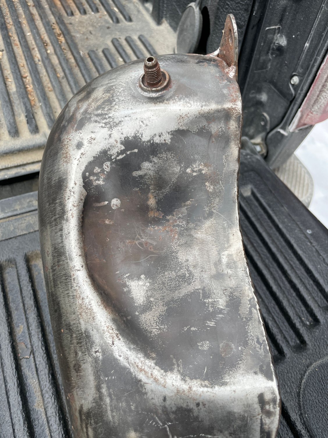

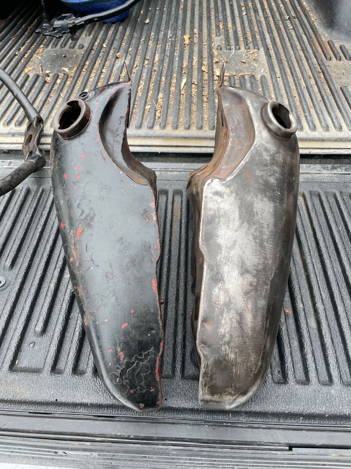

Correct headlight but no lens, correct tail light with 2 lenses, shifter, shift gate and screws, original primary. Fenders are absolutely trashed, the front not repairable in my opinion but I guess anything is possible. They both have the proper narrow braces thankfully. Tanks are correct flathead tanks and need some tlc, I'll blast them and have them coated inside. I don't imagine they are easy tanks to come by.
I forget what was said about the bars but they are different, they come up higher and wider Im told.
Production numbers I see on line say 126 UH models in 41 and its the last year of the 80". Im pretty happy!

Later 41 frames (which this is) had bolt on tool box brackets.
