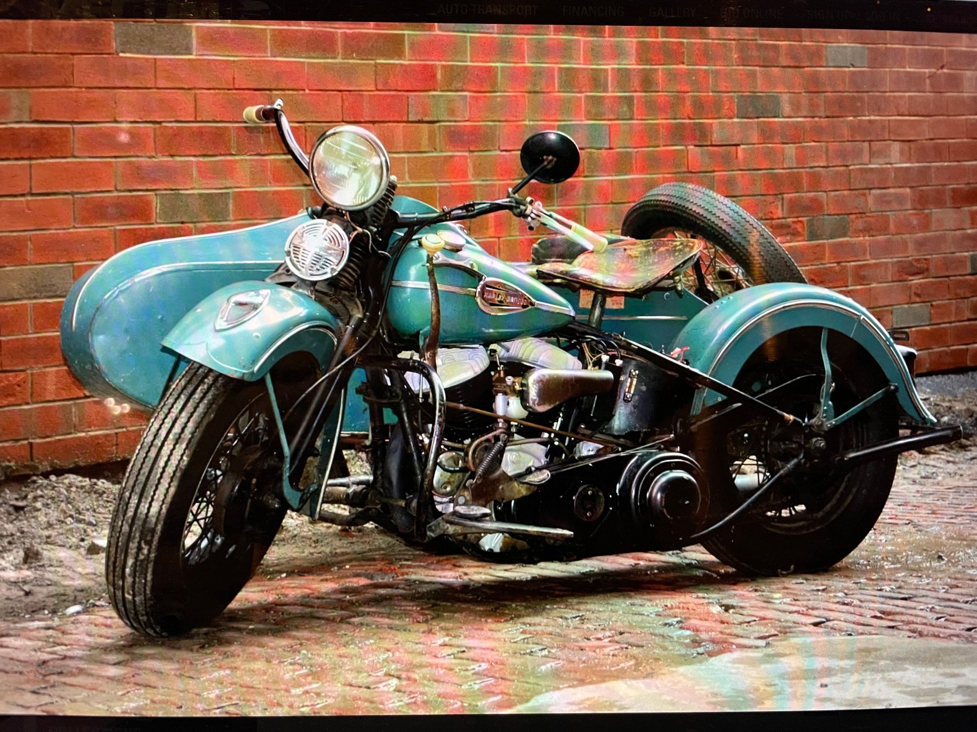

This one (a 1941) managed to survive with original paint and the optional 16" wheels. Does the sidecar prevent a wobble? No idea.

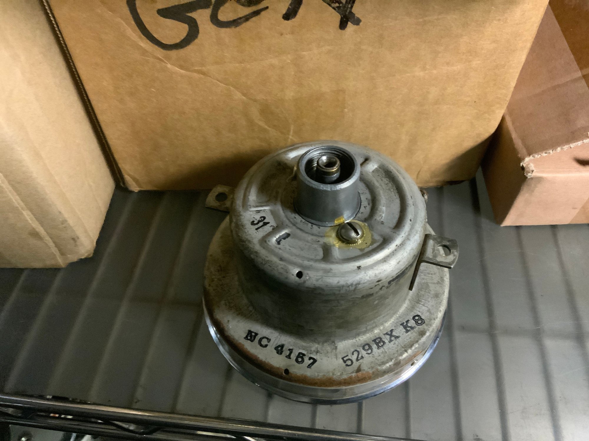

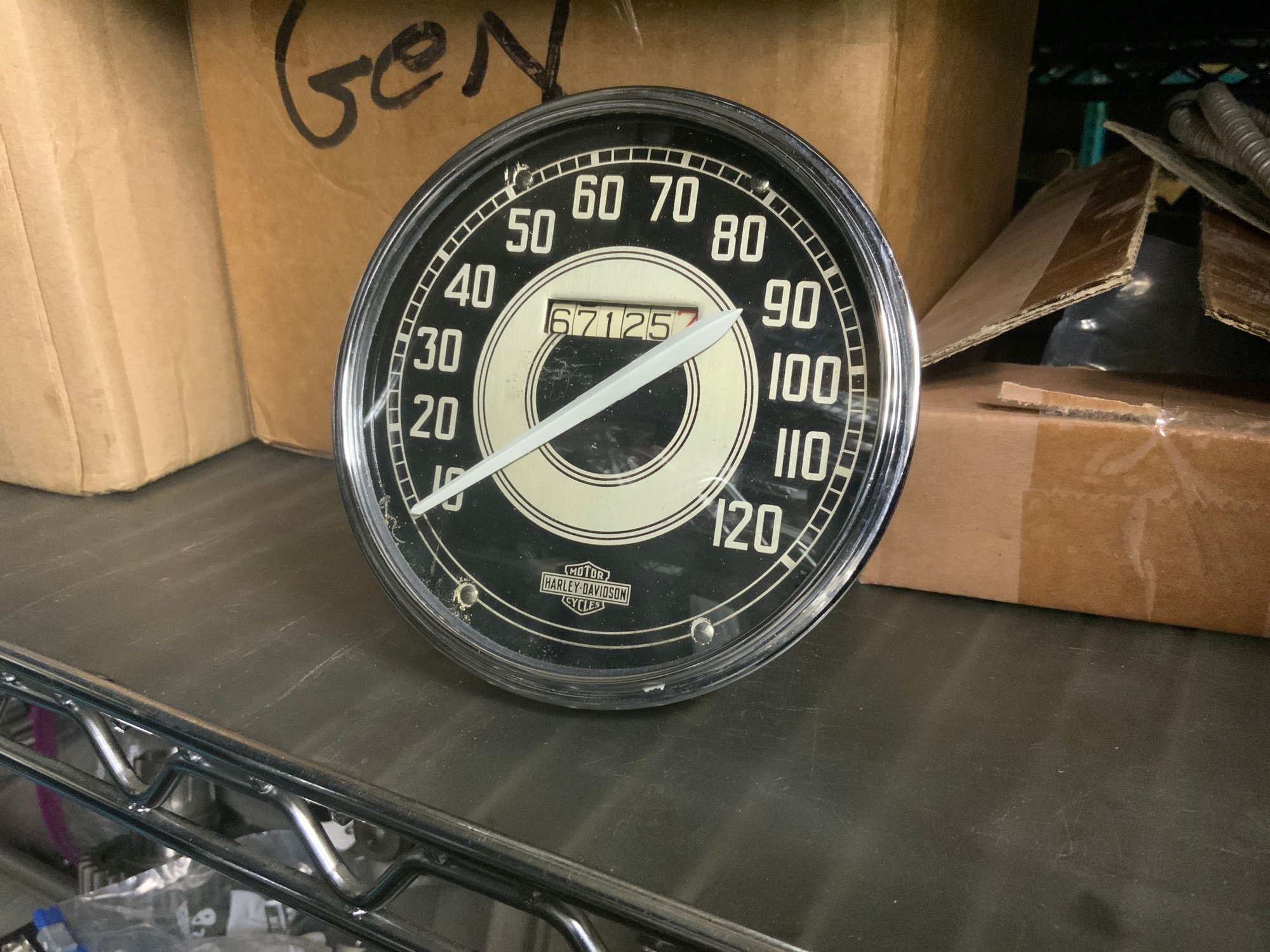

This speedo was found in a barn - way before this discussion and the farmer told the young guy who got it for me almost 7 years ago // the farmer when they ran out of gas offered some from the barn and they guys seen bike parts on shelves
he picked up the speedo and asked about it knowing i needed a 1940s unit - farmer said he had bought a new 1941 knucklehead and with in 1200 miles he crashed the **** out of it from a death wobble - so he stripped the bike to fix it and never did but in all the years sold off most of the parts and my guy bought the speedo 100 bucks
john boorish in Texas i sent him the speedo to go through it - he called me to inform me its was the best looking unit from that era he had ever seen - he changed the glass and the chrome ring and / re painted the needle - checked the speed timing oiled it and sent it back - couple hundred bucks
the machine i have is a utility FL the cheapest model that was available and it did not have a trip set in th speedo head - no one knows how many in 1941 they built in the bent frame era of 2600 machines that were affected - and dropped that model before the next series in Mid series 1941 were built - the speedo does not have a trip set - sure your going to find one of those - i put the original mileage that was on the title work from the 1960s i have for it for john to add to the unit
