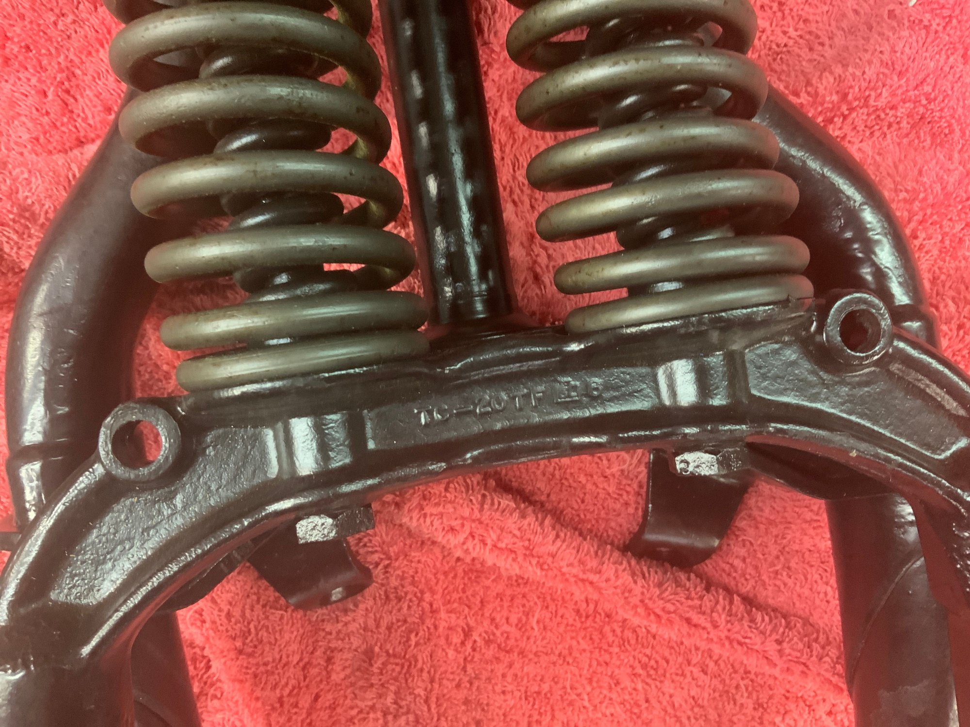

2 things i needed to see asked for one and you never posted - was trying to warn you when i did not see the bent frame and 16 inch wheels - but you were invested in a blue Twinkie and its matching riding apparel is my guess - the blue is sooooo against the back drop of snow - now back to our regular program

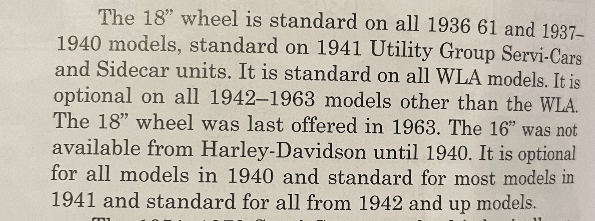

i could be incorrect on this BUT - i never thought the UL series had 16 inch wheels only 18 inch - i dont care what someone did other then what came from the motor company — up until 1940 they all had a 25 degree neck and 18 inch wheels that worked fine together with no head shake issues - no one talked about that shake issue till the 41 knucklehead with 16 inch wheels
the seat post top bracket shows the factory number stamping for the repair in the 50th one that was repaired

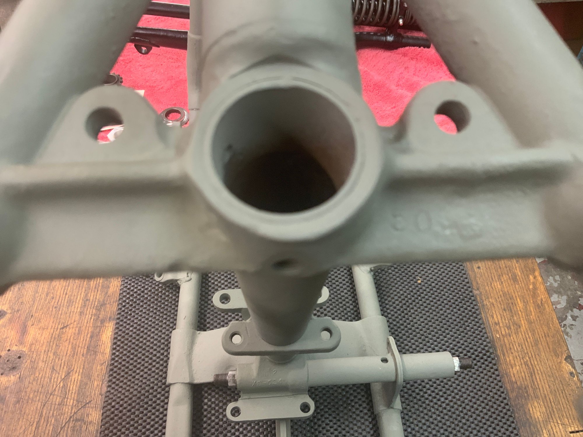

I answered your question despite most of my time being spent polishing my RK. You wanted to know what the forging and die numbers were on the neck. If you get out your magnifying glass, look a few posts back you'll see where I said........
THE NECK HAS NO NUMBERS ON IT.
I'll read more on wheels tonight, if the UH had 18's that solves my problem. Thank you

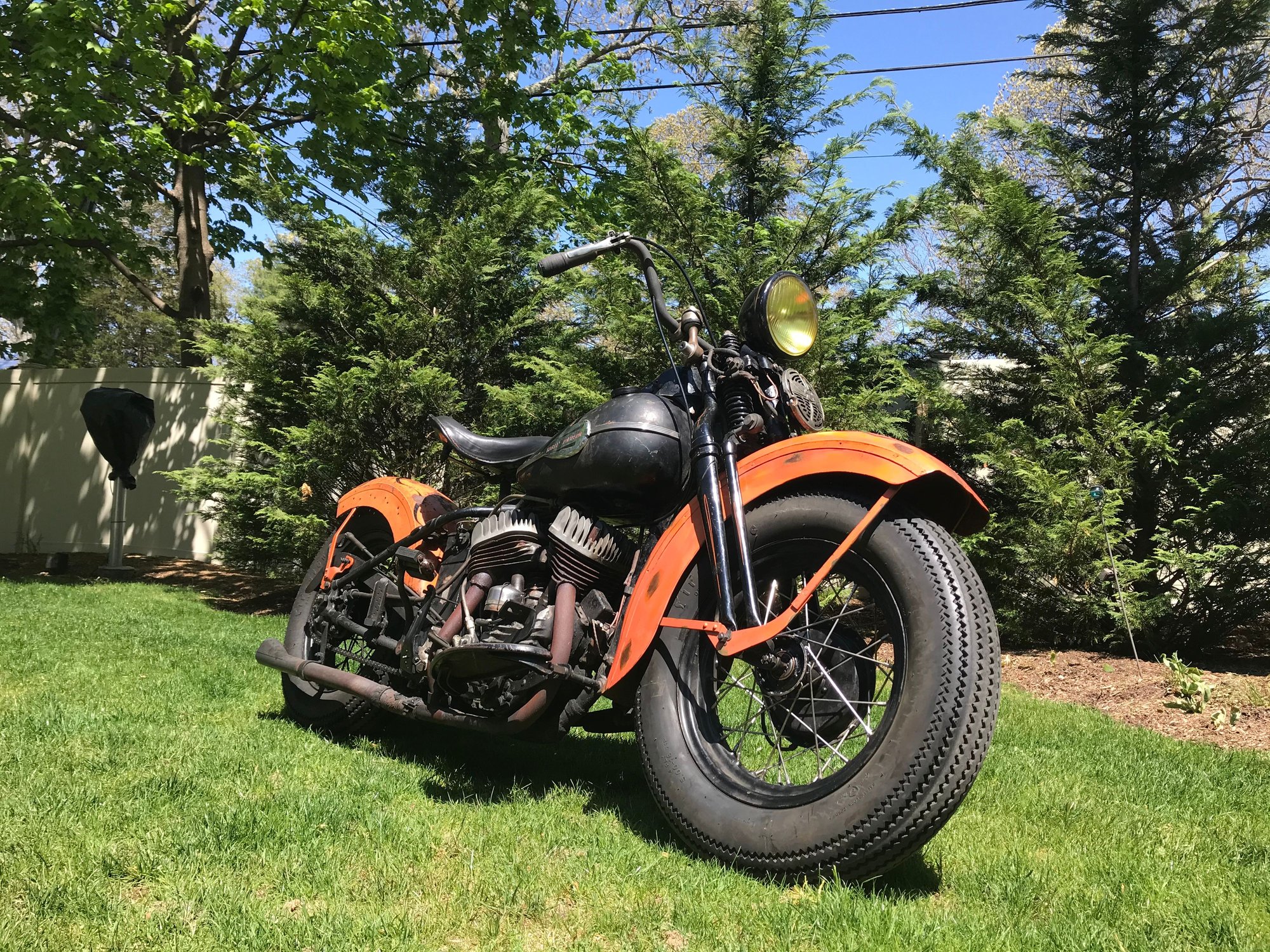

Not the best picture, but one year only 1940 WL front wheel old style "squared off" front brake drum with 16" rim. 1939 was the same drum with a 18" rim, 1941 was new newer style rounded drum with 16" wheel. Obviously I am talking civilian, WLA had the newer drum with 18" wheels front and back. So confusing!??!?!?!?!??!?!?!
