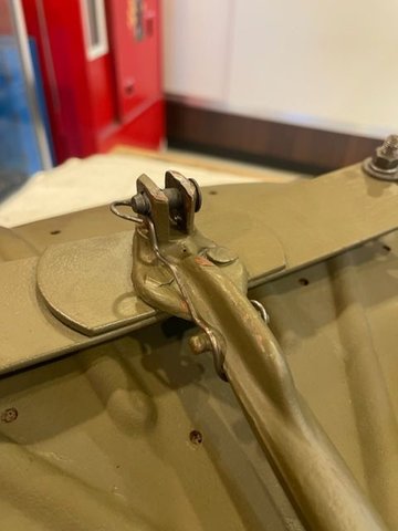

Old Jun 13, 2022 | 01:14 PM
Architect's Avatar
Architect
Joined: Apr 2010
Posts: 9,562
Likes: 7,915
From: Long Island, New York
Hmmm, me thinks you r seat bas has been altered at the pivot point.

Old Jun 13, 2022 | 03:45 PM
Architect's Avatar
Architect
Joined: Apr 2010
Posts: 9,562
Likes: 7,915
Scott, look at my picture, your pivot point (location for the pin to the pogo) is in the wrong location. Should be to the front of the bike, not to the rear. I think someone modified your seat T.
