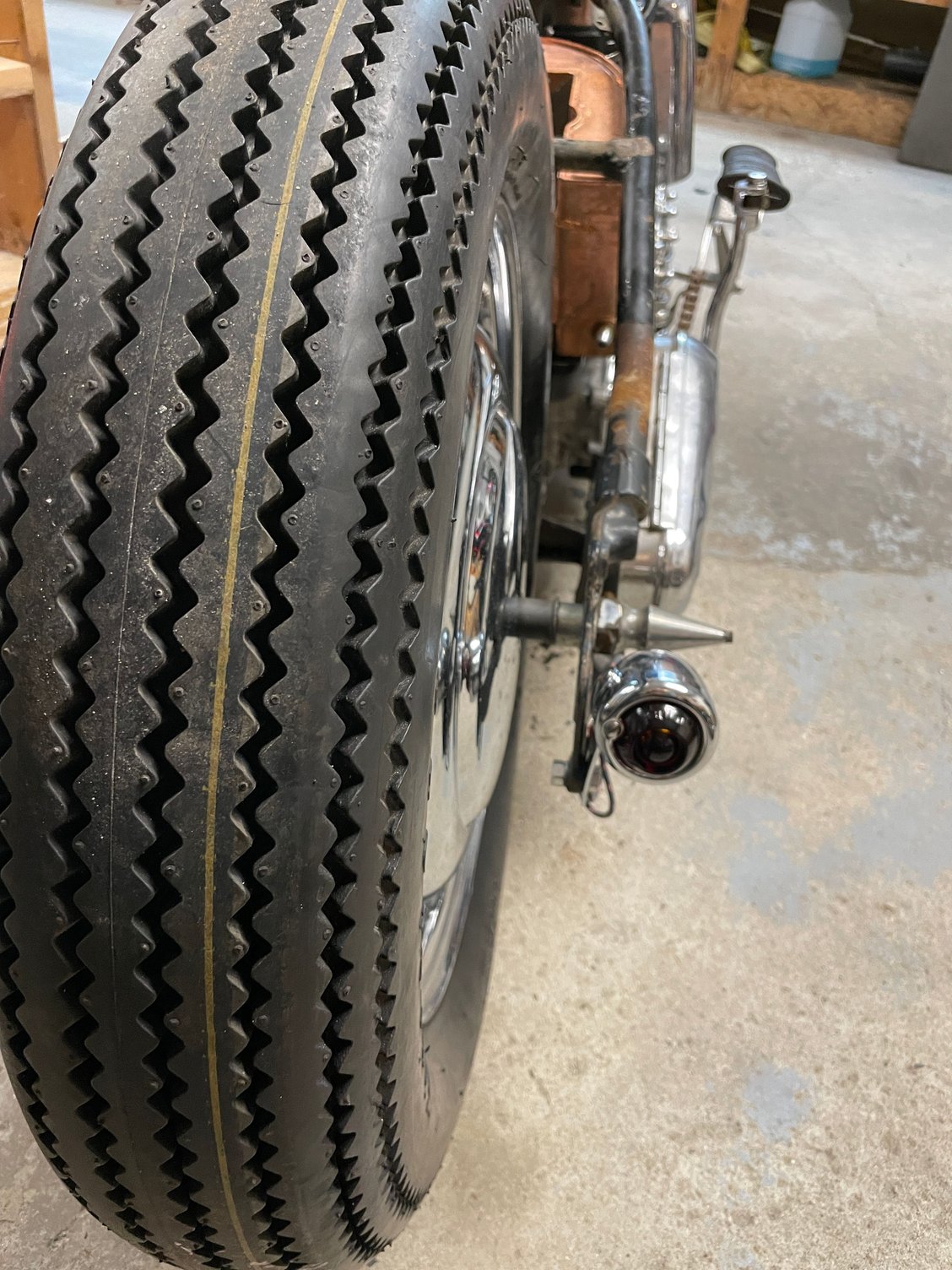

5.00-16 is what I run and if you run a wider one the issue then becomes the ability to fit it in between the drum and frame when you squeeze the wheel in or out. My 5.00-16 firestone champion required a bit of a push to get it past the drum and frame when I put it on the bike. Wider and you'll need to take the drum and backing plate out with the wheel. The room to the right of the wheel is so you can move it to the side and get past the drum.

That’s a good looking tire, how much clearance to the chain ?

I put a straight edge across the tire and there is a little more than a 1/2" to the sprocket so without shimming the sprocket on the drum you could go with a 6" tire technically but then you would have to install the wheel with the drum and backing plate as an assembly - no big deal if it means you get a fat bun on the back. That said when I was putting a 180 on a bike with a juice brake I had to shim the sprocket away from the drum 1/4" and not all 180 tires were the same width! Enough that one would interfere with the chain and another would just clear. I had a 1/4" ring laser cut for me that went between the drum and rear sprocket then ran an offset trans plate etc.

One more detail about the 180 tire. I laced a mid-star hub to a 5" road king classic rim and ran the wide tire on a tubular swing arm / drum brake combo and had to do the drum / wheel install as an assembly.
