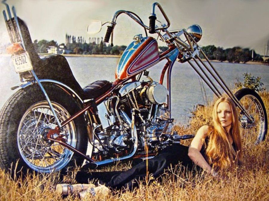

I get that you want what you want but a fat tire looks out of place on a rigid bike thats trying to be a vintage build. You cant get a fat vintage tire unless you go (gasp) with a car tire like some of the Japanese builds do. Ive seen them with Hoosiers on the back which means they went to a 15" rim to make it work and a drag slick is less than ideal (but they do look cool)
The newer fad builds did the fat look and it didn't age well. The wider the rear tire the worse it'll steer because it'll want to stay upright like a twinkie fatboy - one of the worst bikes I've ever ridden only to be outdone by a CVO V-Rod.
