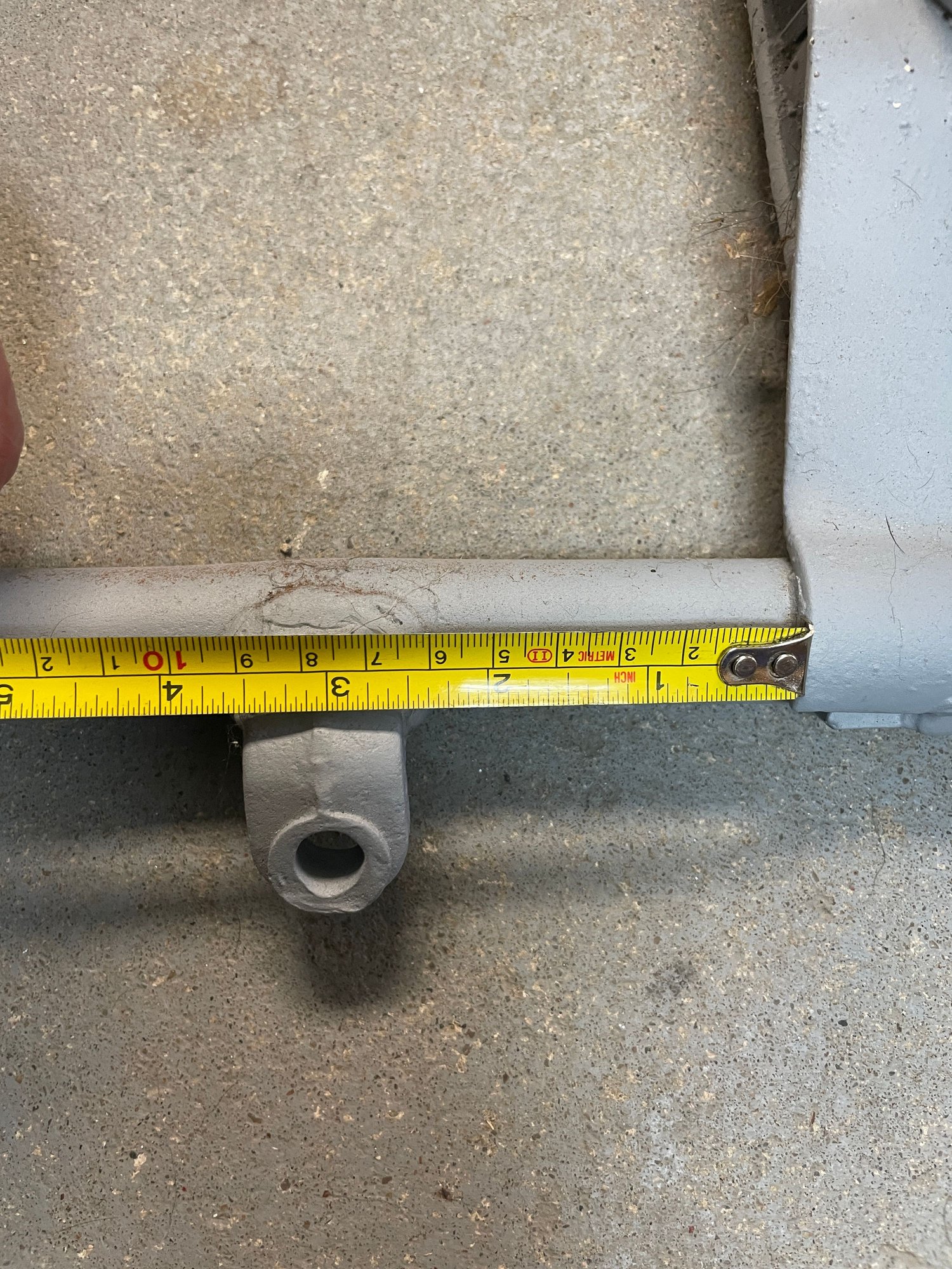

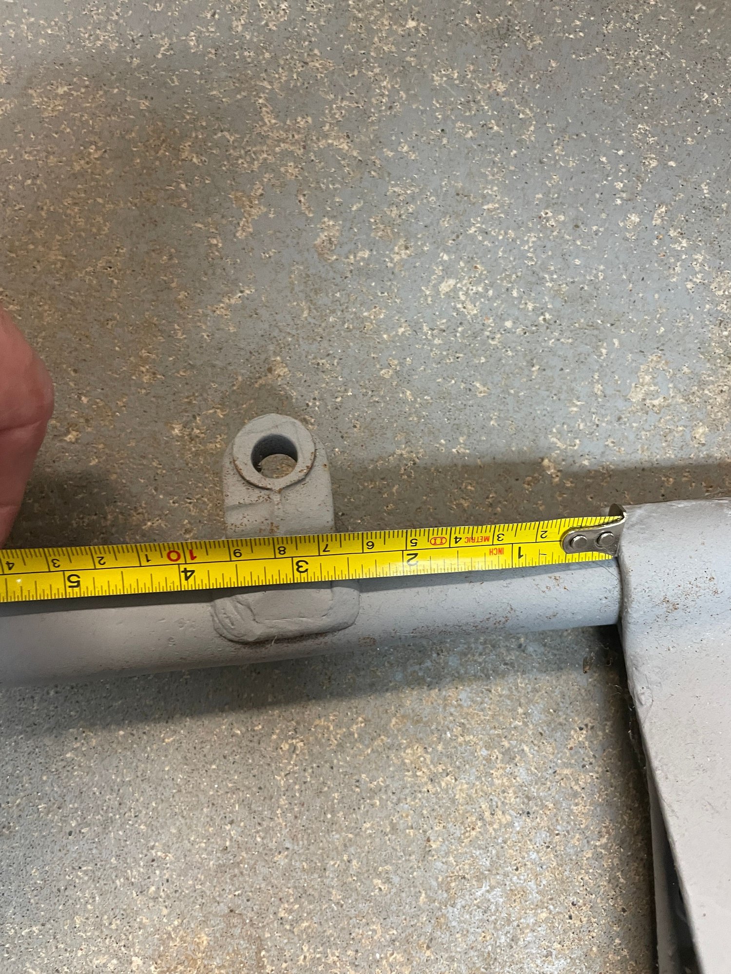

Theres a bare 41 UH frame in my thread below yours. It's still bare and in my garage so I can measure if you like.

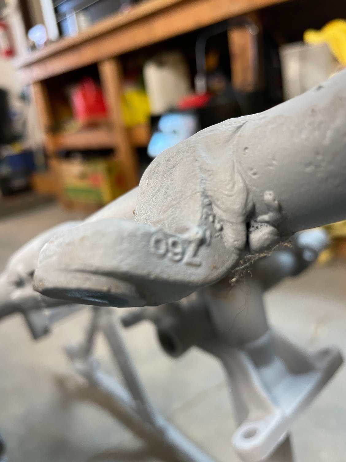

Call me lucky, I measured 4 frames I have and they're all the same. Die numbers still visible too and not been off or moved around. This is a virgin 41 frame.
How about a picture of each side fairly close up, I’m just trying to get an idea of what stock looks like.

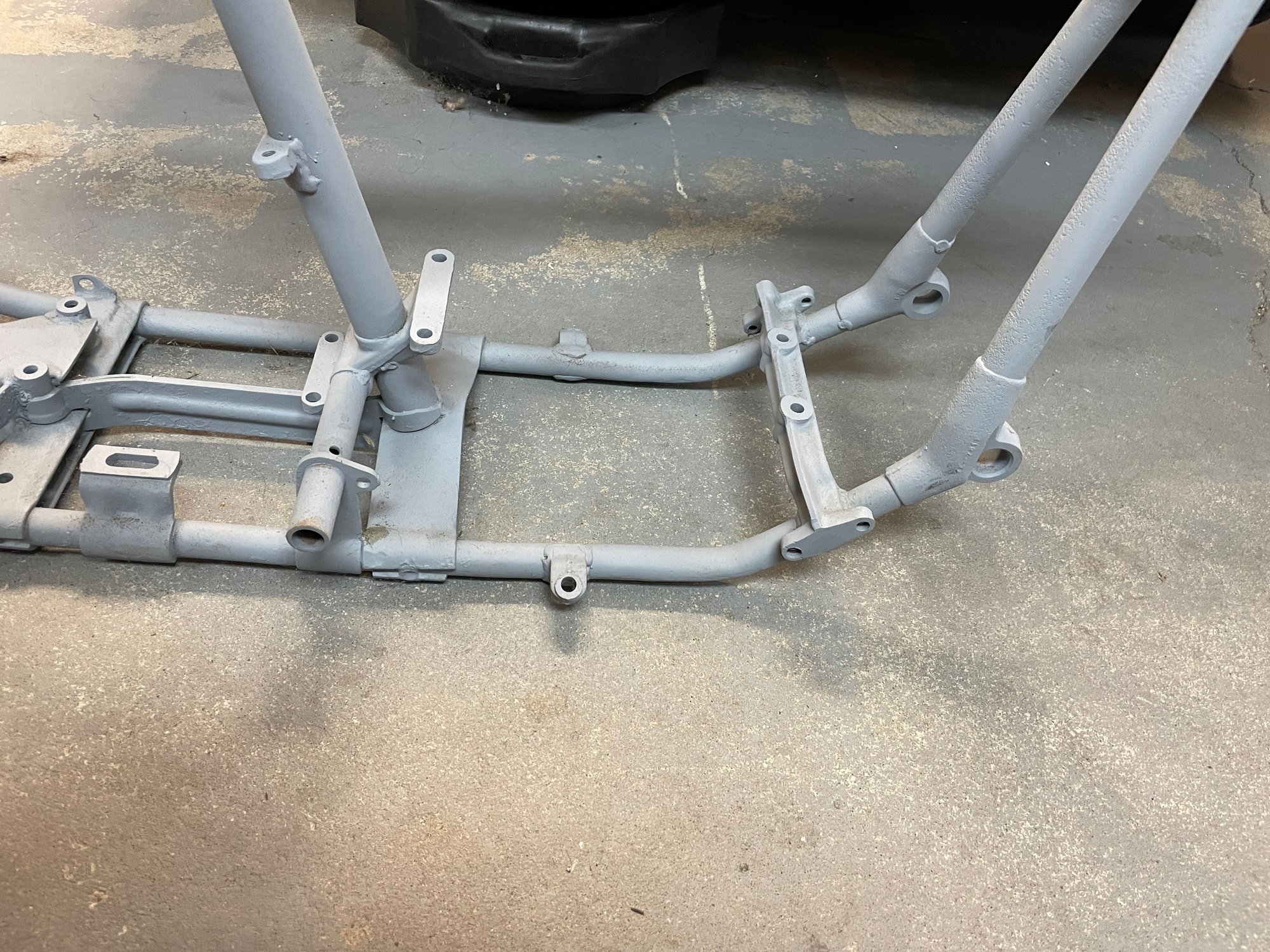

You'll have to figure out the angle they're installed at and they're different left to right, the board mount brackets are angled differently too so they clear the engine cover and primary cover.
Sorry I didn’t see these pictures at first, that’s exactly what I needed, I have those tabs.
When you have a chance how about a pic of each side of the frame not so close maybe 2 foot back.
