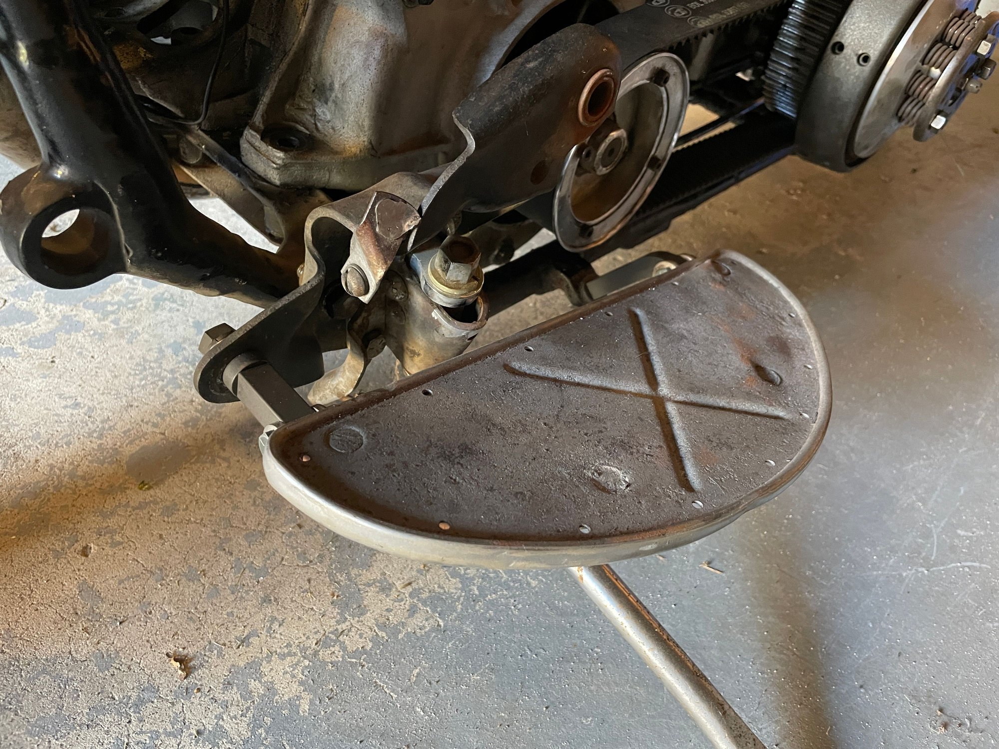

So I see the two tabs you measured, what do the front of the foot boards mount to ?

The left front mount attaches to the kick stand bracket that bolts to the front mount forging. The right one bolts to the rear brake pedal mount bracket that bolts to the engine mount forging.
Old Oct 30, 2022 | 09:43 AM
hellonewman's Avatar
hellonewman
Joined: Jun 2015
Posts: 8,055
Likes: 8,080
From: Canada
My 57 with a juice brake mount bracket but you get the idea. Its what I had in the bin when I mocked the bike up.

If you added a front crash bar the lower mounts would attach to the front board mount stud.
Old Oct 30, 2022 | 10:00 AM
The Turk's Avatar
The Turk
Joined: Jul 2022
Posts: 62
Likes: 14
From: California
Thanks that’s exactly what I needed to know.
I’m going to be running a “juice” back brake and those same foot boards with no crash bar so I need to buy the brake
bracket and kickstand bracket.

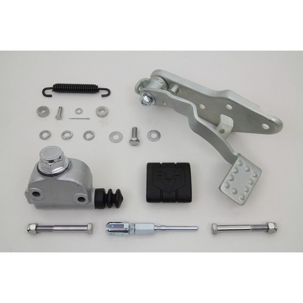

I found this repop brake mount online it looks like what I think I need, do you think that stock master cylinder is close enough to
the correct size for a two piston disc caliper ? Sacrilege I know.
Old Oct 30, 2022 | 02:37 PM
hellonewman
Joined: Jun 2015
Posts: 8,055
Likes: 8,080
From: Canada
I dont think you'll find its ideal, you'll get too much travel in the pedal is my guess.
